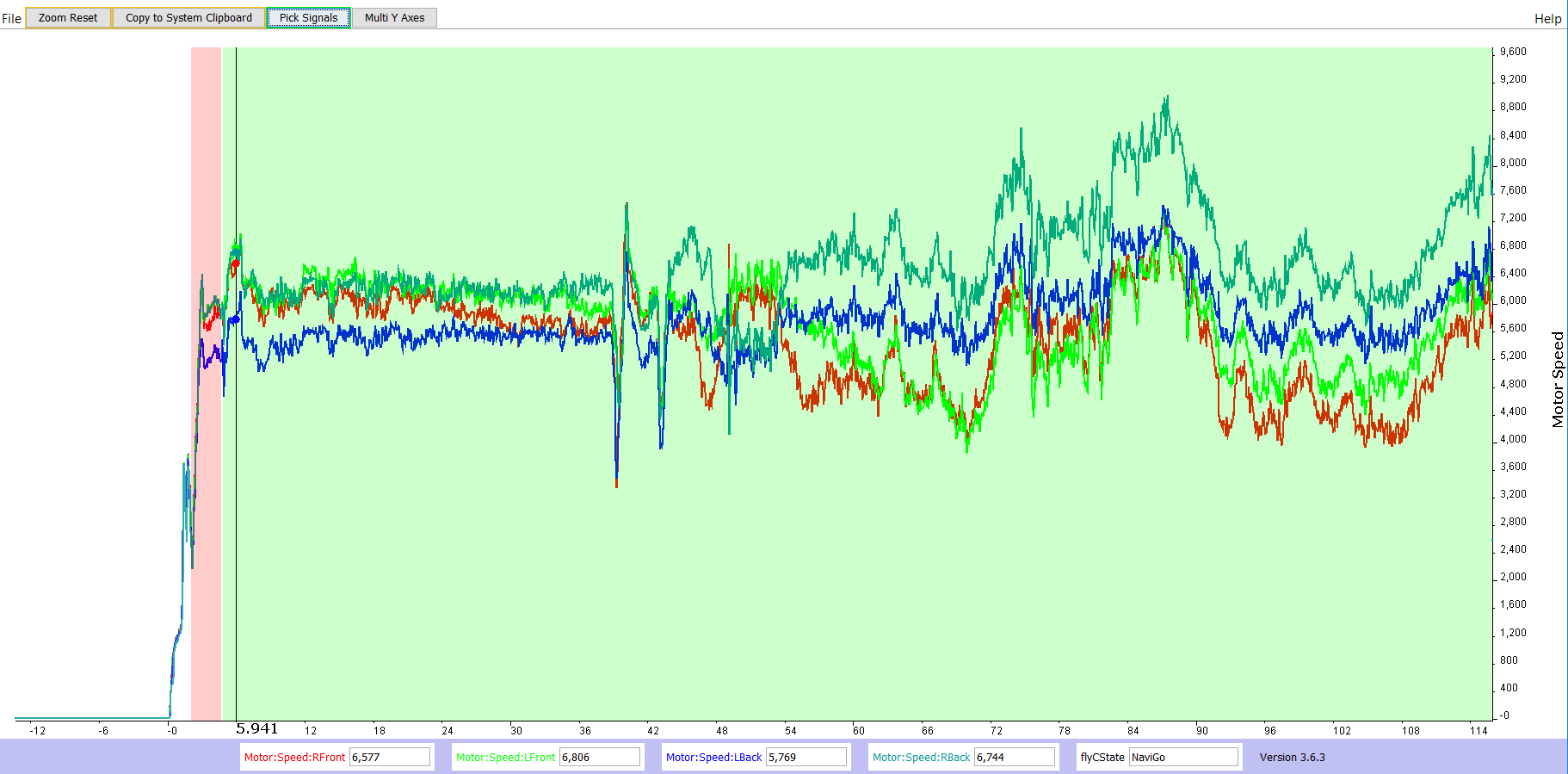

The simple answer is no. All 4 motors spin at varying rates. Initially on takeoff, in a perfect world condition, which is basically impossible to achieve, all 4 motors, when at idle would spin at the exact same speed. In calculations from the IMU and the FC, the aircraft tries to perfectly level itself before takeoff, which being on the ground eliminates the weight bearing factor. After takeoff, it is the same thing, the aircraft attempts to level itself at hover. This is not 100% effective, hence the difference in the motor RPM's. The weight has little to no bearing on any of the motor's. This is by design that the rear motors do tend to be a little faster. But not always so in flight. A normal takeoff is exampled below:

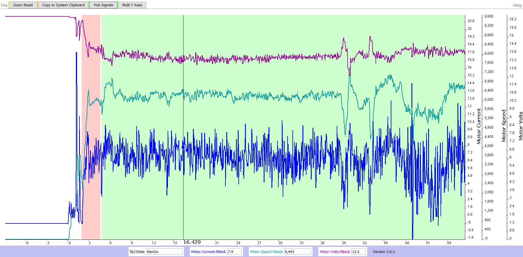

Close, but just using the right rear as an example during hover, you are looking at an estimated average of around 100 Watts or there abouts.
Reactions: 3rdof5
Close, but just using the right rear as an example during hover, you are looking at an estimated average of around 100 Watts or there abouts.View attachment 105609
