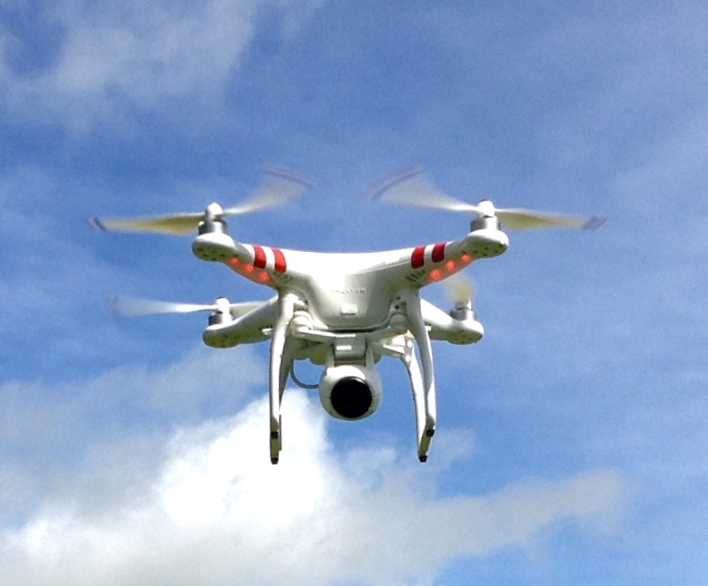

I just went out and took a spin and the red lights stay on Pascoe on the front when all is good .Solid red lights
like this
