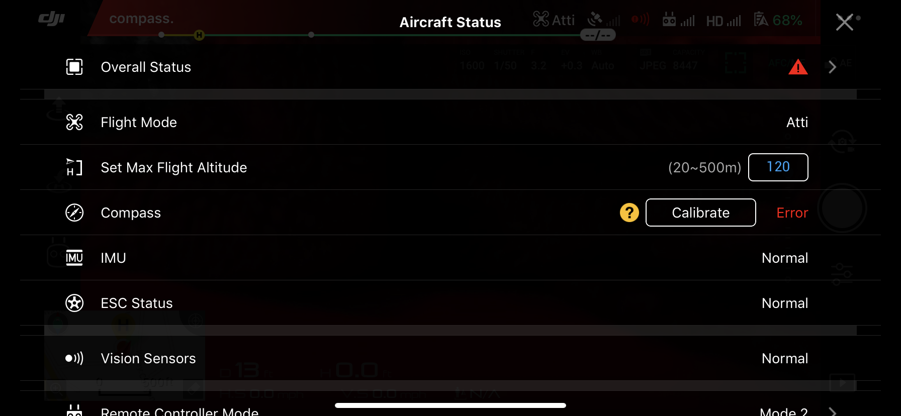

Hi yes I have checked everything and it’s all good compass is normal. But I did notice something yesterday that the compass 2 gave an error and to calibrate but when I went back to do it it showed up as good no issues ? And in the app it showed normal. But every once in while I’ll check and I’ll get that compass error. I have not tried calibration because idk how to start it without waiting to see that error (hopefully that makes sense). I just got this drone yesterday I do want to say that. And the only reason I saw the compass error is because I went in to the setting and sensors and that’s where it showed me the compass 2 error.

You are experiencing very similar issues as many V2.0 owners. Its quite unlikely that exchanging the drone would yield better results. Maybe DJI will give us new FW, but until then, the false compass errors and yaw drift are here to stay, it seems.

Hi just wanted to update, I just reset the software on both drone and remote and reinstalled it. Noticed the the wobble is gone expect when coming down for a landing it wobbles a bit and the drifting seems to have stopped. But did notice a couple things my remote shows for radio channel quality shows poor. And I did notice this yesterday not sure if it’s normal or not but I’ll show you the props seem to be off could this be causing my issues ?

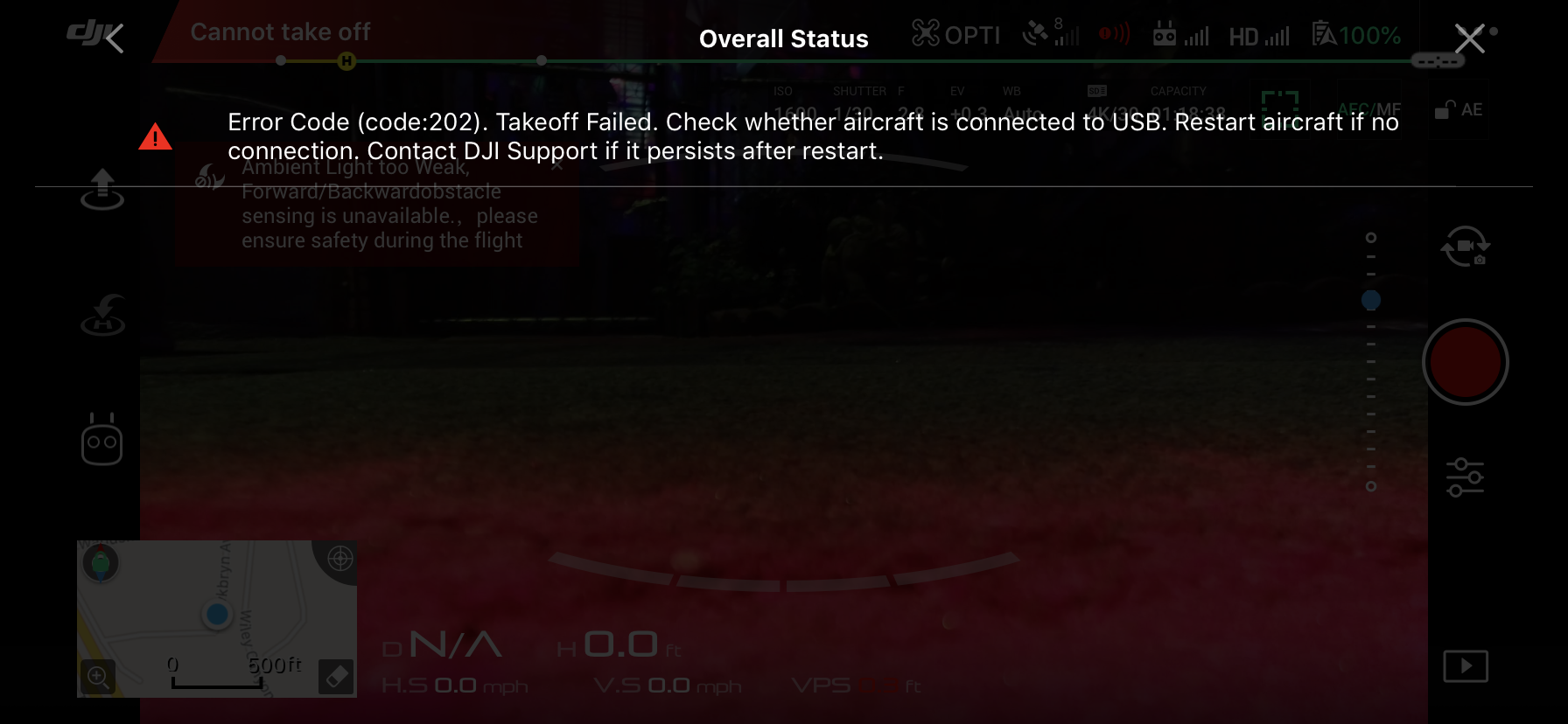

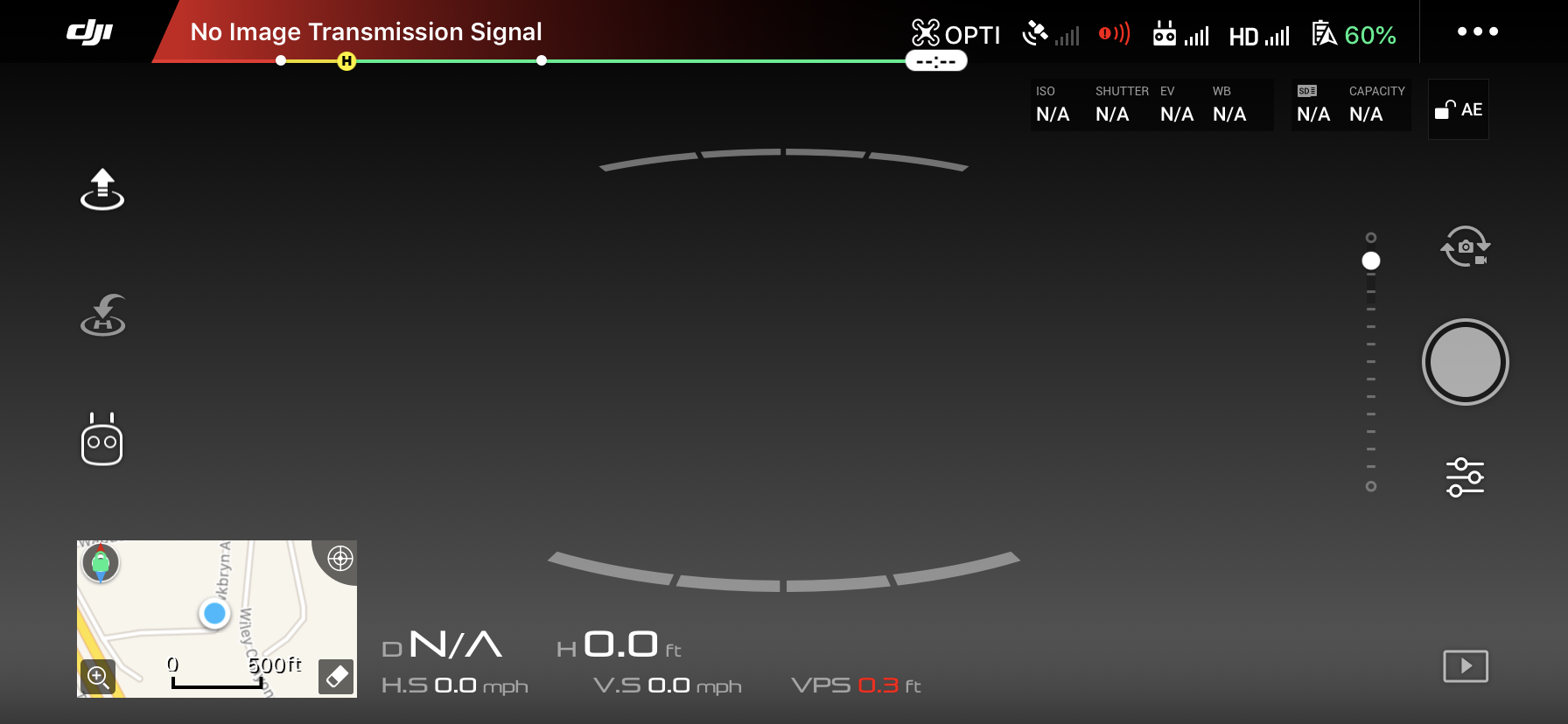

Hi sadly now I’m having issues with the camera :( the images and videos from the camera are blurry and seem out of focus I’ve been trying to fix it but even tapping the auto focus won’t work :/
I hope Best Buy will let me exchange it :c
As well as errors and transmission lose
This is my 2nd phantom so far :/
With the image transmission lose the drone was literally 40 feet away. I’ve tried re installing new software and nothing has helped with the camera or image transmission lose and errors I’m getting. Aswell as that horrible compass error has made a return :/

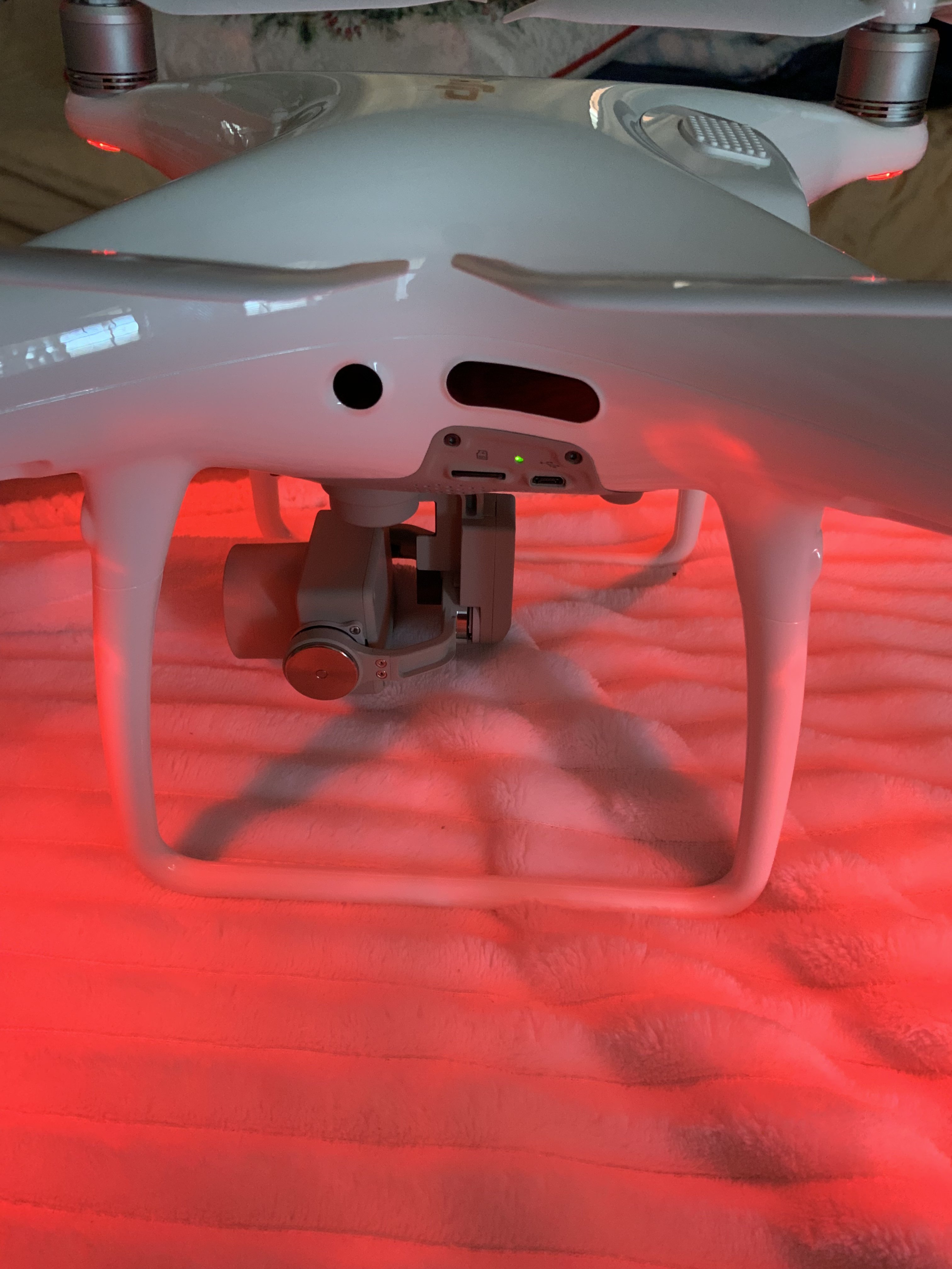

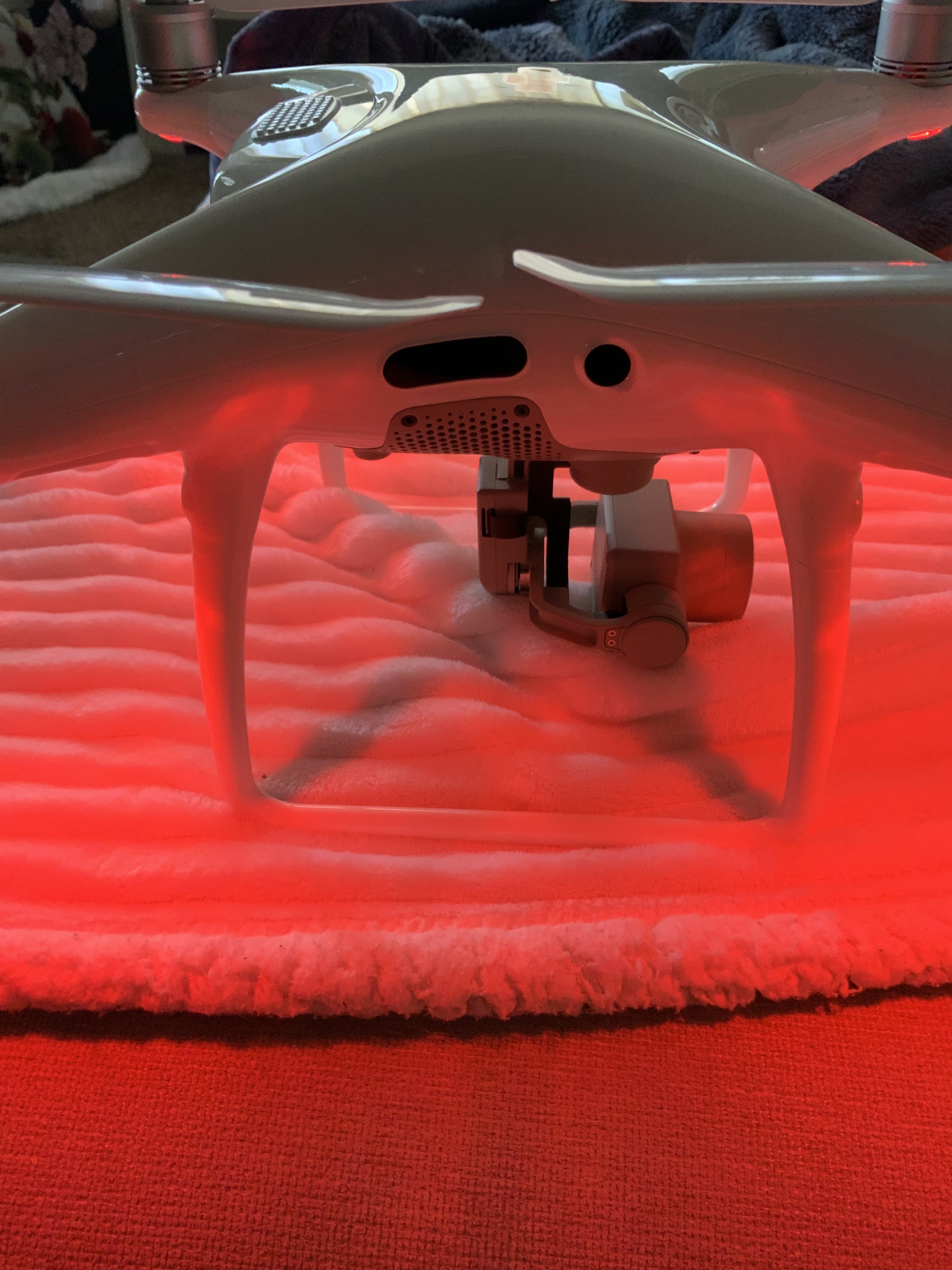

Yes I did get another v2
I’m pretty disappointed not sure if I should get another plus this one seemed used cause when I opened it
Someone’s memory card was inside it still
