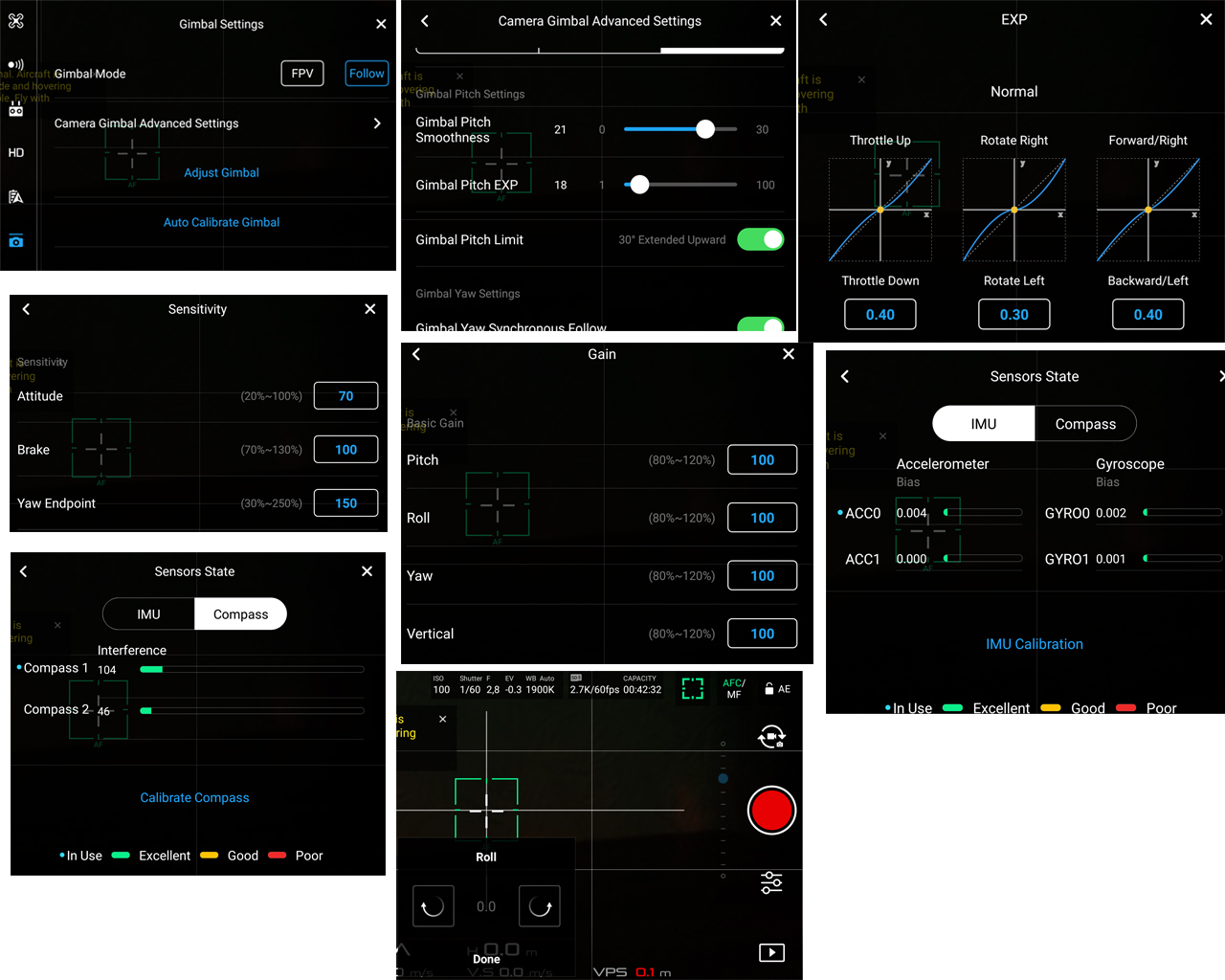

The problem with the level of the horizon in the new drone DJI Phantom 4 Advanced. Copter without damage and falls, there were only a few flights. When the Copter is tilted to the side, the gimbal does not align the horizon, the horizon at an angle. When the Copter is returned to the horizontal position, horizon remains under the knob in which it was when the Copter was tilted. What could be the problem? Also noticed that from the first flights the horizon in the videos is a little behind on the right side. And about the noise in the gimbal. when the copter is tilted to the side, the gimbal is emitted into a grinding noise. and the second moment with the noise in the gimbal - when turn on the copter at the end, the gimbal a little moves up and down in an unplanned manner and the sound sounds like something is jamming. Should there be any sounds in the gimbal similar to grinding or jamming in a working copter?
Here in the video you can see the problem
dji go 4.2.14
aircaft firmware 01.00.0128
tried to solve the problem with calibrations, but nothing helped.
Auto Calibrate Gimbal
IMU Calibration
Calibrate Compass
It seems to me, that deviations are too big, but maybe could help following steps:
General Settings - Gimbal Settings - Gimbal Mode: Follow
then Gimbal Settings - Adjust Gimbal: Roll and Yaw axis adjust as needed
