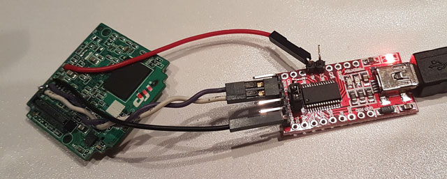

Hi quaddamage, i'm in...
...and nothing happens in Putty.
So i think i am in that condition:
2. Nothing happens. Still only cursor on screen.
In this case we can't be sure whether the DM36x doesn't print anything (which indicates bootloader damage), or your serial connection is broken somehow.
Your setup, you need to test by yourself. Maybe RX and TX wires are switched? Maybe your USB-to-TTL just doesn't work? If there's no apparent issue, you can just assume it's bootloader damage. While fixing it, you will have another opportunity to test the serial setup.

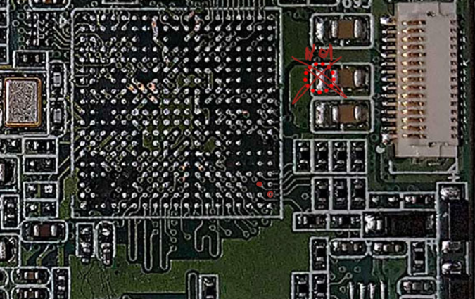

Please quaddamage, can you confirm i have to solder 3.3V to the red circle in this picture?
thank you
Reactions: IgorD2
NO! Don't solder 3.3V to that capacitor!
Who gave you that idea!? that's clearly a power rail.
You have 3 capacitors there. Below, there is a row of 4 resistors. And below that, is a row of 3 resistors.
You probably need to solder 3.3V to the middle resistor of these 3. Or left and middle.
These resistors are clearly a pull down resistors, meaning they are connected to the chips BTSEL on one side, and to GND on the other side. Make sure you're not shorting 3.3V to the ground - solder it on proper side. Measure resistance to ground to check which side is proper.

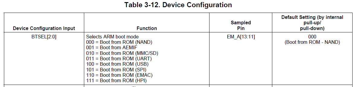

Explanation:
In documentation which you can download from Texas Instruments, titled: "TMS320DM365 Digital Media System-on-Chip (DMSoC)", there's boot modes explanation, ie:
• If BTSEL[2:0] = 001 - Asynchronous EMIF boot mode [...]
• The RBL (boot loader stored internally in the chip) supports 7 distinct boot modes:
– BTSEL[2:0] = 000 - NAND Boot mode
– BTSEL[2:0] = 010 - MMC0/SD0 Boot mode
– BTSEL[2:0] = 011 - UART0 Boot mode
– BTSEL[2:0] = 100 - USB Boot mode
– BTSEL[2:0] = 101 - SPI0 Boot mode
– BTSEL[2:0] = 110 - EMAC Boot mode
– BTSEL[2:0] = 111 - HPI Boot mode
So normally the chip boots from NAND - meaning we can assume all BTSEL pins are pulled down to ground through resistors (mode BTSEL[2:0] = 000 from the documentation). To enter serial (UART) boot mode and be able to flash the bootloader, we need to change that to BTSEL[2:0] = 011. So we need to change two bits to logical "1" - which is 3.3V.

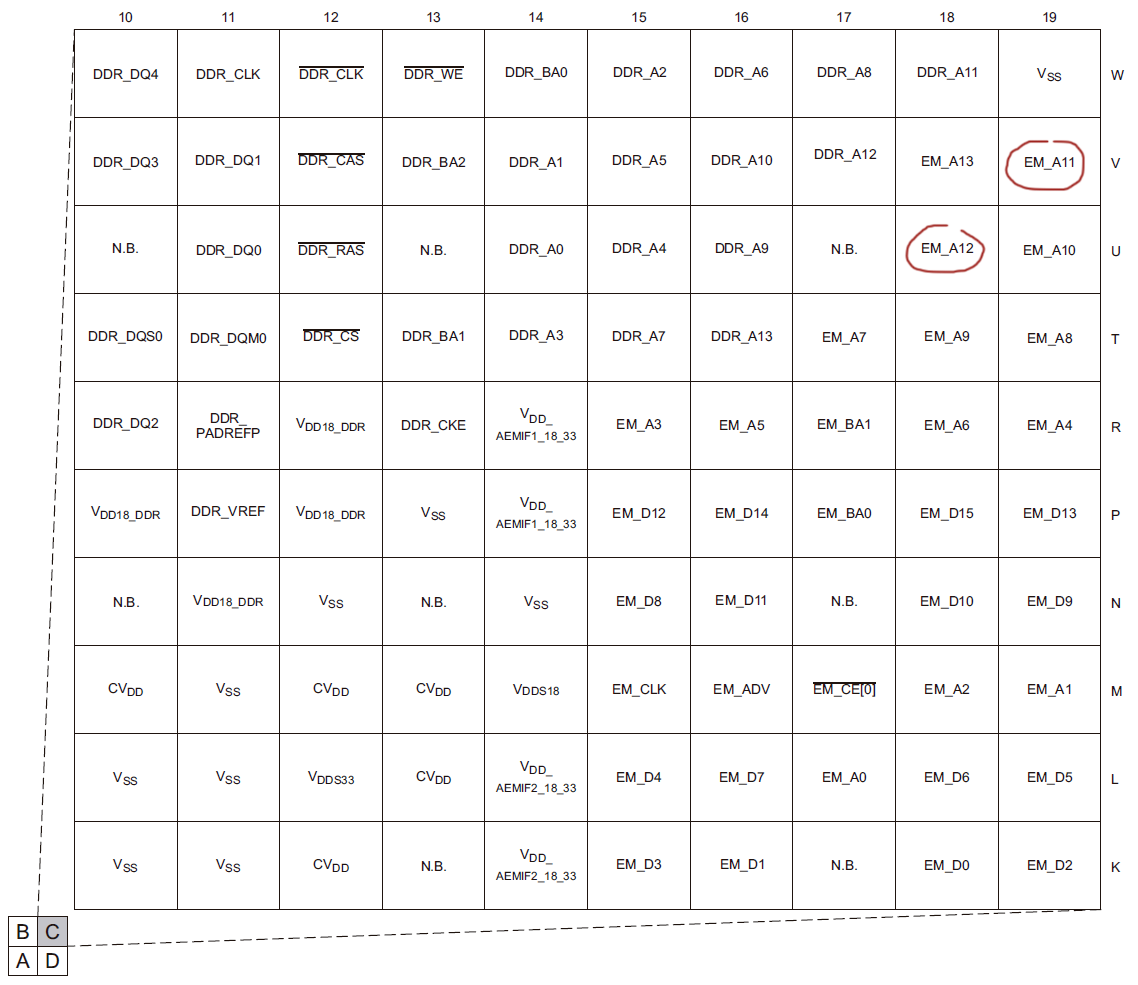

Now, where are those connections on the image of the chip? The TI documentation states that too:
So as you see, the logical value of BTSEL is taken from pins/pads named EM_A[13:11]. We are interested in EM_A[12] and EM_A[11] only. And here is where they are on the footprint:
The image is explained as "Pin Map (Bottom View)" - which means it needs to be flipped to match the footprint on the photo. The board photo you pasted has pin 1 marked in top left, and if we flip the image around horizonal line, we will get the same orientation. Our culpit pads are:
It looks to me that these pads got to the top of the first two resistors in the 3-resistor line. Though in the thread I linked, someone said only the 2nd resistor matters, and he soldered to its bottom.. that is suspicious. He might have made a short circuit, and entered the flashing mode by pure luck. To make sure, I'd use a multimeter. Check for zero resistance to GND.
I checked with my multimeter and i'm pretty sure that only the bottom of the first resistor has zero resistance to GND:
so, maybe, only the FIRST resistor matters?
Hard to tell exactly.. one of the pads we need to connect clearly goes to first resistor. The other goes under the white paint, so it's hard to tell. Maybe these two are connected, and so the solution which PriEgor just re-posted is the correct one.

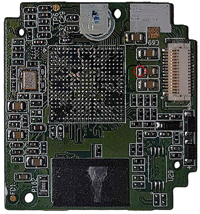

Hallo PriEgor, thank you for help. And quaddamage too, of course.
But now i'm a little confused about the procedure to force the chip into serial programming mode...
1) so we just need a short (temporary) contact from TP10 to the resistor descibed in picture one https://phantompilots.com/attachments/20170905_143426-jpg.87846/ to make when I already have the Putty serial window open?
2) or we need a contact between 3.3v and the middle resistor shown in picture two https://phantompilots.com/attachments/20170905_143455-jpg.87847/? a temporary or continuous contact?
3) or we need both?
Thank you again for your patience
All the connections you make are temporary. It's up to you where you use 3.3V from - TP10 is one possibility.

Hi guys
i connected the middle resistor shown by PriEgor to the TP10 pad, but still nothing new from Putty...
But checking the circuit i noticed some oddities, because from TP3 GND:
at TP10 i have 0,6V inste3ad of 3,3V
at TP4 i have 0V instead of 1,2V
at TP7 i have 0,7V instead 1,8V
at TP8 i have 0,9V instead of 3V
Doesn't sound very good huh?
Can i try taking 3.3V from USB-to-TTL instead of TP10?
Maybe better to take 5V and GND from external power instead of USB-to-TTL?
Yes, that's a correct conclusion - your USB clearly can't power the chip, this is why it doesn't work.
When working with Ph3, I used 1A USB out. Though it had to power Ambarella as well - for you the draw shouldn't be that high.
First i diconnected TP10 from resistor, to restart from beginning.
But even using a 5V 6A external power instread of USB-to-TTL I get a low voltage on the pads mentioned above (very strange, it would seems even lower than before!)
But, making numerous different attempts i realized that if i connect +5V and GND before (from external or from USB-TTL too), and then only after i connect the TX RX wires i get a "connected" status with some garbage text in Putty window.
The TTL logic is set to 3.3V (the jumper is on the middle and the 3.3V pins); maybe i have to try different serial settings, i.e. lower speed than 115200?
[...] maybe i have to try different serial settings, i.e. lower speed than 115200?
If you see garbage which does not resemble text - then yes, the issue is with connection parameters: baud rate, bit count, stop bits etc.
Reactions: Mark The Droner
quaddamage, i was wrong from the beginning ... :p
DM365 chip is the same of your tutorial but the FC200 Live View Encoder board don't need 5v to power on, it only needs GND to TP3 and 3V to TP8
