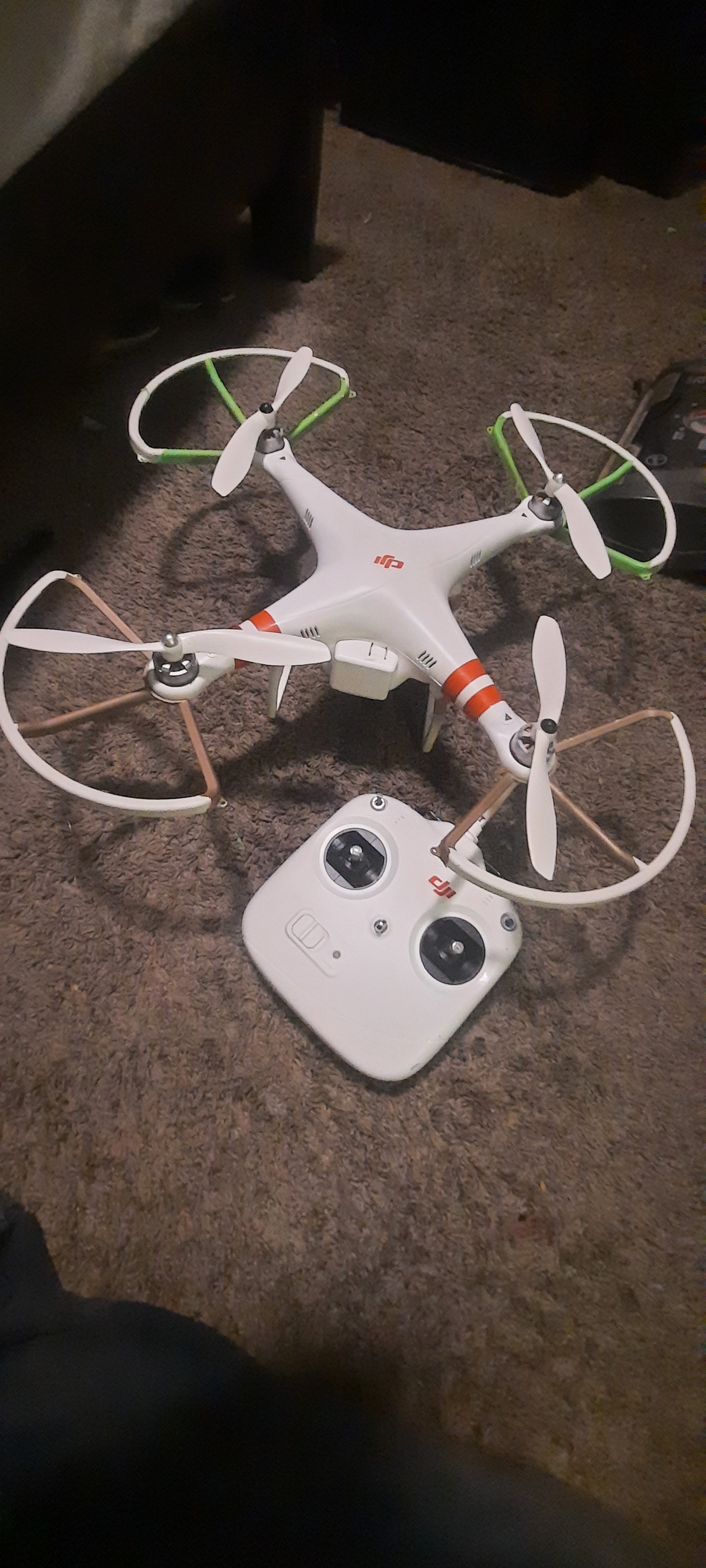

So I have a dji phantom first generation bought it brand new but had it sitting for years not using it and recently I try to fly it again to use it for fishing but when I turn it on and it does its normal flashing lights n stuff, when I try to turn it on pulling the joy sticks to turn it on the drone just flashes a green light rapidly and won't turn on. I just keep trying n eventually turn on n fly it for a bit till battery die but after that it been doing the same n won't turn on. I got new battery n and nothing change. Can anyone tell me what does that mean.

I did but nothing happen seems like the software it's not working, but I guess I find a solution when I plug the battery when it beeps 6 times right after I have to do the turn on with the joy sticks n it did turn on, was able to fly it after.
