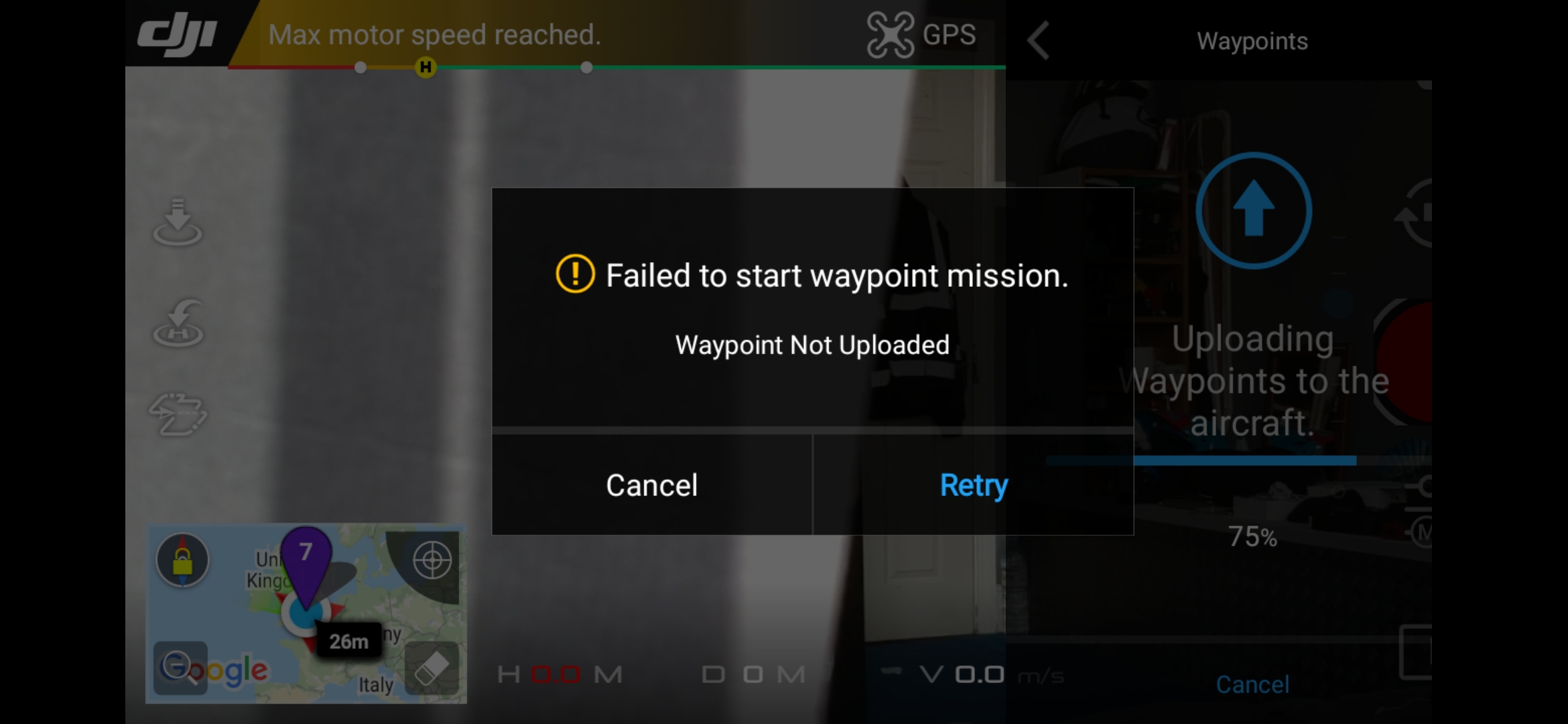

The app worked great on my first night but next day i got as far as loading a waypoint on the dji go 4 mod and it stopped at 60 percent for some reason, i re installed the app enabled the permisions but still same problem
is there something ive not picked up on ? Great app by the way for the first few flights hopefully i can find the issue and continue.
(Dont worry about the max speed warning i just had to simulate flight without the props to show the failed waypoint loading.)
