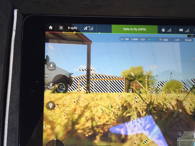

Here's what happened to my video after DJI GO 2.4 update. iPad mini 2 cellular 9.1 was working fine before 2.4. It's only the display, cashe and recorded video are fine. Doesn't happen on my Samsung Tab 4 but the video is very choppy.

The zebra lines indicate an over exposure. You can turn that off in the camera settings if you don't like it. Try reducing the video feed range down to 4 and see if that helps
Here's what happened to my video after DJI GO 2.4 update. iPad mini 2 cellular 9.1 was working fine before 2.4. It's only the display, cashe and recorded video are fine. Doesn't happen on my Samsung Tab 4 but the video is very choppy.View attachment 34356
What is wrong with that video?
Are you referring to the zebra stripes?
If you are those are turned on and off in settings, I think it is called over exposure indication or something like that. It indicates blown out pixels, that is brighter than can be recorded. Turn down ISO or increase shutter speed, but the best solution is to add a ND filter to correct exposure.
