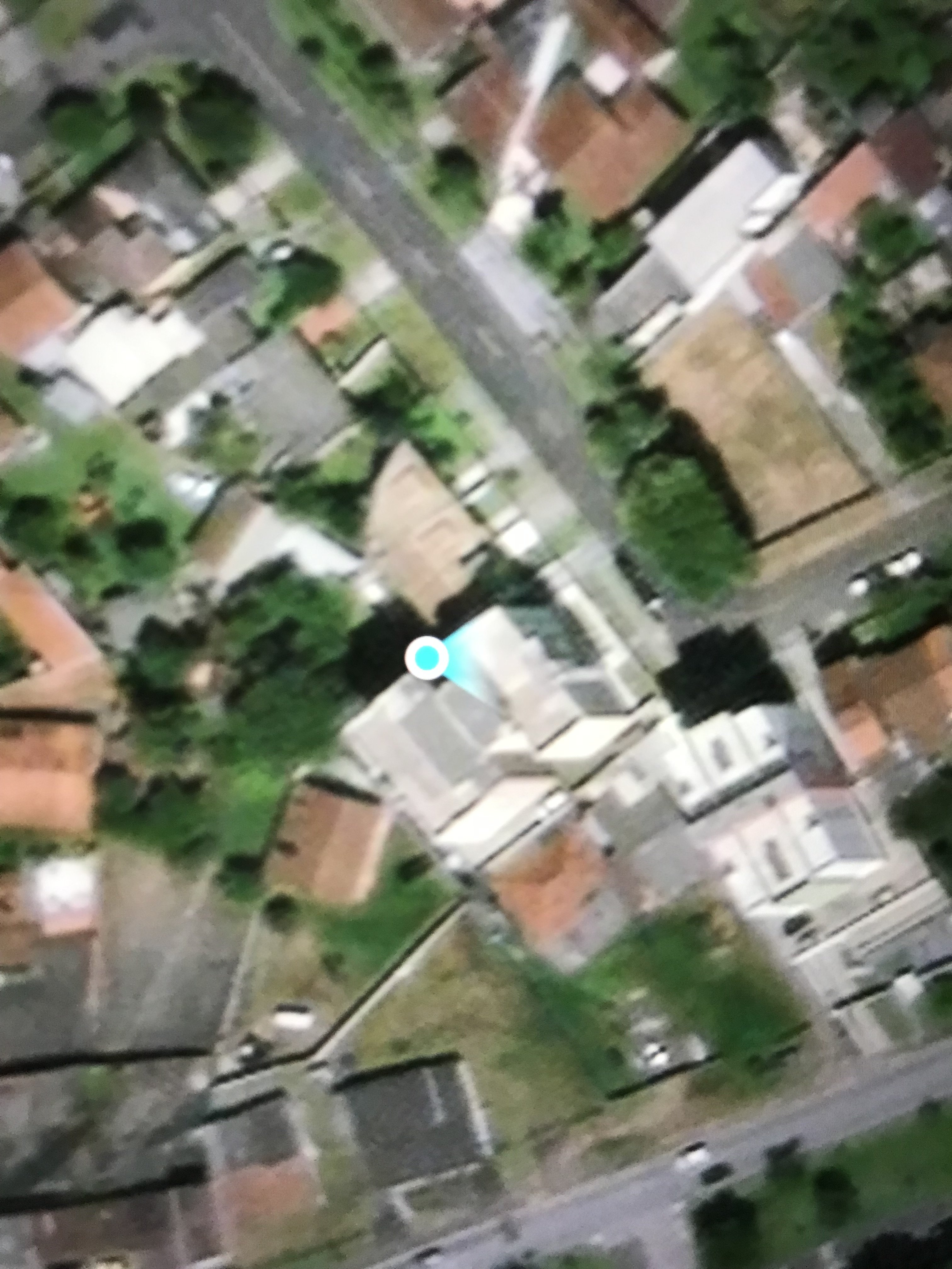

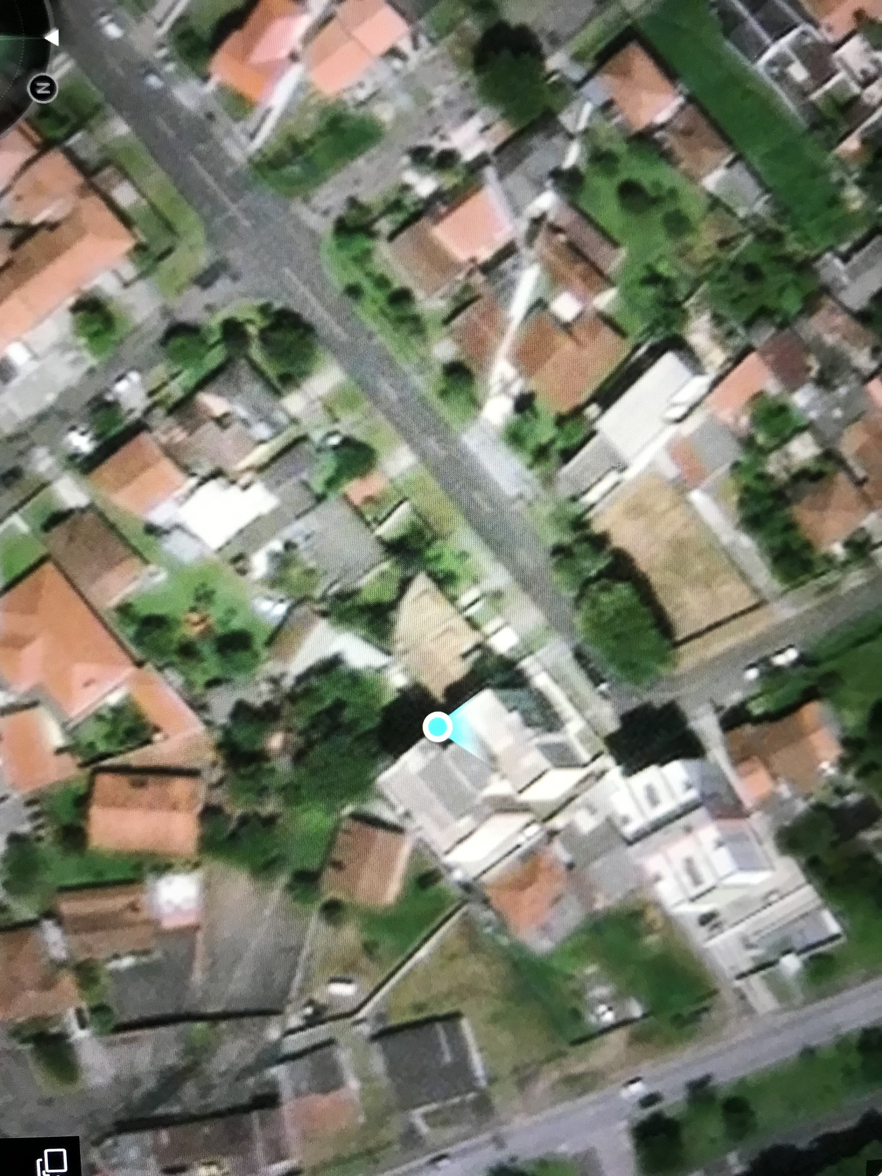

So the blue ball in google maps and in the litchi moves perfectly, I leave the place it moves and shows exactly where I am, but in dji go it gets stuck, I will send a print here so you have an idea.

what happens is this, the blue ball is pointing in a direction and does not leave there, I already tested today in the street, flying the drone, and I went by car walked several blocks he stays in the fixed place does not leave.
In the litchi I did the test went by car walking with the drone, and the blue ball in the litchi was marking exactly the position that I was going.

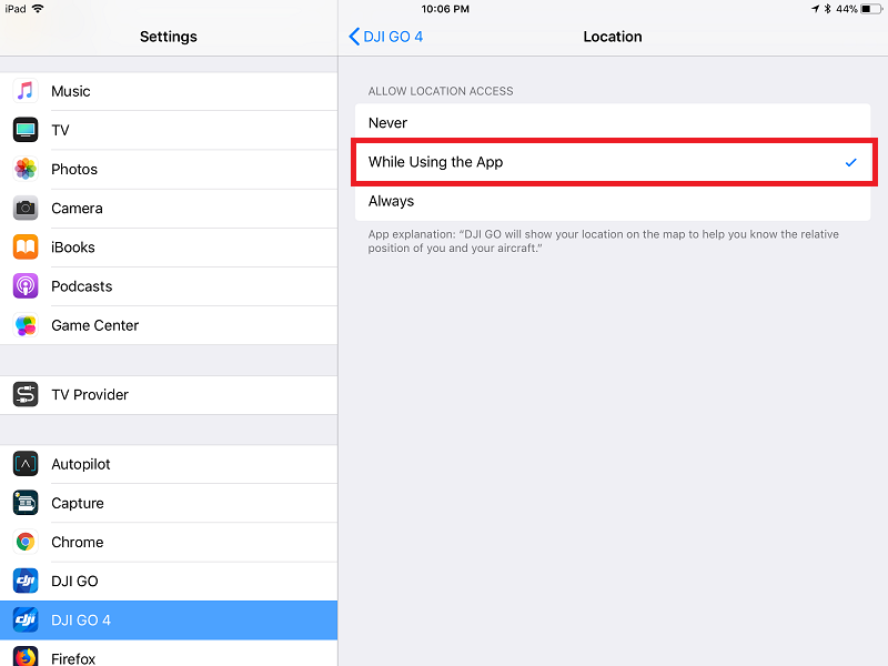

Make sure DJI GO has permission to use your location. You can find that setting in the following section of the iOS Settings:
yes this one, I tried it during the use and already I left also always, always of the same thing.
