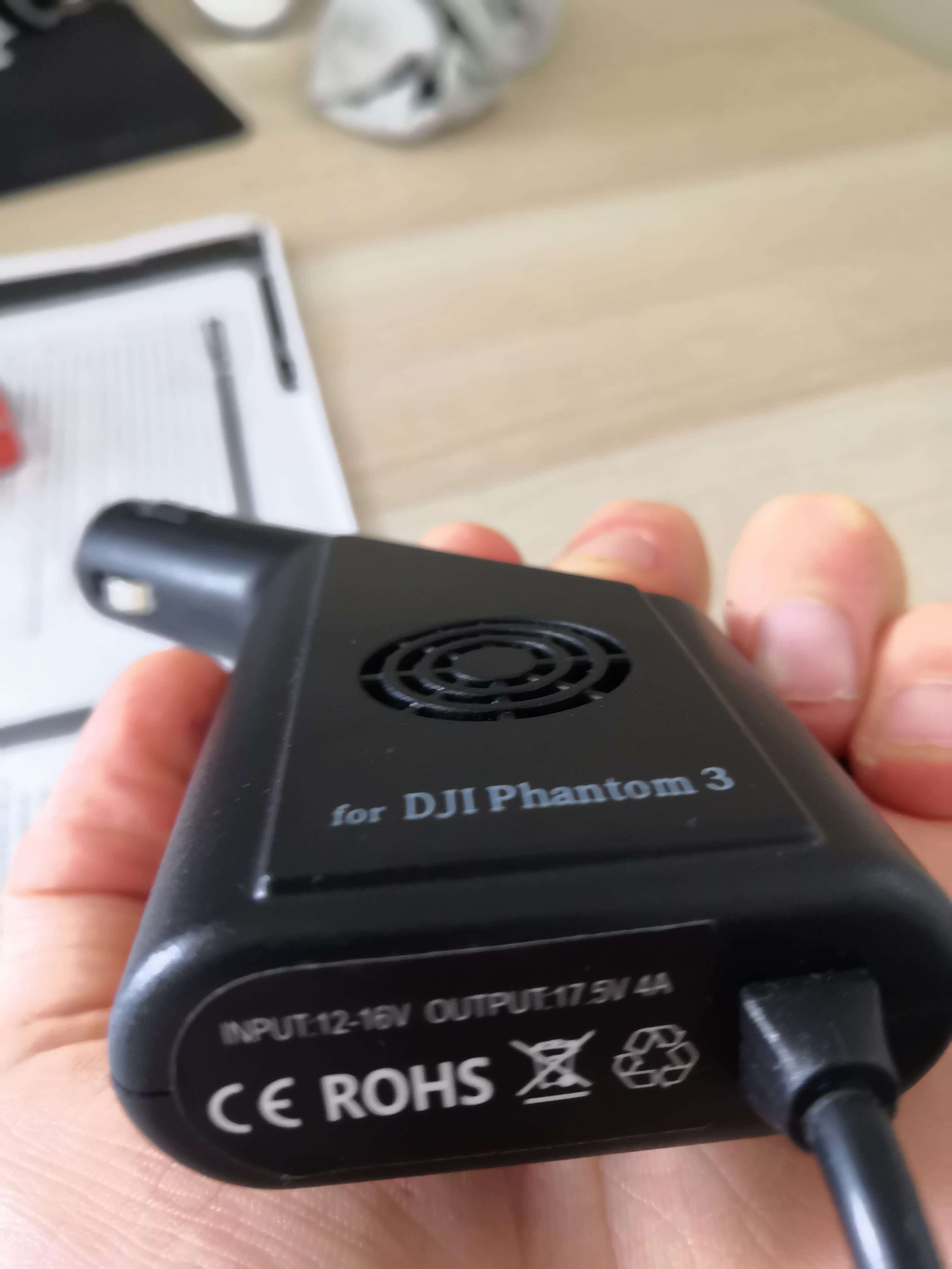

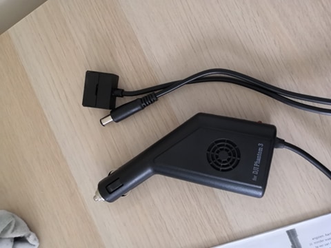

OK post pic of your charger,,I use p3s and p34k charger on my p3 and work fine,,,even if battery for se is 15.2 volt,,,,,sounds like you might need another battery,,I know not cheap but might be only way,there are some good deals on battery's just have to search
OK post pic of your charger,,I use p3s and p34k charger on my p3 and work fine,,,even if battery for se is 15.2 volt,,,,,sounds like you might need another battery,,I know not cheap but might be only way,there are some good deals on battery's just have to searchView attachment 111911
I ordered another charger because I lost it but this is my car charger that should normally work. If my new charger arrives I will check it and if it is still not charging I need to buy another battery for around 60 euros (65 dollars) Is this a good price?

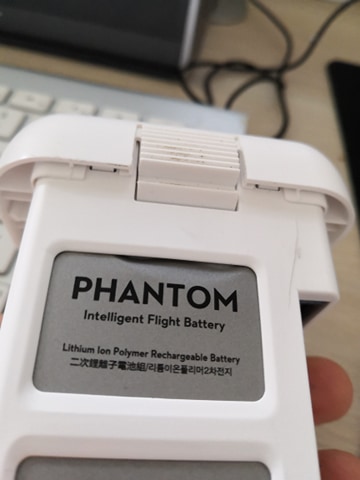

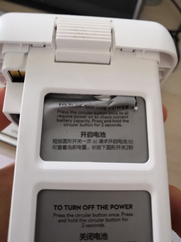

This is the damage on the battery + The car charger. I simply don't know if it charges with a wall charger, that's why I ordered a new one.
