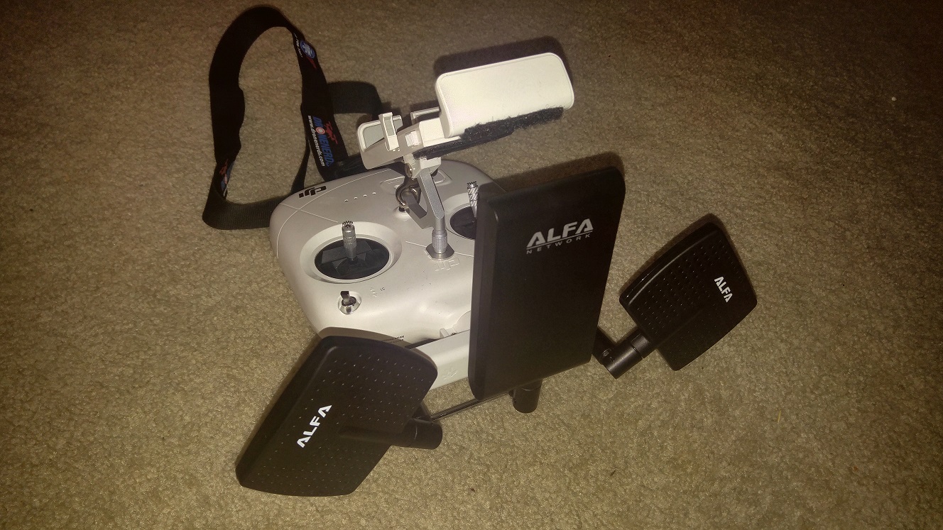

OK so, I am impressed with these antennas 10,000 ft Test today with plenty more room. Battery was Getting low because i had done other test before this one so had to cut trip short. WOW! Thats all i can say .
Running Argtek mod with the Alfa antennas Magic power 5.3 at FCC 27dbm 1.07.09fw DJI Go app is 2.9.10 which i read others on this site had good reviews with also so i tried it and Love it.

How the hell do you get so far with that setup. I get only 6000 with the same alfas and an 11dbi! Maybe it was because it was damp misty day.
Edit: I was curious about your 10dbi 5ghz antenna vs my 11dbi, so ones in the post :)
Antenna quality varies. Not all designs are the same and just because something is labelled with a specific dBi, doesn't mean it really is.
With that said, is your 11dBi antenna directional or omni directional? Omni direction will not get the same distance as a directional antenna.

I did try my 11 dbi omni antennas on this same day and was maxing out around 5000ft. And Also with original Directional Argtek Antennas Really wasn't much better. Then with the ones Sisco Suggested was where i saw good results. Now i did have to adjust the 2.4 ghz panels during flight but once i found the sweet spot i still had strong signal at 10,000 feet.
