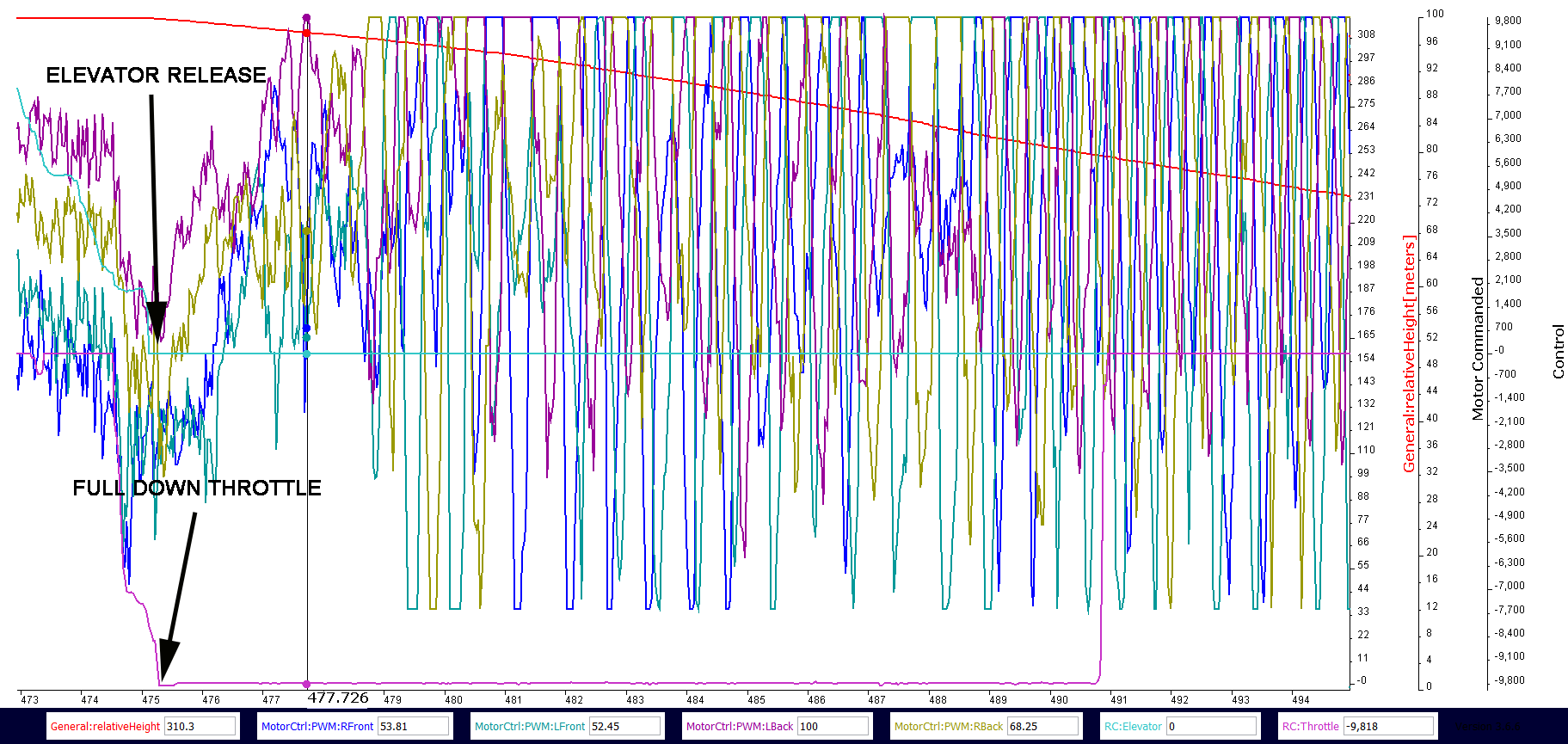

You spiral began after you released the elevator, issued a slight yaw command then immediately gave full throttle down. Typically this would be a lost prop. However, generally speaking the aircraft will come down but will not spiral out of control as it appears was the case here. It could very well be a motor issue and/or the ESC. The aircraft .dat file unfortunately on the Standard does not record the motor data other than the PWM, but that could give an additional clue. You can see what the aircraft was doing during the time I mentioned below.

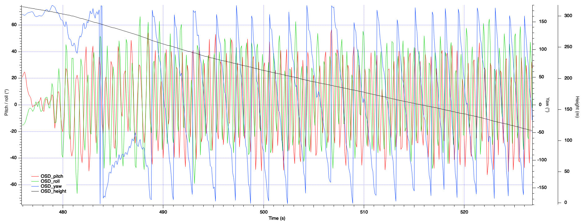

Look at the oscillation period (700 ms on attitude, 2 s on yaw), the relatively narrow range of pitch/roll excursion (± 40°) and the relatively slow descent speed (4 m/s). Haven't seen that for a long time. Looks like classic vortex ring state descent.

It was a thing with the P2 - very easy to trigger. The P3 geometry was tweaked to reduce it. I guess there might be some specific fault in a motor that could cause similar effects, but I've never seen that happen.
@NIK1 ... As provided by @sar104 above, it looks like there could have been a vortex state occurring. Going by the fact that you mentioned the aircraft flew fine afterwards, there may or may not be a motor issue. I am going simply by the RC inputs as shown below as to a cause and effect. Your inputs being so close together ( >2sec for all 3 ) that "may " have caused the unrecoverable spiral to occur, especially the down throttle immediately after releasing full elevator. The spiral began slowly, then became constant at 360 degrees every 2 seconds until impact.

What I meant by the inputs are the fact that you were flying at full forward elevator, you applied a slight rudder then immediately gave full throttle down. When you release the elevator the aircraft will pitch up slightly to stop. You did not allow the stop to occur before issuing the full down elevator, which could have contributed to the "presumed" vortex effect. Once that starts, it is almost impossible to recover from. You can see the inputs in the graph above and they are very close together, almost simultaneous in fact. There is not much you can do at that point. IMO, I would have issued full aileron one way or the other to attempt to escape the vortex. This is a very rare occurrence but it does happen. All rotary aircraft are subject to that to some degree, although it is much less likely at present.

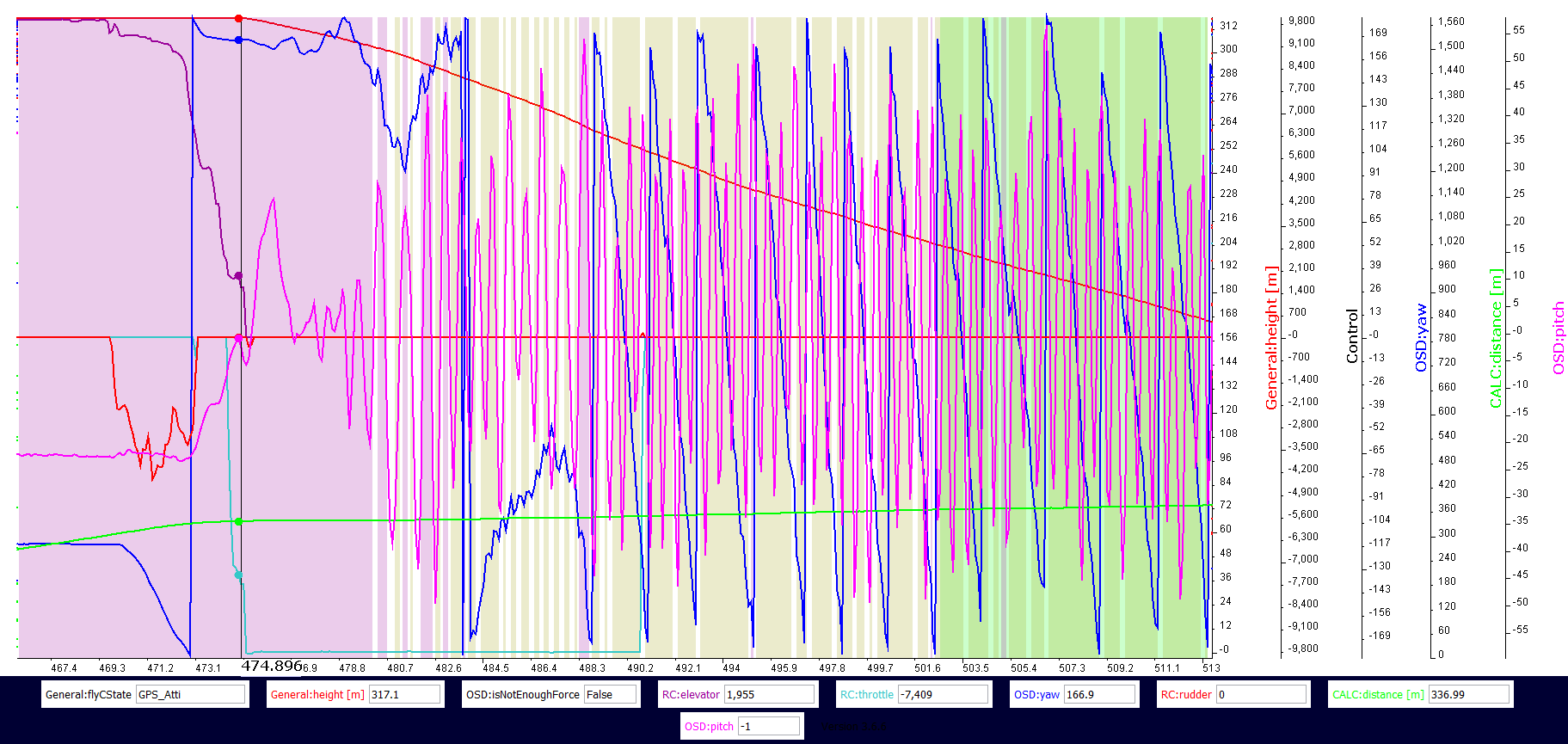

There was plenty of height to work with, but no sustained effort to escape VRS laterally - if that's what it was.
