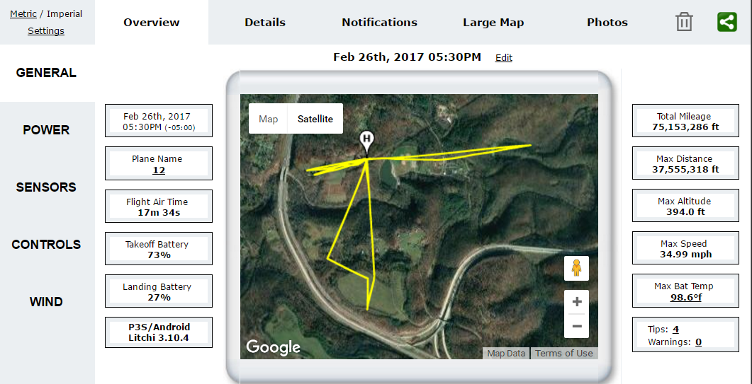

Ok, so I did the mod. Went easy enough, except I could not get the 5.8 connector to be tight in the old antenna hole. I drilled a hole in the top half, just above the stock antenna mount, and ran the cable there. Now it is firm. Did a test flight, and got to a mile. That's up from about a half mile that I normally get, not great, but better. The odd thing is once I landed, I pulled my Healthy Drones log, and got this:
For one thing, the Plane Name is incorrect, and the other, well, is the distance! Anyone seen anything like this? This is on Litchi BTW.
Is the map correct, is this the place your flew at ?
That is the log link. The odd things happen around point "O", where is switches to manual, and then it says I lost signal for 369 seconds!
It's weird because the flight seemed normal. I flew out far as I could before it lost signal, and initiated RTH.

I gave you the link to the other log viewing site, that you could compare the two to see if it's duplicated there or it was just a healthy drones glitch. You could also go into the Go app and play back the flight log see if the error is duplicated there also.

Well, I did another flight today, and everything seems fine in the log. I'm gonna look into that further though, it was quite odd!
