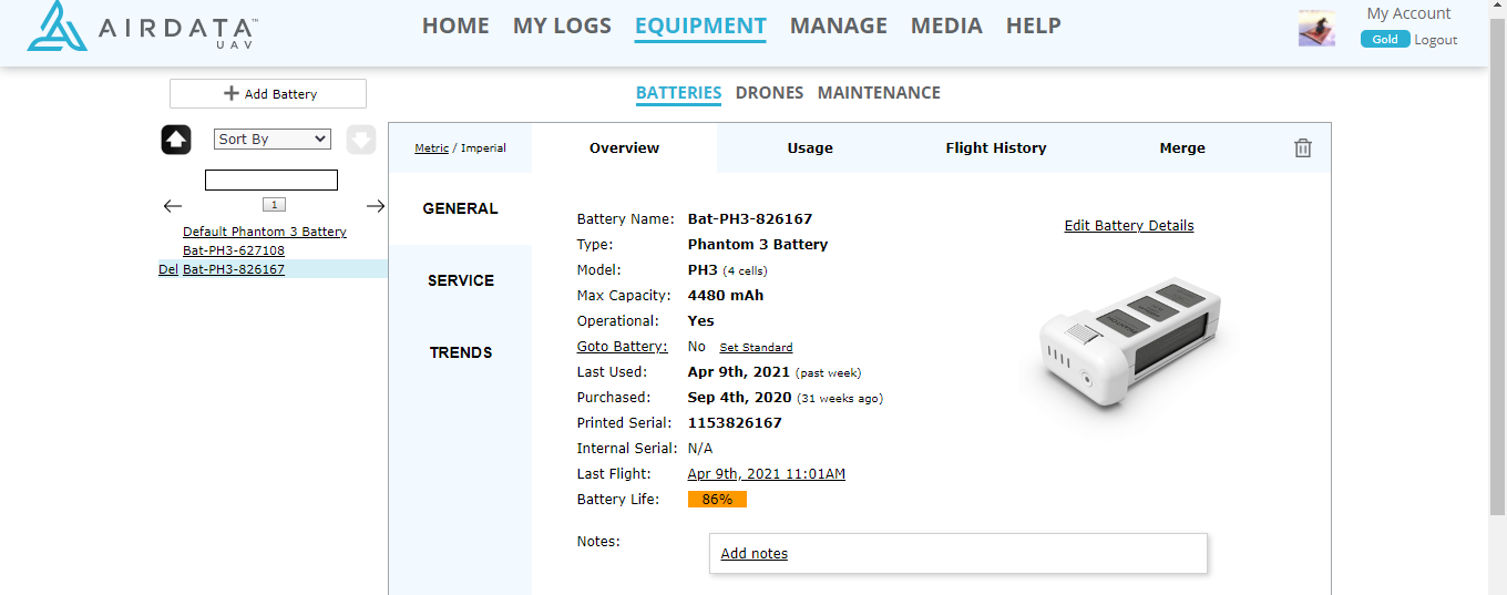

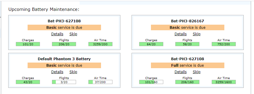

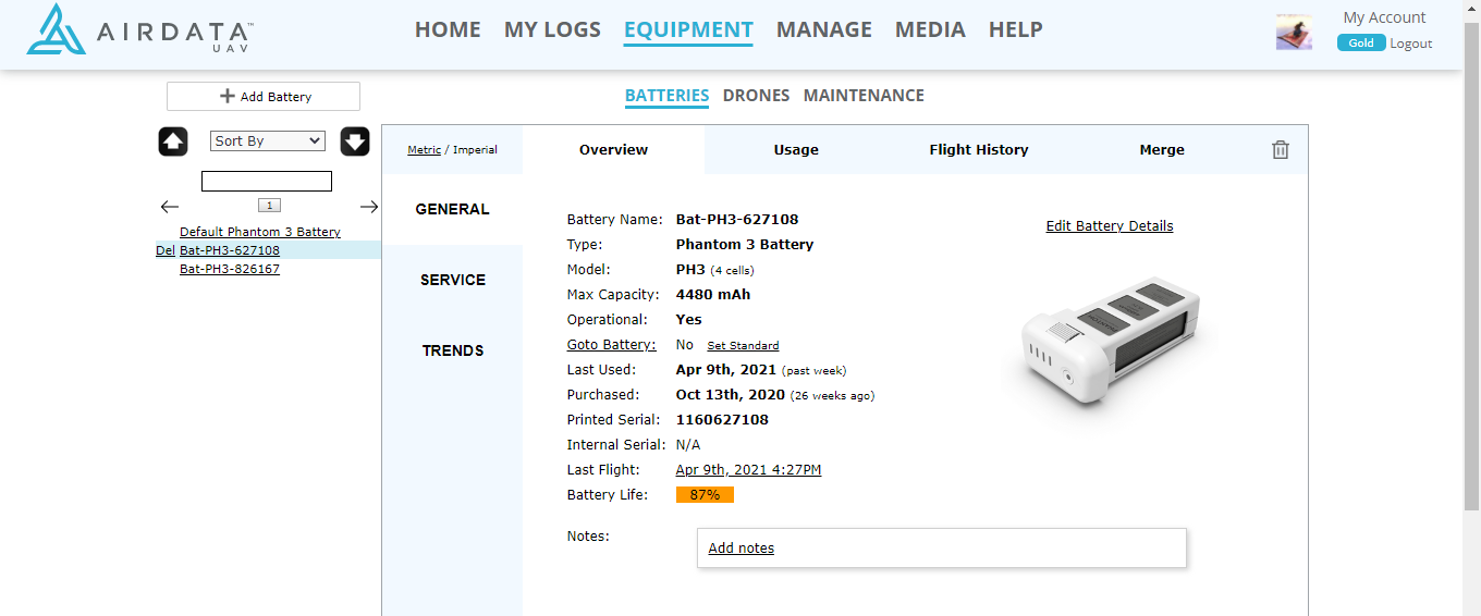

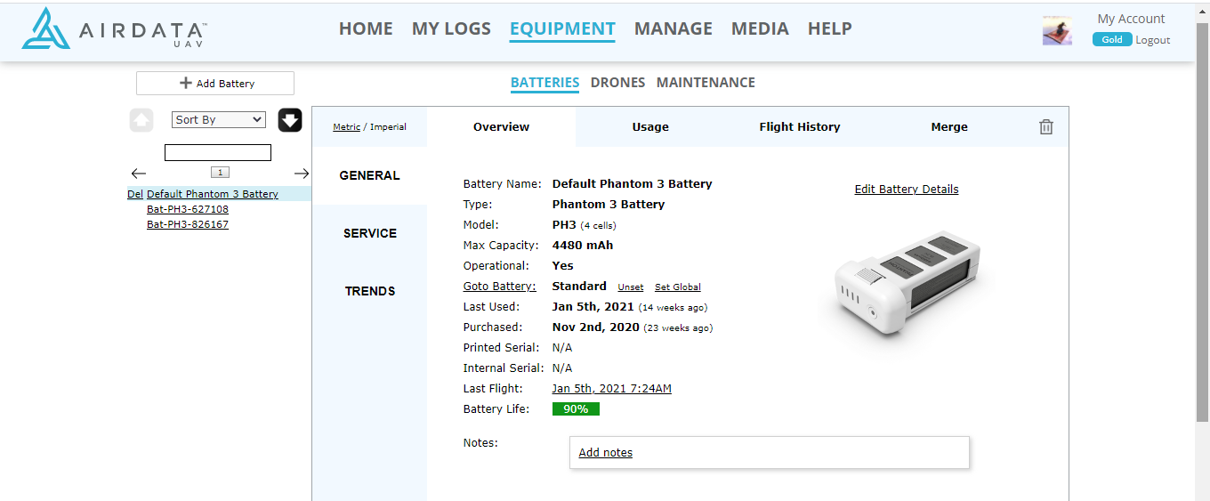

Your mention of possible battery failure got me to thinking, Chris, which can on occasion be a good thing. I checked my battery usage history as I hadn't done so in a while, and was dismayed to see that all three of my batteries were long overdue for service. I had become complacent and simply failed to keep up with the specified battery maintenance intervals spelled out on Air Data's pages.
Having performed just one battery service a while back on each of my three batteries, I realize too late now that the most likely scenario that brought my drone down was not a battery disconnect, but a catastrophic battery failure, resulting from my own negligence in this area of drone management that I now understand way too late, is absolutely critical.
My laxity with regards to battery maintenance was perhaps borne out of a misconception that battery failure would take the form of a progressive degradation in flight time, as opposed to a sudden and unanticipated battery shutdown mid-flight. With my flight times still consistently up in the 22-minute range on all three batteries, I wrongly assumed that there were no imminent failures on the horizon. Now, I know better.
I would be grateful for any observations that can be shared by the experts here, now that the full extent of my drone novice buffoonery is documented here in the attached screenshots from Air Data's maintenance pages. If the most likely cause of this crash is battery failure, and NOT an in-flight disconnect, then I will need to take this lesson to heart now, before my replacement drone arrives, so that this avoidable debacle never plays out again. Thanks in advance for any thoughts that can be shared in this regard.

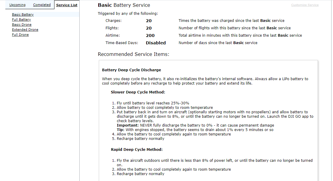

What is "Air Data " & how are you servicing the Batteries ? Is this data available one the P3's program or something down loadable ?
Air Data is a website that allows drone owners to keep a record of how many hours flown by their drone, and how many charge cycles are on the batteries used, along with other useful performance data such as maximum distance flown, and battery temperatures.
There is a small price tag for this service, but it is well worth the cost in my view since I do like to keep track of how many total miles my drone has flown, along with that all-important battery service information that I obviously should have put to better use, looking back with hindsight. Servicing the drone itself entails cleaning the battery terminals and a couple of other related items also listed on the same website.

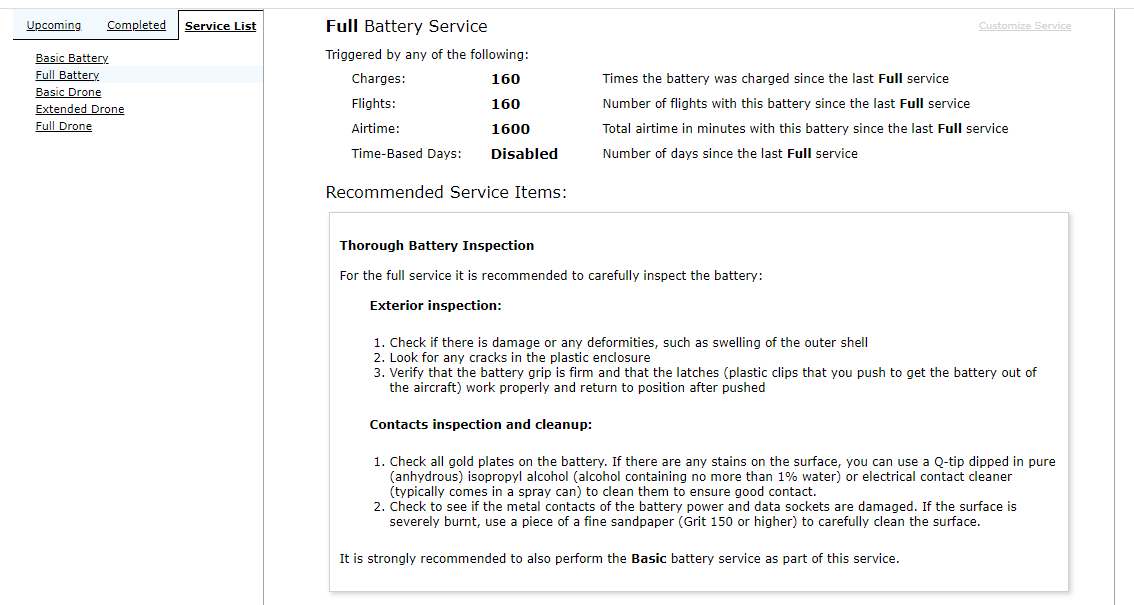

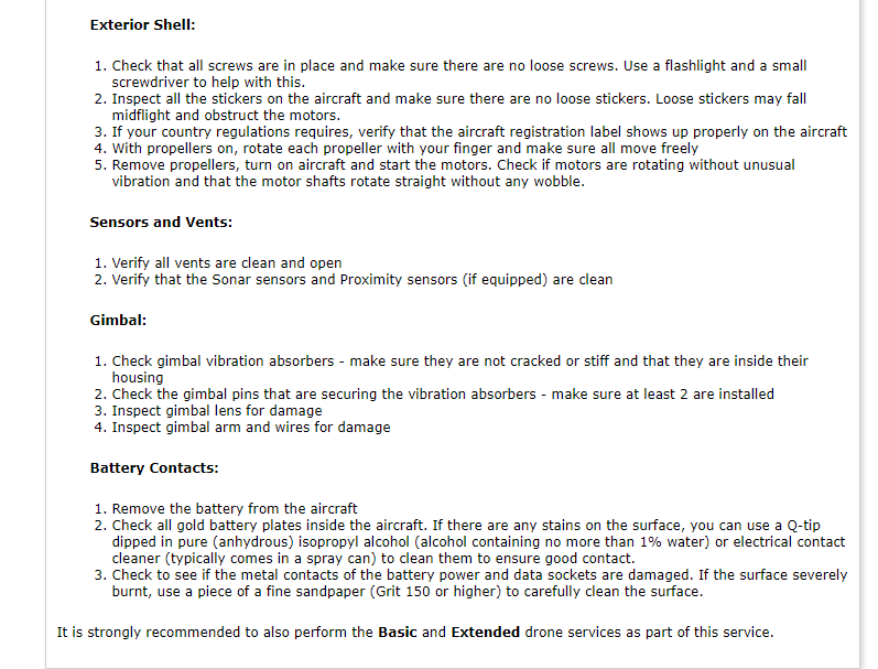

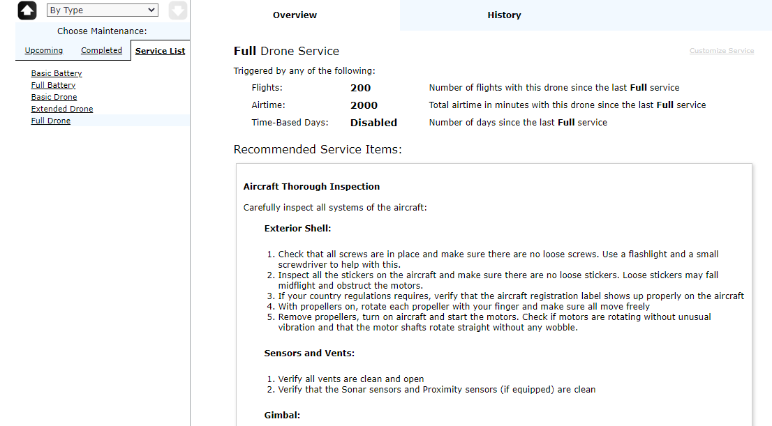

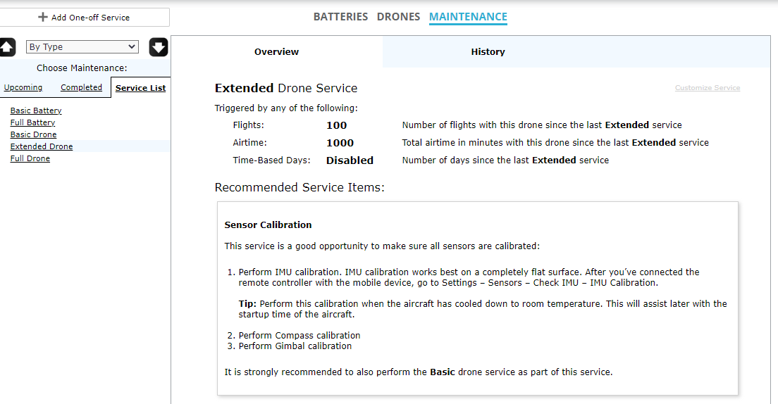

The battery service routine entails a full discharge and recharge that is normally recommended at certain specified intervals based on cumulative hours of battery use. Details can be ferreted out in the link above if you decide to subscribe to this service.

I must admit, I don't do any of the battery maintenance or drone maintenance routines suggested in AirData but instead use the information to monitor my batteries performance and hopefully spot any anomalies before they lead to a catastrophic failure. I check charge cycles, temperature, health, deviations, and error messages. One of my batteries - a PowerExtra battery as I mentioned above is over 4 years old and is still in use and has outlasted the original DJI battery which I retired long ago due to swelling. According to Airdata, it is at 74% of its life. I usually fly my batteries until they are around 30% or just under remaining and rotate them.
@Billie Nelson what your mishap has made wonder is, at what point should you retire your battery? Aside from the obvious signs like a swelling battery or constant cell deviations/cell failure, when do you retire a battery that is still working well and is not showing any signs of imminent failure? One of the things that worries me is the sudden failure of a seemingly perfectly working battery due to its age and gradual degradation.

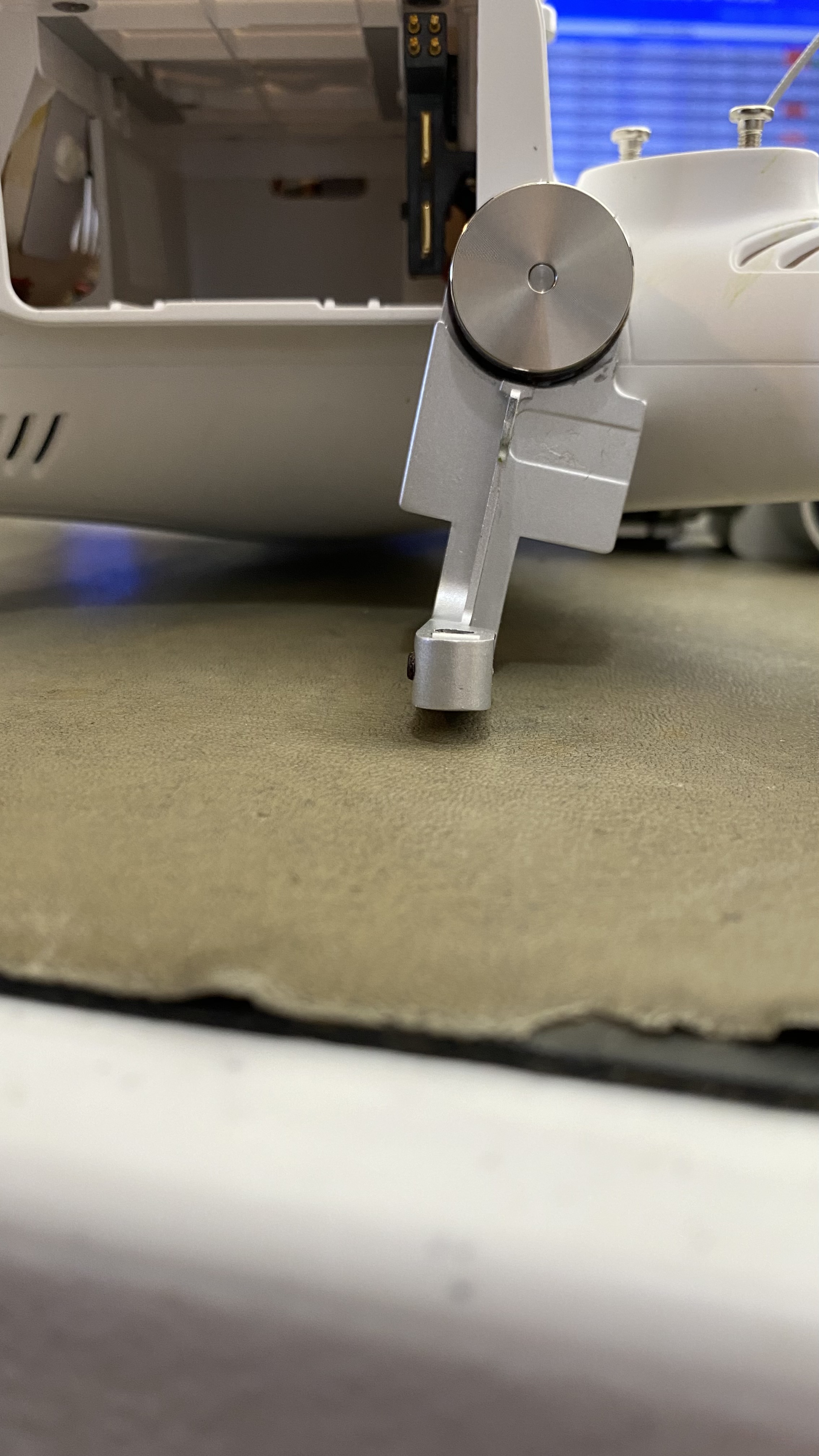

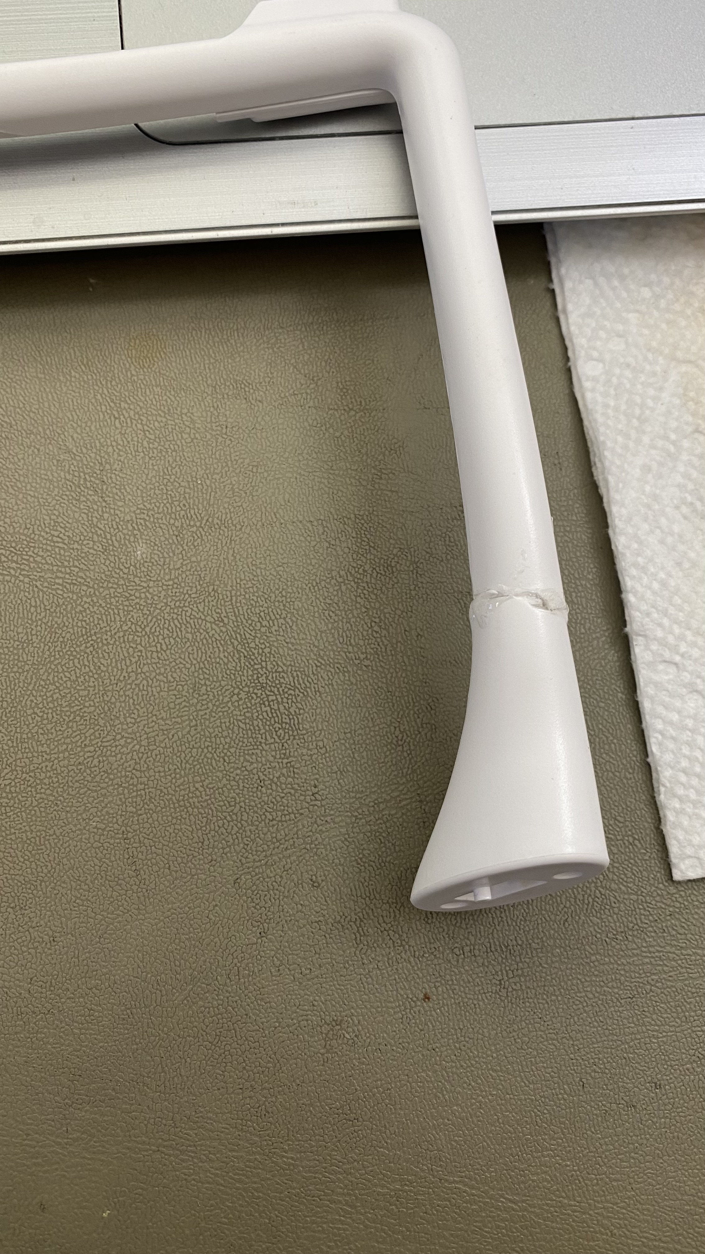

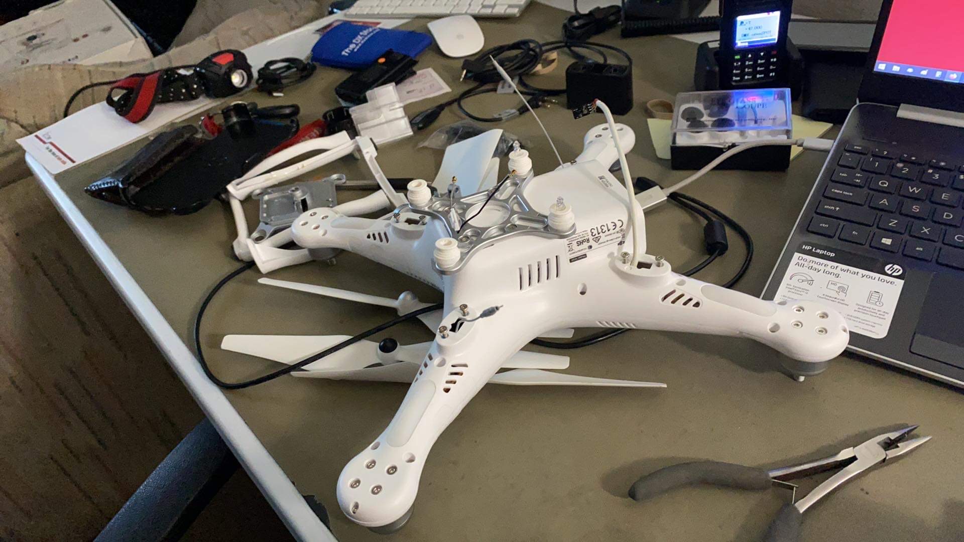

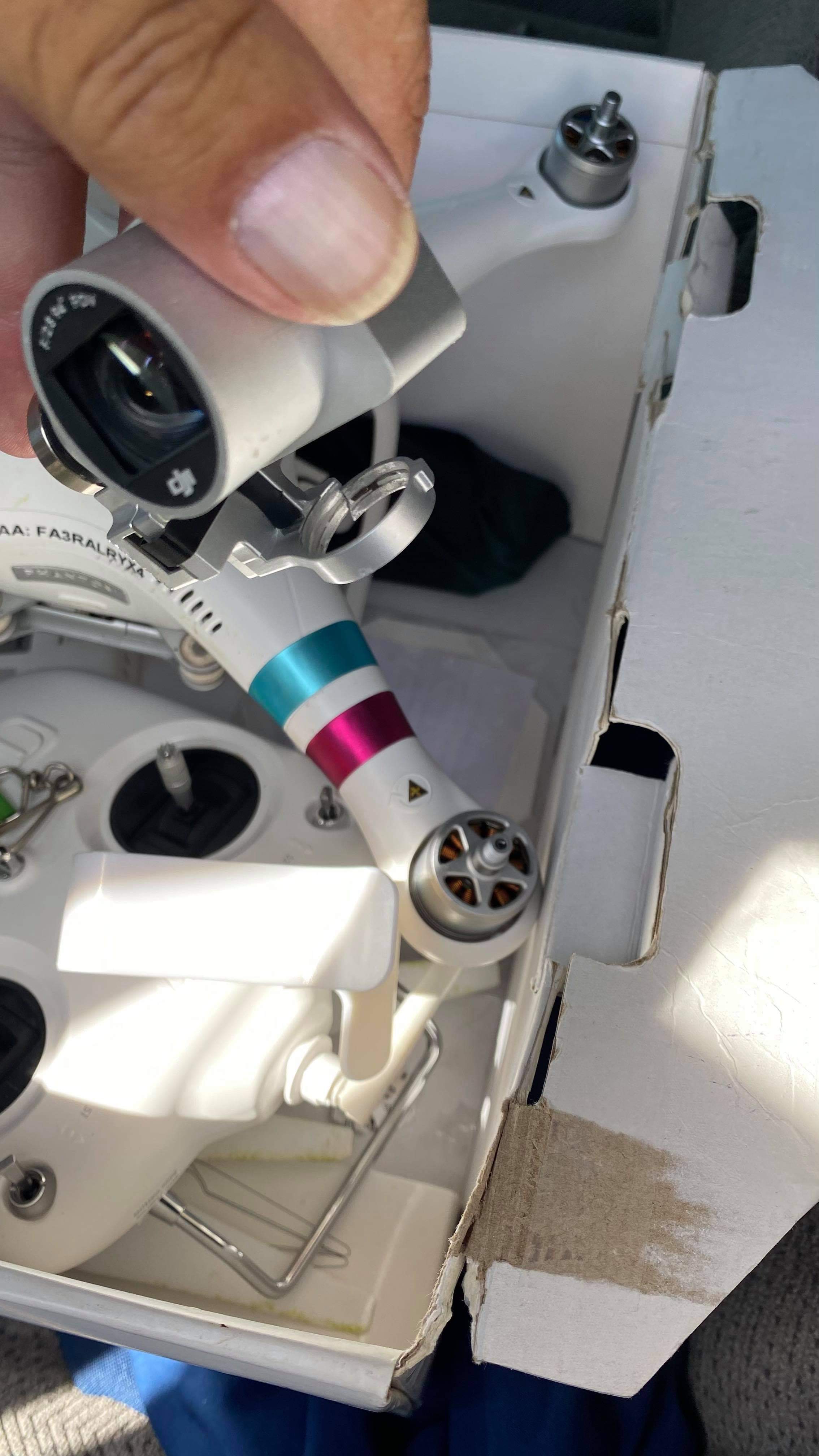

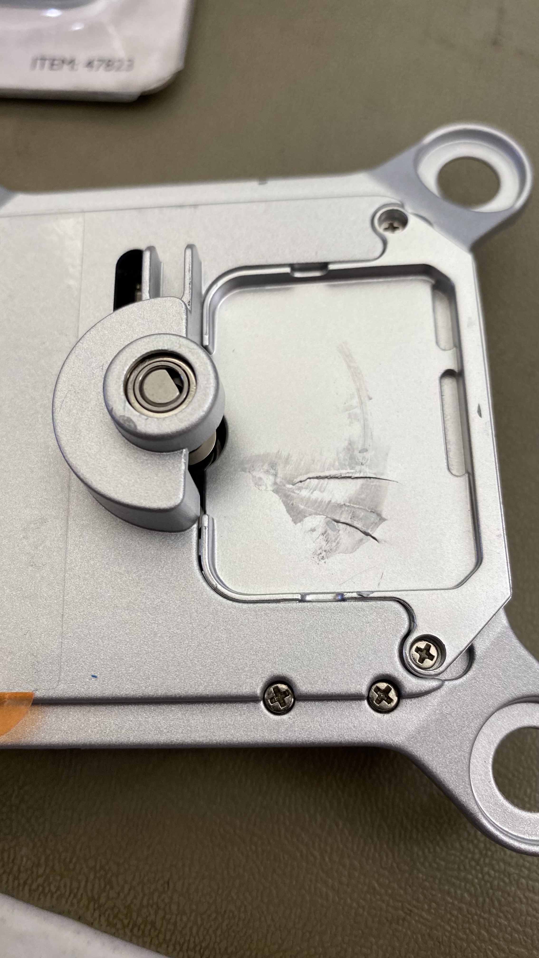

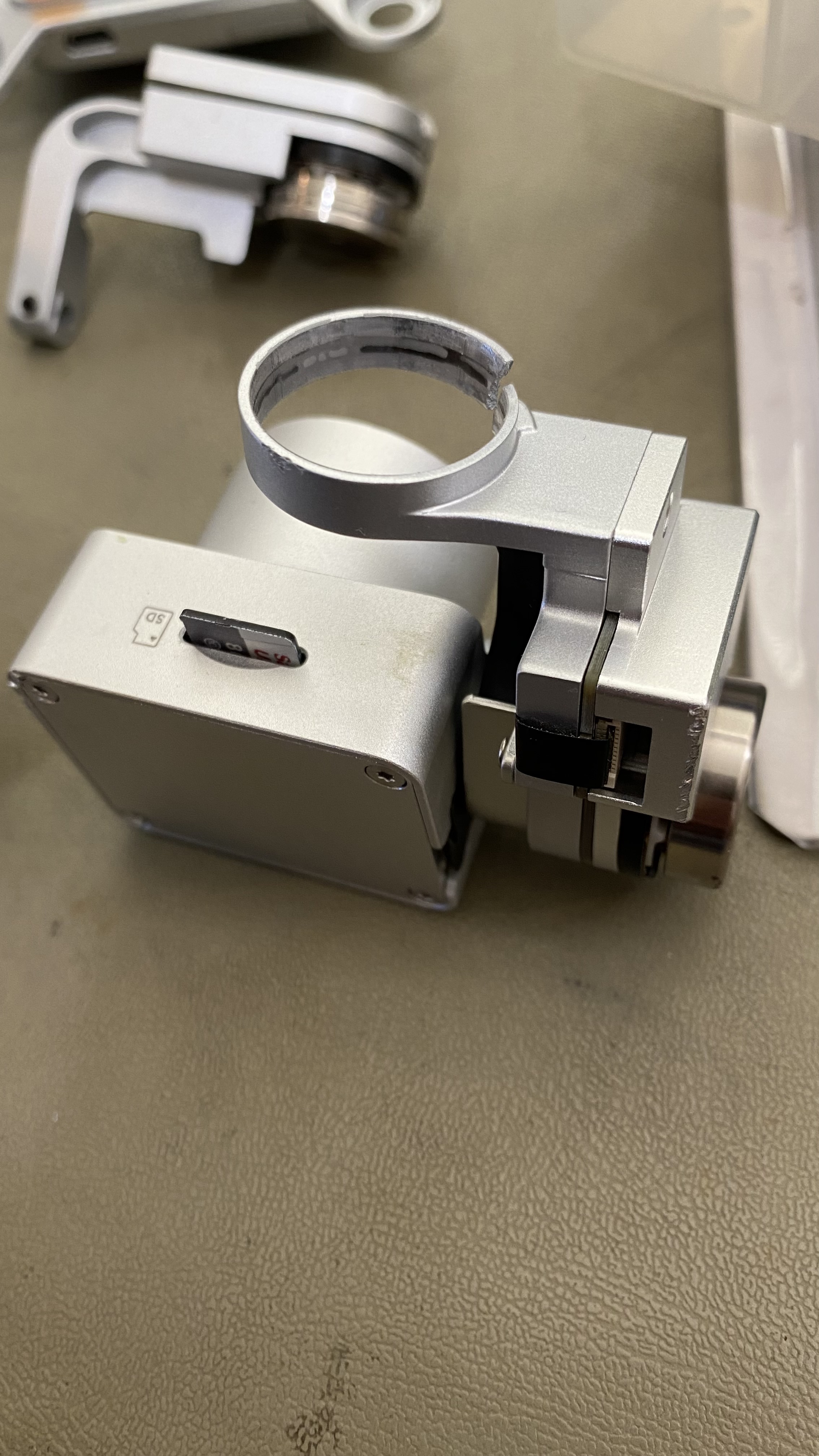

This was the last good picture I got from my P3S (the Brewhouse across the street from me from about 110'), the evening before it crashed. I had gotten a warning of EXTREMELY strong 'interference' just before it suddenly went into an uncommanded climb to about 30-35' (I was only at about 10-12' at the time) and headed across the street from where I was and it crashed into a tree at an apartment complex, flipped inverted and fell to concrete.

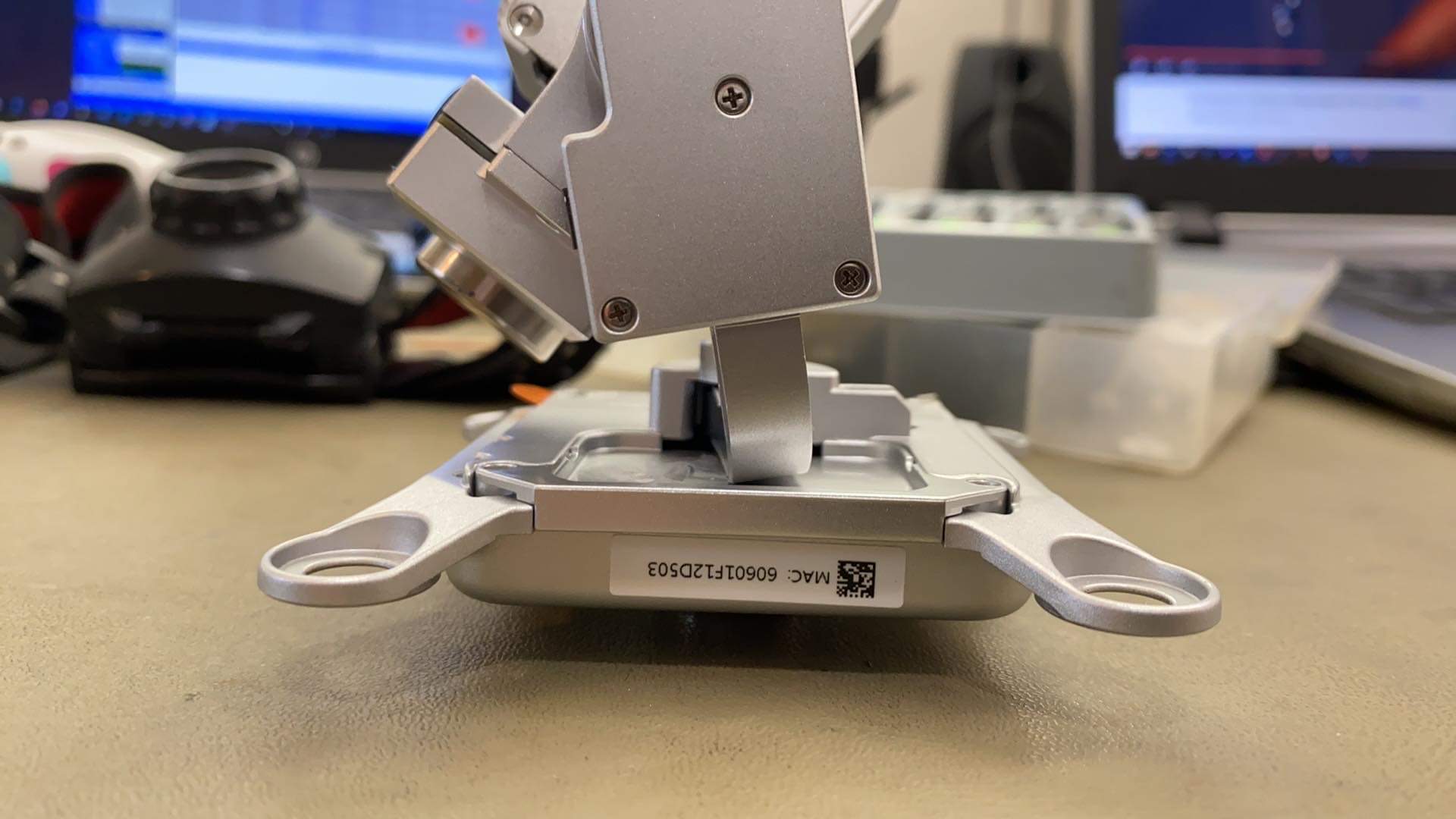

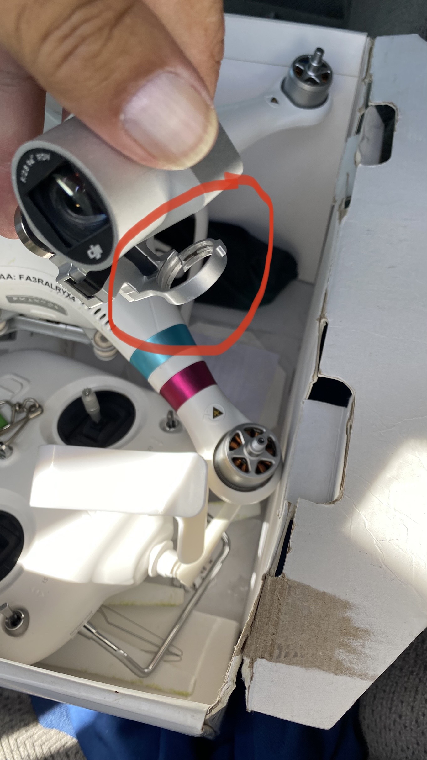

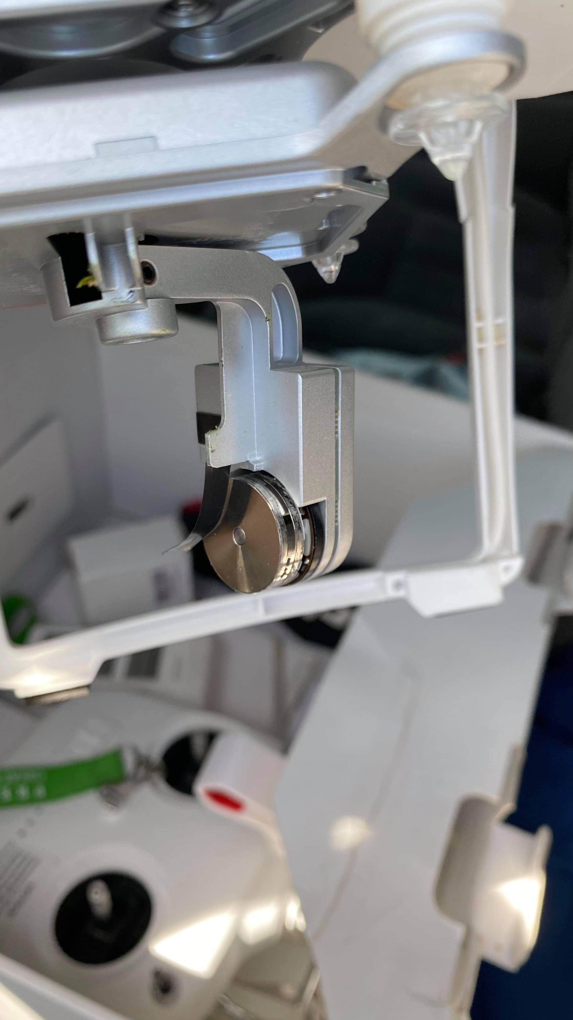

Initial damage was to the camera/gimbal and a landing leg (broken), but I'm trying to get the upper shell open (those YouTube videos make it look a lot easier than it actually is - still haven't gotten it open to check for any internal damage).
So far, I'll have to replace the whole camera/gimbal setup, but that can change, based on what I find if/when I get the shell open.
Reactions: Billie Nelson

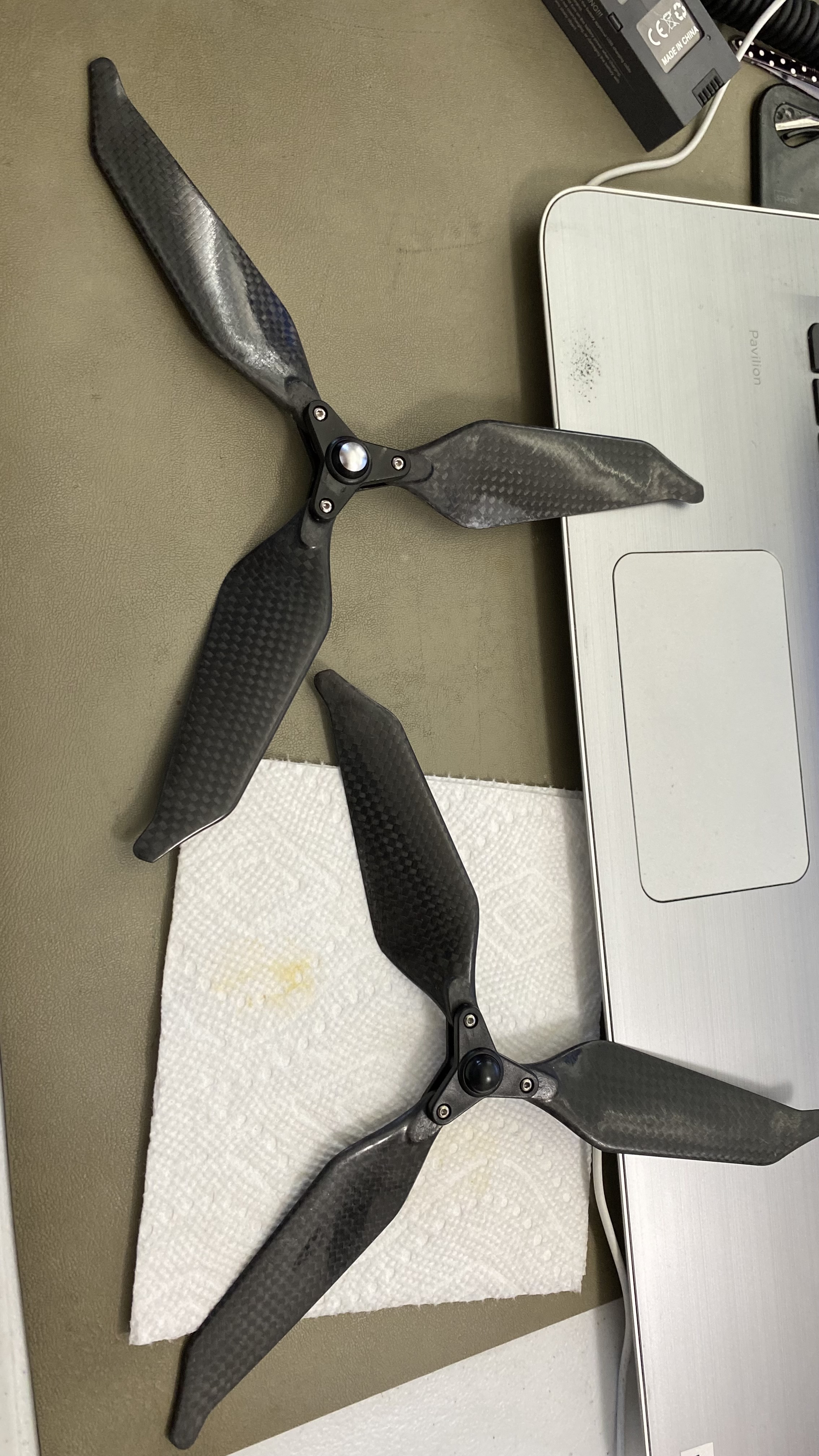

Also gives me the excuse, once it's repaired and airworthy again, to get the 'extended' landing legs for it. I had already gotten the 3-bladed props for it (they came in yesterday).
The shell can be tricky to get open, just go slow and be careful not to break any of the tabs. One of the things you might want to check is the IMU sometimes after a crash it can get stuck. Often a hard knock with a handle of a screw driver will get it unstuck.
I bought folding props for my P3S a few years ago - never used them as I didn’t want to chance loosing my drone. May eventually try them sometime but for now I am content with my MAS props.
