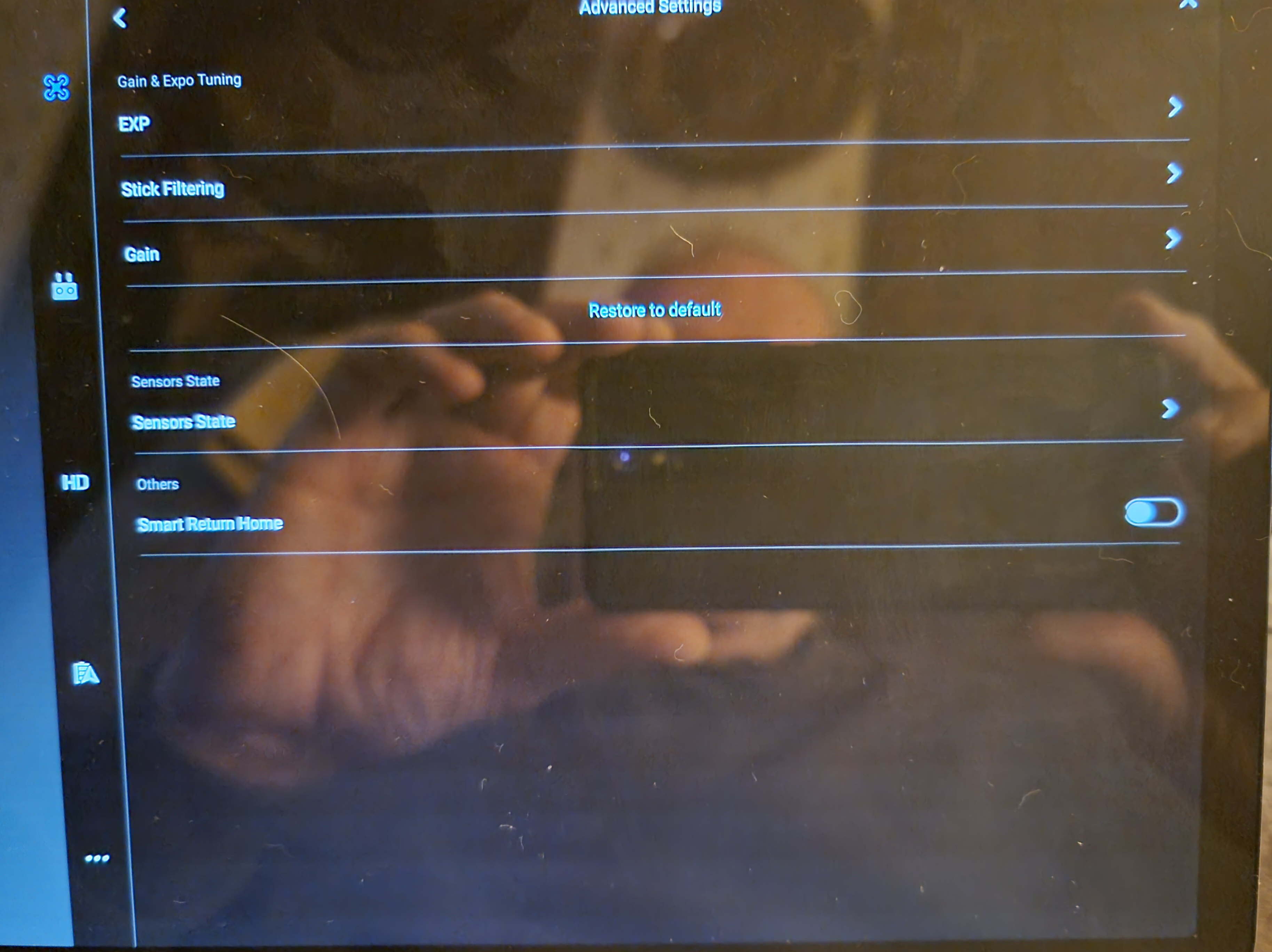

I don't need this function. I purchased an add on gimbal whose instructions said to disable the VPS in dji go. This isn't an option in my dji go. Tried to remove the vps module but discovered that it has other necessary functions. Anybody ever just tape over the sensors and camera lens ? Thanks,

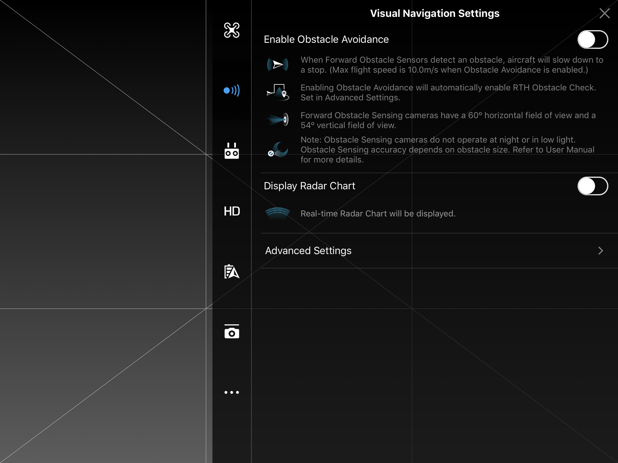

Since this is the Phantom Pilots forum, and you haven't mentioned which drone you're referring to, I'll assume a modern Phantom, like the Phantom 4 or P4P. You should be using the Go 4 App for a modern Phantom (not the Go App). The option to disable Obstacle Avoidance is pretty straight forward. This is for Go 4 App v4.0.8 (see how specific I was there?).
You're welcome. Looks to me like you're using the wrong software (what the kids call "apps" these days).

He's posting in the Phantom 3 Pro/Adv section so i guess its not a P4 or similar. Havng hooked up my P3P i see the same screen, so i'm gonna say you cant disable theVPS from the app
