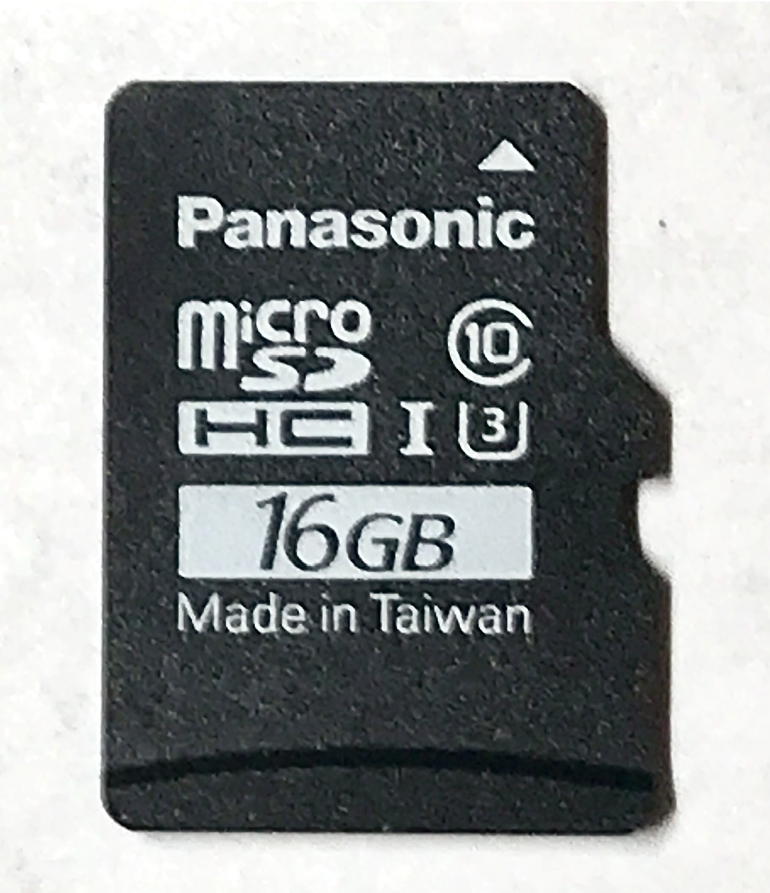

I am inclined to agree with @jack1144 in regards to your computer’s ability to play 4K video. Another possible issue is the speed of your SD card. You want a card that has a U3 rating to record 4K video smoothly.
View attachment 121187View attachment 121188

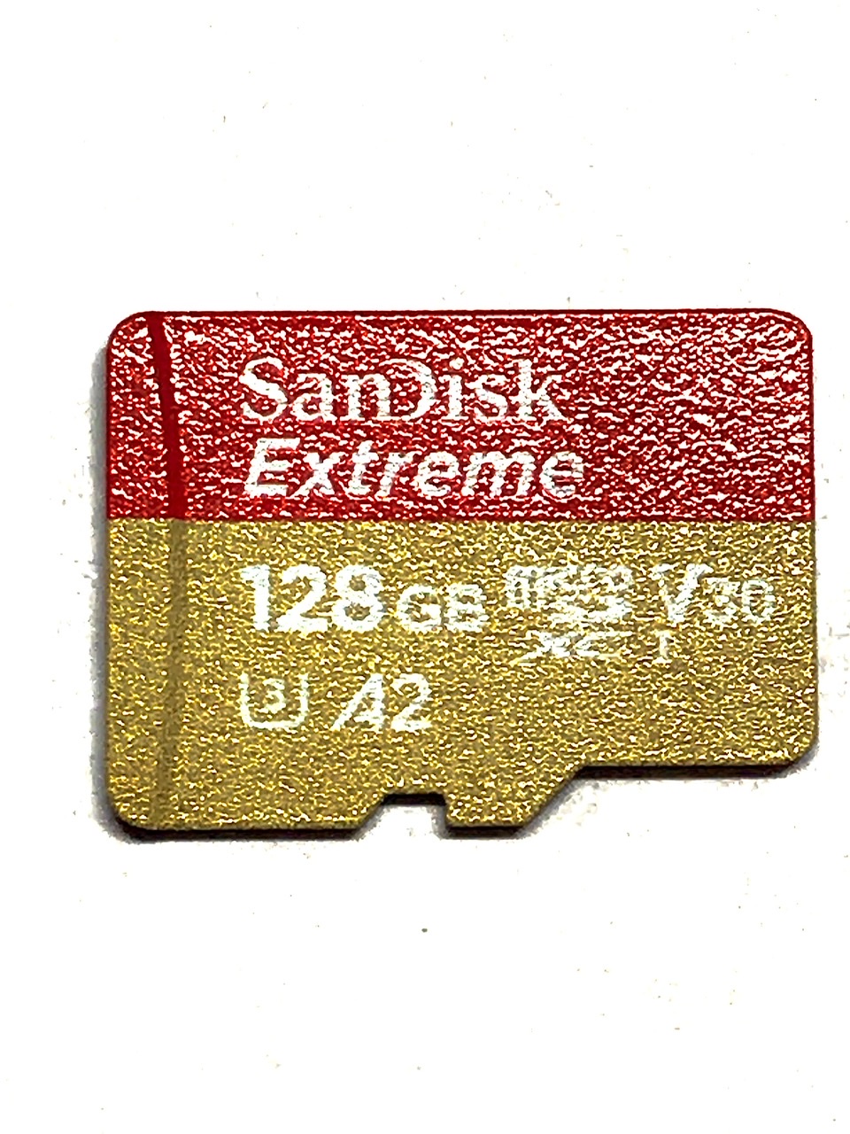

Hello,
I have a sand disk like the one who have posted above. 128 gb.... Will do various testing to try and identify the situation. Computer is apple, built in 2011. Has 20 gb of ram...just put a new hard drive in it. Will do the scaling down to 1080p first....I must remember, relatively new at this and chances are it was the operator flying the copter (me) that is causing the problem. Its like trying to ride a bicycle again. LOL
