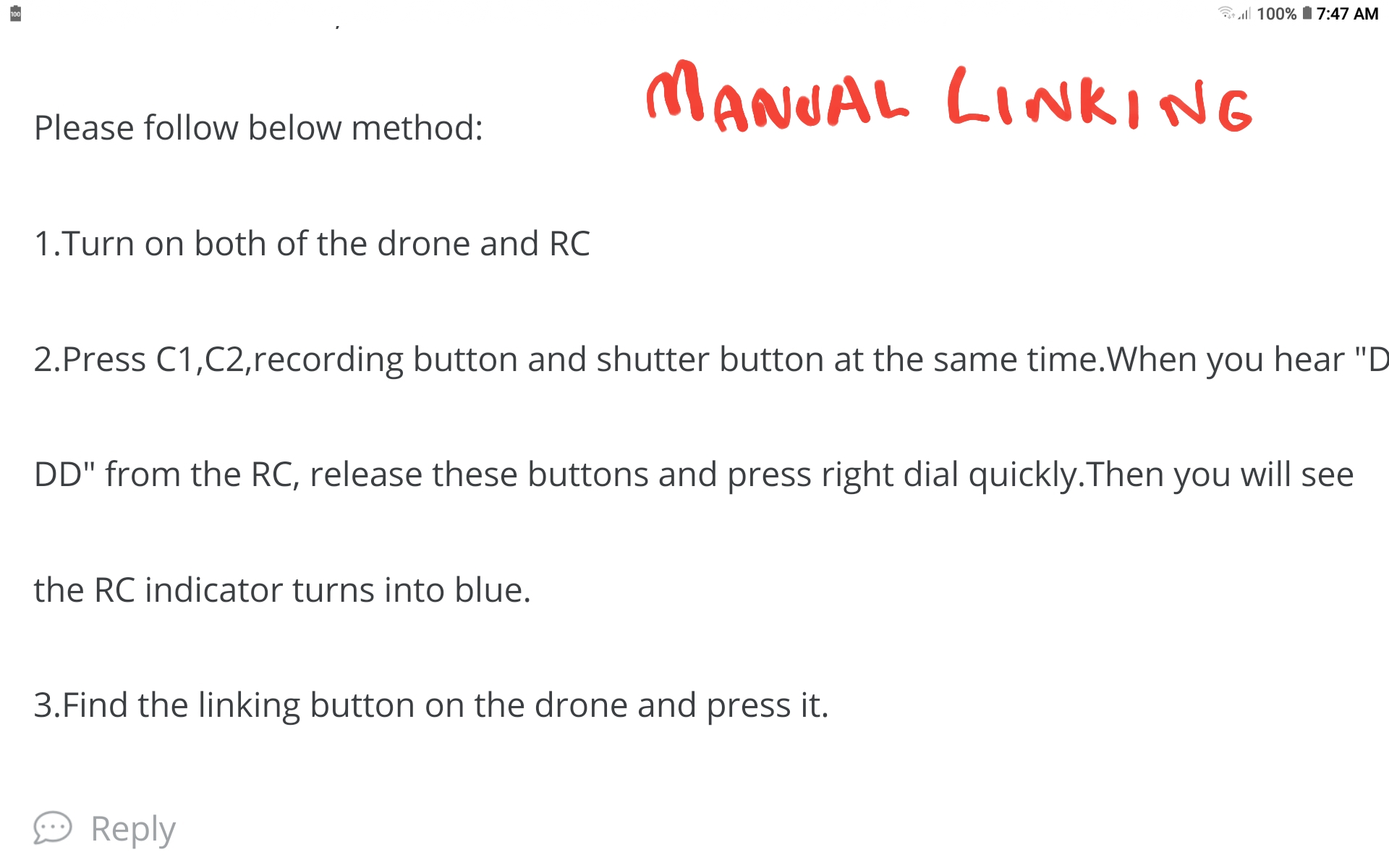

How did you try re link,,under rc settings in app ? Sometimes a manual link works

How did you try re link,,under rc settings in app ? Sometimes a manual link worksView attachment 117247
Thank you for that.
I had tried that last night.
the remote even said "remote linked" after.
but linking button on drone remains solid red, even as or after pressed.

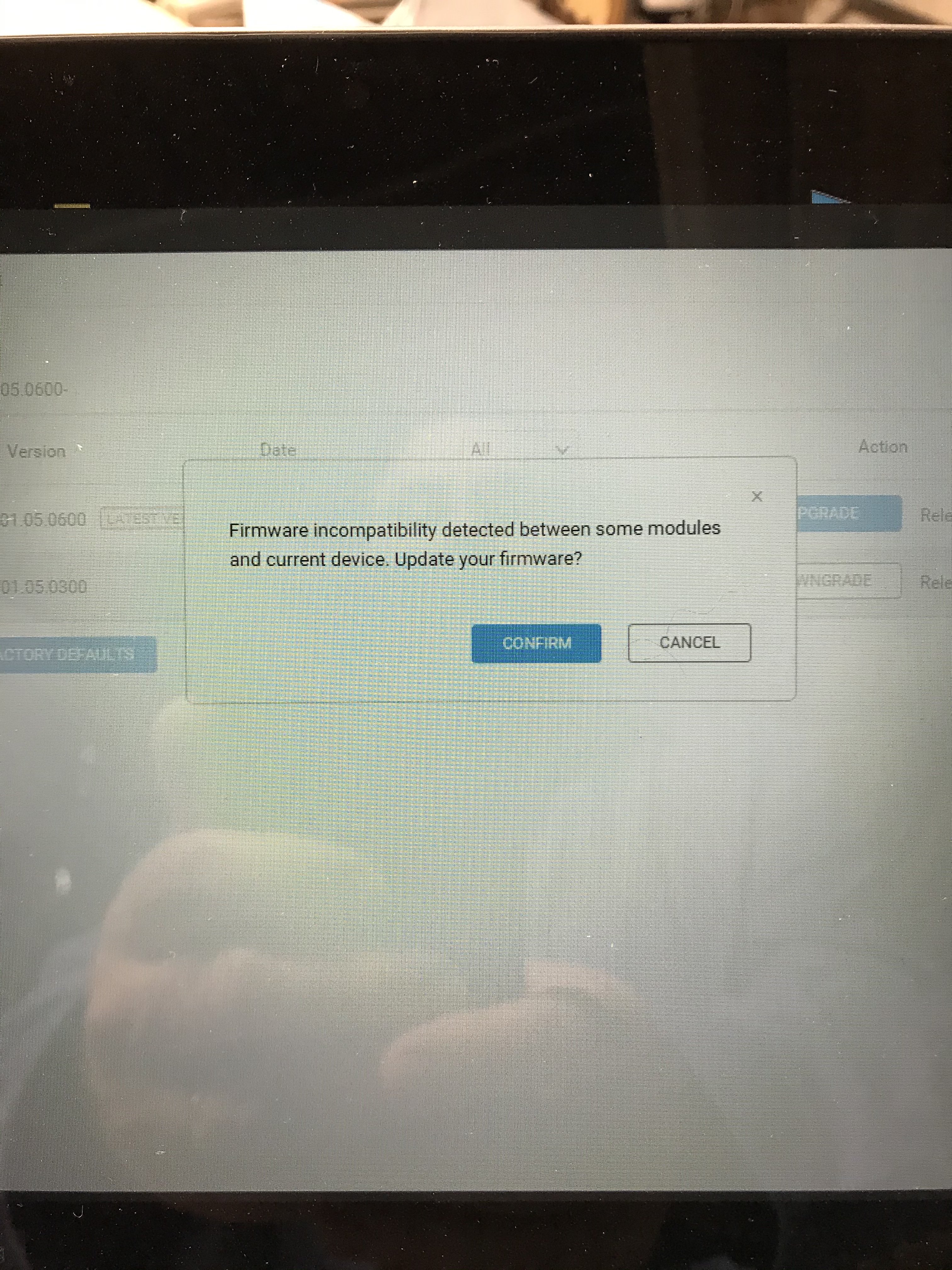

I kind of thought that also. I’m convinced if I can get it to update, I can work things through. But, the update keeps failing. I’m at a loss. This is what I see when I plug into assistant.

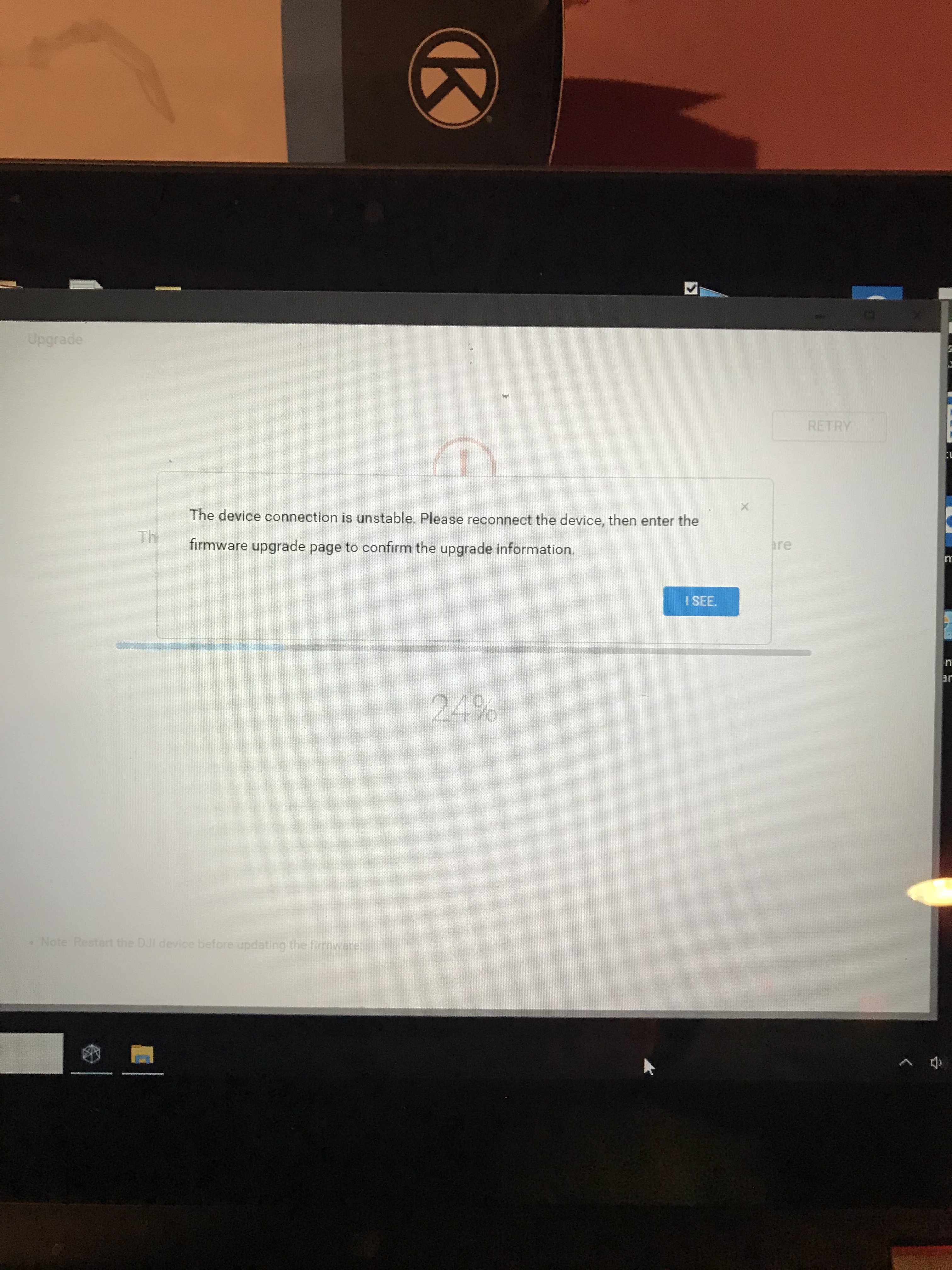

At 24%, does it stop or pause? There are some very long pauses during the update.

Did you try updating from the device when asked? What did it say to do after you hit confirm?

At 24% it sits until I get this message every time.
