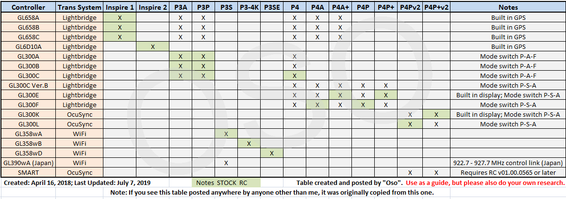

The following remote controllers are compatible with the Phantom 4 Advanced:
For future reference, here is Controller Compatibility Chart that I put together a couple of months ago.
Note that some combinations require you to select the correct AC in the app's Advanced Settings > Remote Controller Type drop down menu. Cheers!
Note that the above table has been copied and the data used on some other drone help sites. If you see them, they all trace back to the table here.

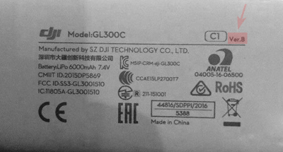

You've probably already researched this, but to help any future readers of the thread it is easiest to identify the RC model by simply looking at the label on the back.
In the case of the GL300C Ver.B, you will see the Ver.B shown as in this photo:

For future reference, here is Controller Compatibility Chart that I put together a couple of months ago. Cheers!
