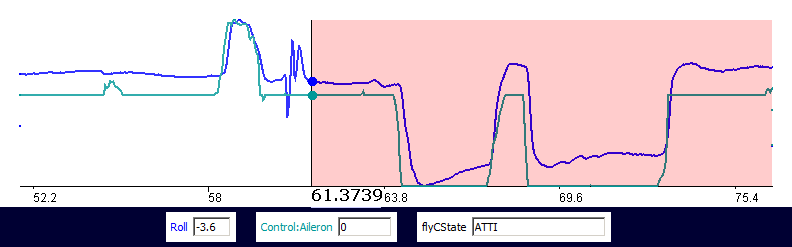

This one seems to be different than other in flight compass errors. At least different than the ones I've seen and have hard data. In this incident the P3 was flying opposite the stick input after the compass error and subsequent switch to ATTI. The other flights that I've looked at has the P3 switch to ATTI but still being controlled by the stick inputs.

But, it was you who pointed out that the P3 was moving opposite the stick inputs. At least that's what I thought you were saying :). Up to then I was thinking ho-hum, another inflight compass error with no adverse effects.

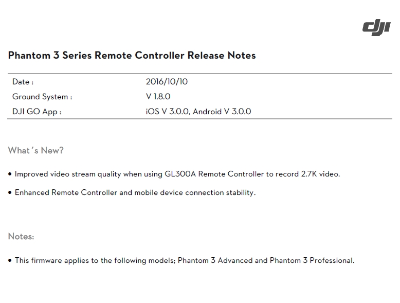

Maybe it's possible he has a GL-300A R/C, and if so he might be one of the reasons dji recently put a update that focuses on that particular R/C? If he doesn't have the 300A then what I just mentioned doesn't mean anything. I have that R/C myself, but I don't update to the newer firmwares. I have a feeling they have ran into some kind of issue with the GL-300A's and the more recent firmware.
Frank
I do have the 300A controller, but I've had no problems (to my knowledge) with updates through the Go app. My controller version is 1.8.
Did you get this controller update installed?

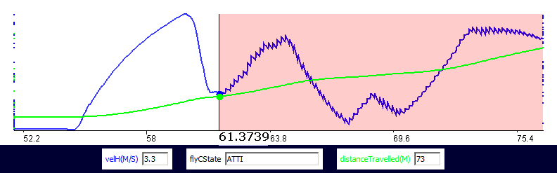

I had stated that the P3 was moving in the opposite direction as that commanded by the aileron.The aileron had moved 100% left yet the P3 was flying right. Although that's technically true there is more to it than that. I had assumed, without looking closer, that the motors were be commanded to move right even though the aileron was 100% left. This is total nonsense.
When the switch to ATTI came the aileron was neutral and the P3 began to drift ,gaining speed until 100% left aileron was applied at about 63.8. As a result the P3 rolled left 20 degrees and the P3 began to slow down. In fact, it had almost stopped at 67.4 when the aileron was released and the P3 began to drift again
It's hard to tell without being there at the controls but it does seem like the P3 should've responded faster. I.e, should it have slowed down faster. What are the sensitivity settings? Seems like every version of the Go App is different but look in MC Settings-> Advanced Settings where you'll see things like Gain, Sensitivity (or Stick Filtering).
