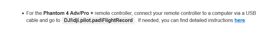

If you follow the link below, the instructions are there to get the file you need. The logs are saved to your device automatically as a .txt file. Basically in your case is like this:

My misunderstanding... I know how to get the logs... I didn't notice that when I clicked on your link "Your Flight Log" (so the file was readable/viewable) it actually took me to the dji site. I incorrectly assumed it was downloaded in the viewable version. Sorry for my misunderstanding
