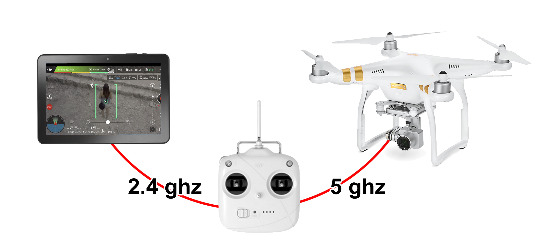

The SE is an unusual Phantom - there is no other Phantom quite like it.
The SE pilots in Europe claim that 5G is the default. They also claim that the freq between the controller and the mobile device is the opposite freq meaning 2.4 g would be the default for that connection. They also complain bitterly that 500 meters is the most they can get.
So if you choose 2.4 ghz in the wifi section of your Go app, your mobile device will need to receive 5 ghz wifi.
Maybe your problem is your mobile device is not set to receive 5 ghz wifi? Check the settings.
You also might read some of the threads in this SE forum.
Good luck.

So, if you want to change the above situation, then you need to install an app on your phone / tablet that will prefer to connect to 5GHz Wifi networks instead of 2.4GHz networks. Before that I found an Android app: Wifi 5 Or is my idea too simple now?
That could be a solution. Is there an app that shows the signal from the remote control to the drone?
