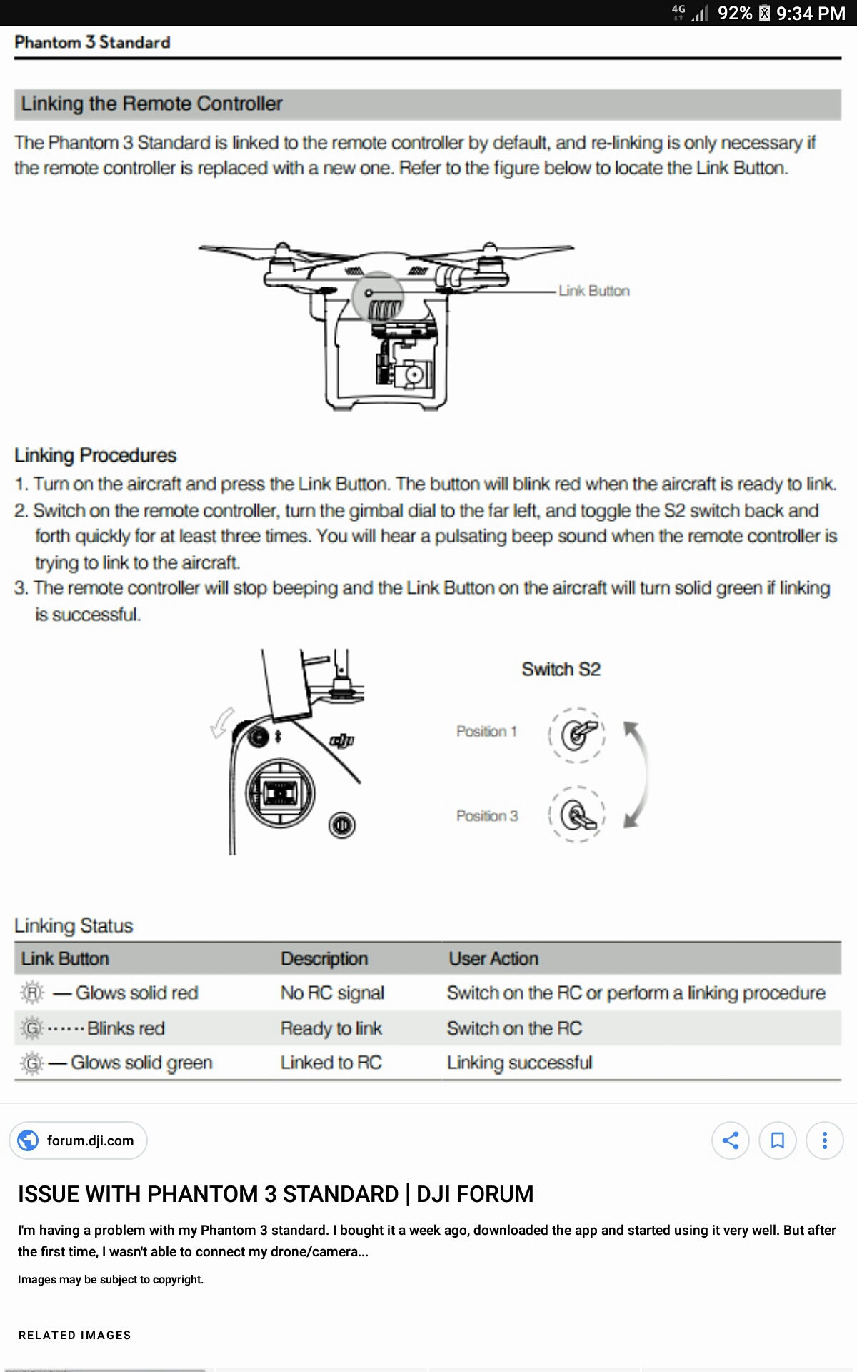

OK press should take 2 to 3 sec tops,is link light on drone flashing red or solid ? Remote will be green and red corect,,I just tryed with my remote when I was linked I unlink it by pressing link button,,it flashed red,I then held gimble wheel to left and switched s2 which 3 times and remote beeped I let go wheel and it linked,green,,,,I did this without app conected ,,,,also add once you press link button and let it go it will link,,it won't link while pressed in
this picture bit clearer,,,,should still be able to do with app connected aswell under rc settings ,it might be disconected but app still have settings there as long as all turned on,it then ask you to confirm frequency and press OK,,,do you get this before ? It then will beep for 50odd second till it time out,,you have that long to give it a very short press,,hope this helps you
Reactions: Ansia
Link LED stays sold RED. No matter how long I press the button.
View attachment 110686this picture bit clearer,,,,should still be able to do with app connected aswell under rc settings ,it might be disconected but app still have settings there as long as all turned on,it then ask you to confirm frequency and press OK,,,do you get this before ? It then will beep for 50odd second till it time out,,you have that long to give it a very short press,,hope this helps you
I know the procedure of linking..
during the 50 second, I can't make the Link LED to blink. So, it times out.
OK, I think you should get you mates one and see if it still linked to his craft,,if so turn all on and press link button so it unlink itself from his remote,,,,very strange this,,might need to try factory reset of remote,does your wifi setting pic it up,possibly he used different password for his drone wifi,,,it still should link with your drone so bit stumped till I wake up and search on this better
