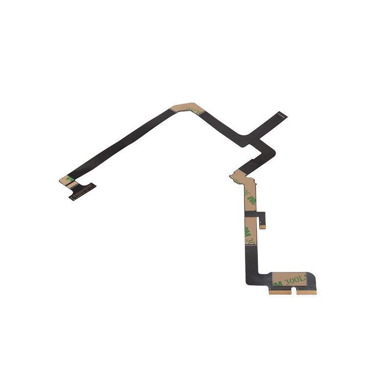

Case closed. Here’s how I solved it:
a) Later (just for once) I could get the “Camera Sensor Error” message.
b) I changed the internal flat cable that connects to the sensor to a brand new one.
c) Everything is ok now.
PLEASE BE AWARE OF THIS: this is a common problem on these cameras. The problem is everybody, even the DJI service, will try on one way or another that you need to replace the Sensor itself. YOU DO NOT. The sensor can cost you about $800. 99% of the time YOU JUST NEED TO REPLACE THE FLAT CABLE, with costs $40.

Here is the cable mentioned above.
