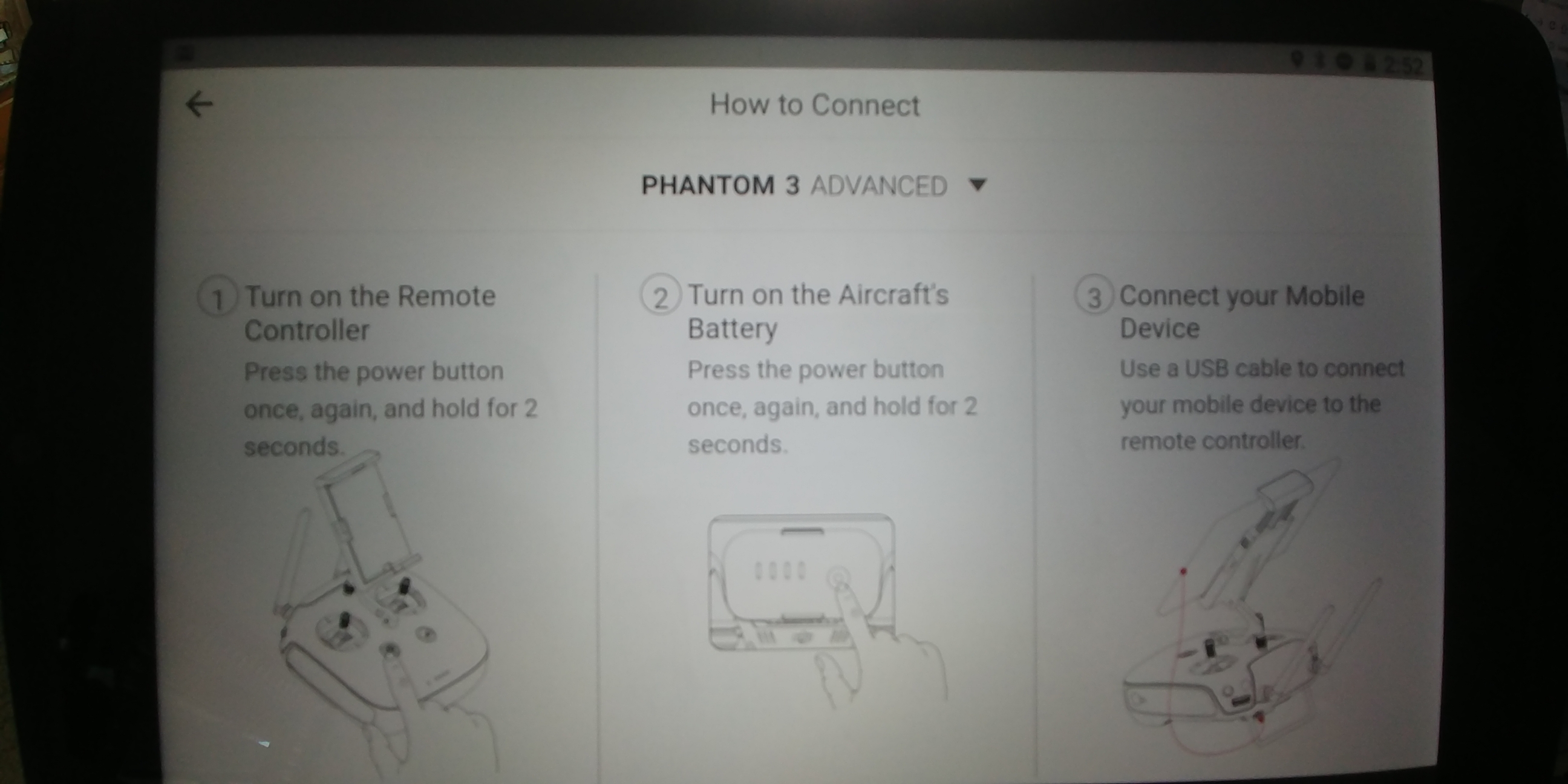

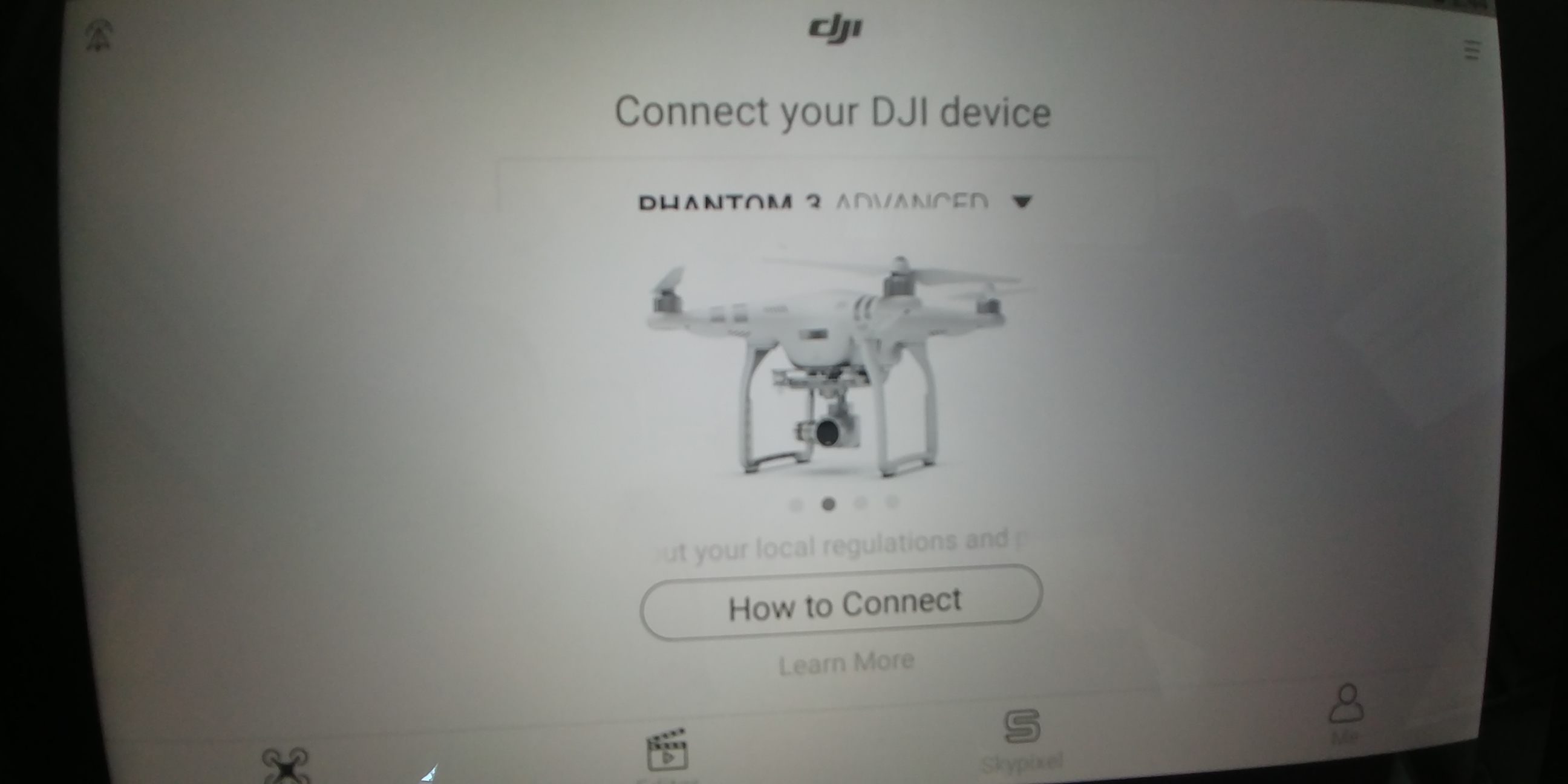

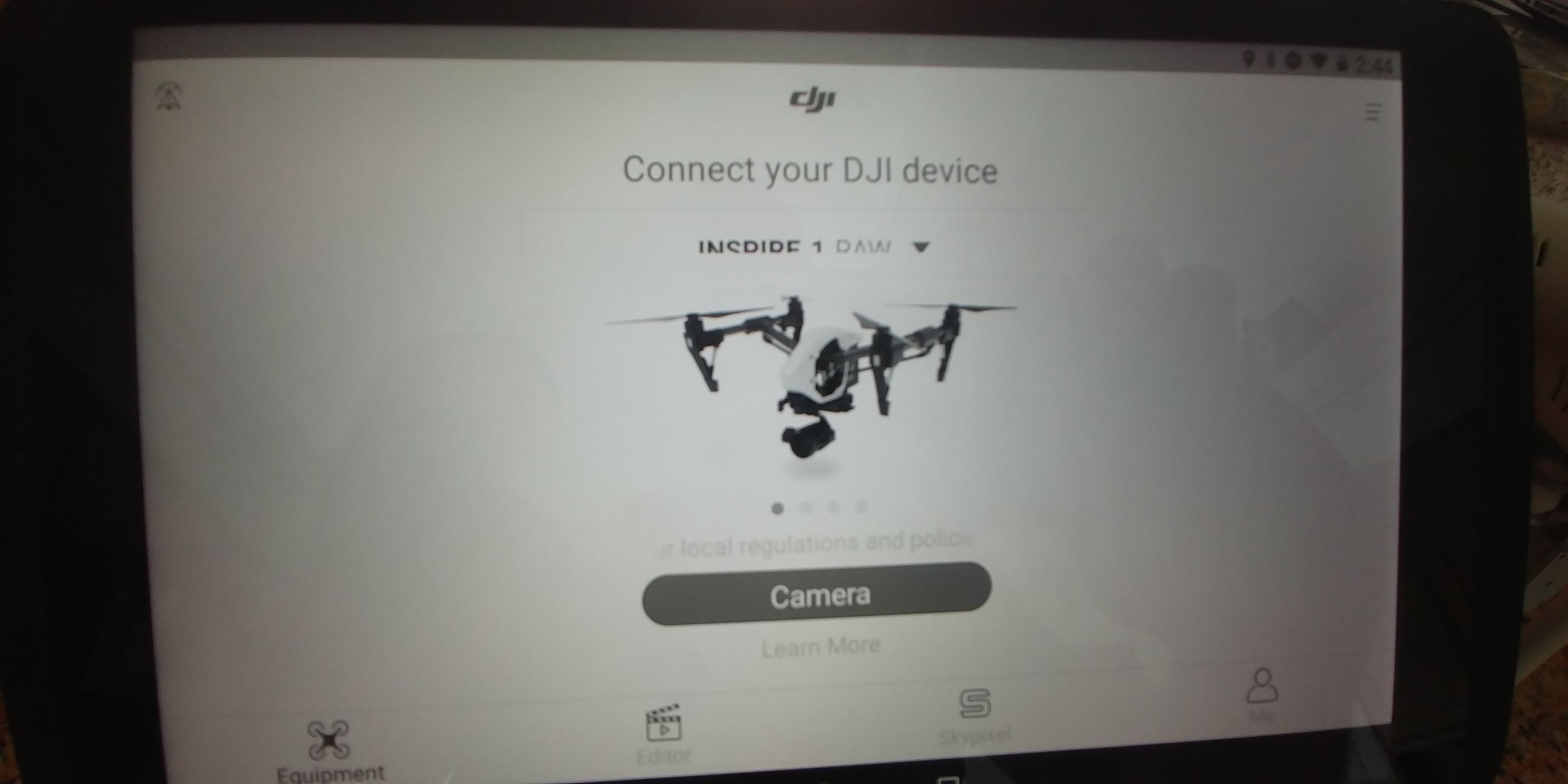

I click on go app and it comes up with how to connect and the inspire 1shows up and I scroll over to the phantom and click on advanced
I go through the process but when i go back to equipment and I can't enter camera view
Weird thing is I can enter camera view on the inspire but i can't change anything

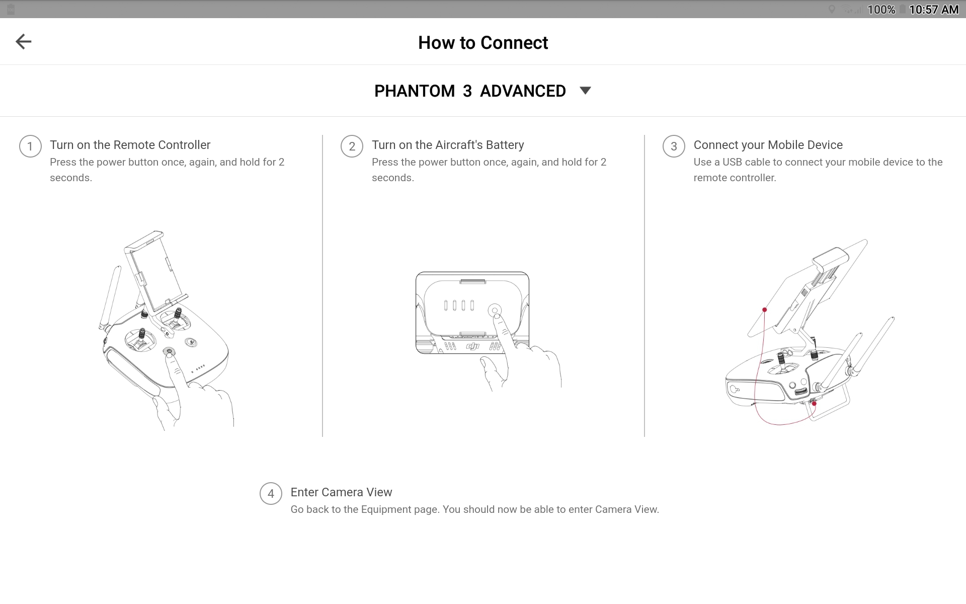

Let me see if i can do some screen shots
I not have a advance but when I conect with p4 or p3s I just click the craft and it should enter app,,,I never go back to equipment, is wifi off
Without clicking equipment button again ,,what do you get when click on how to conect

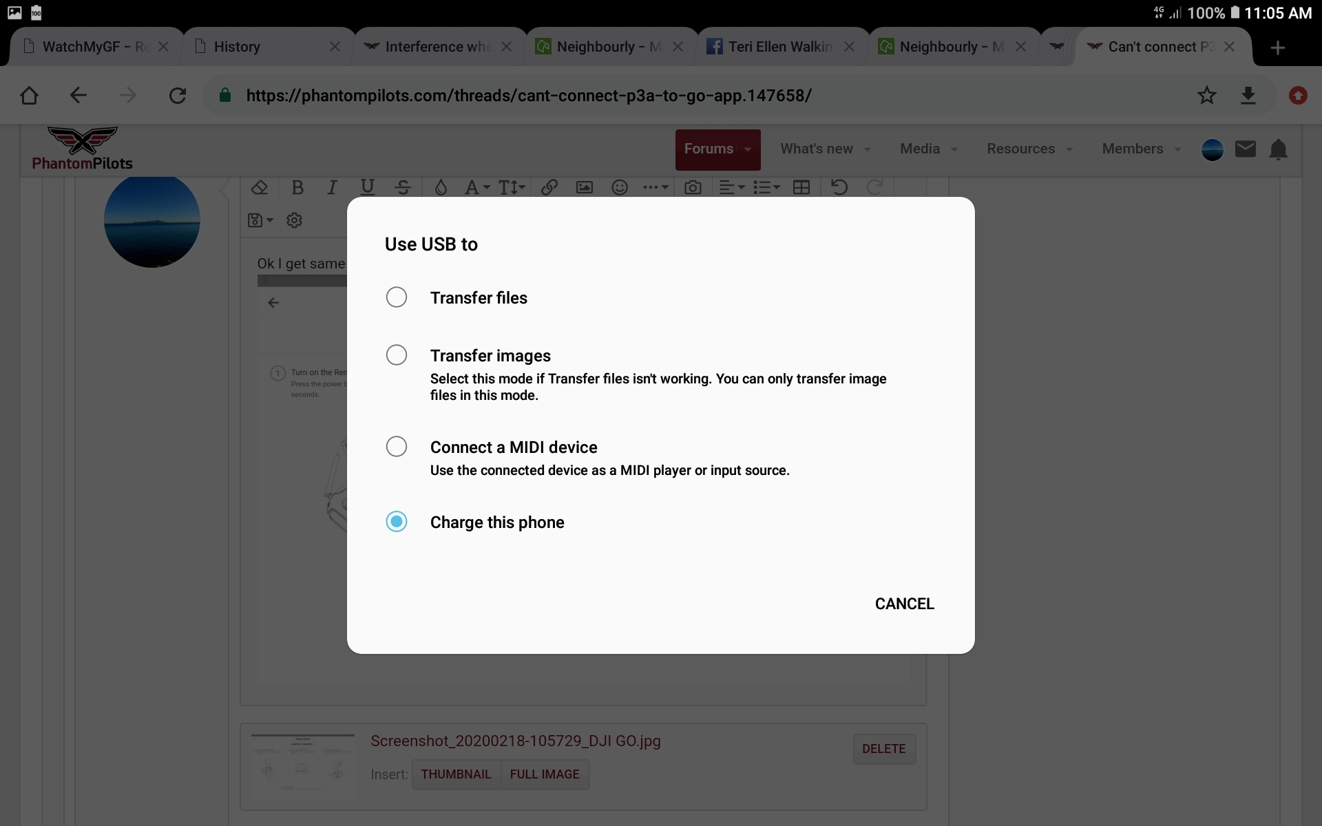

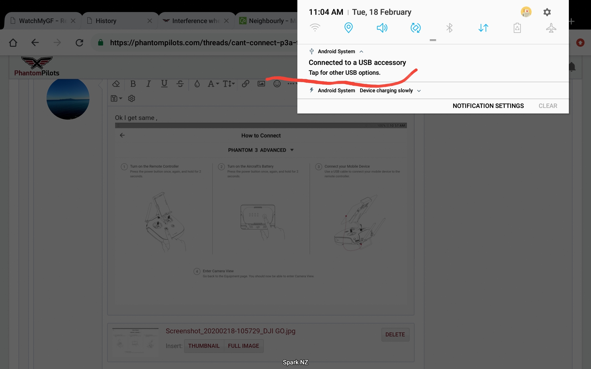

Ok I get same ,do you have a USB option when you swipe down screen,,,,when your USB cable gets plugged into device it should give you this or similar,,,strange one
Mine said "charging" too.
I changed it to the others and no change
I also tried usb debugging and tethering
I tired different phones and tablets

When you have the screen that says what would you like the usb to do. currently yours says charging. Press the connect to MIDI device button and then try reconnecting I have use the android tablet for the first time last night and this was the problem I had.
