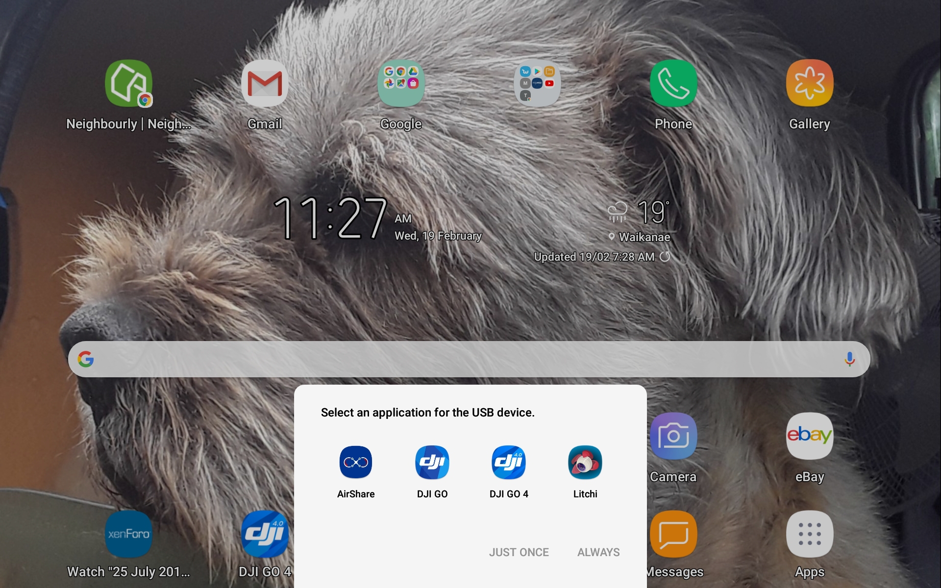

I use Samsung tab a 10/1 and works multiple apps just perfect,very surprised by this,,just the weight bit heavy,paided 600 in 2017 only cause iPads cost more ,so stuck with this,,not recommended but can take a phone call in flight aswell and just returns to app when I hang up,,this device for me just rocks,,,,hdmi update on remote
It's just weird that one tablet won't even connect where another will
