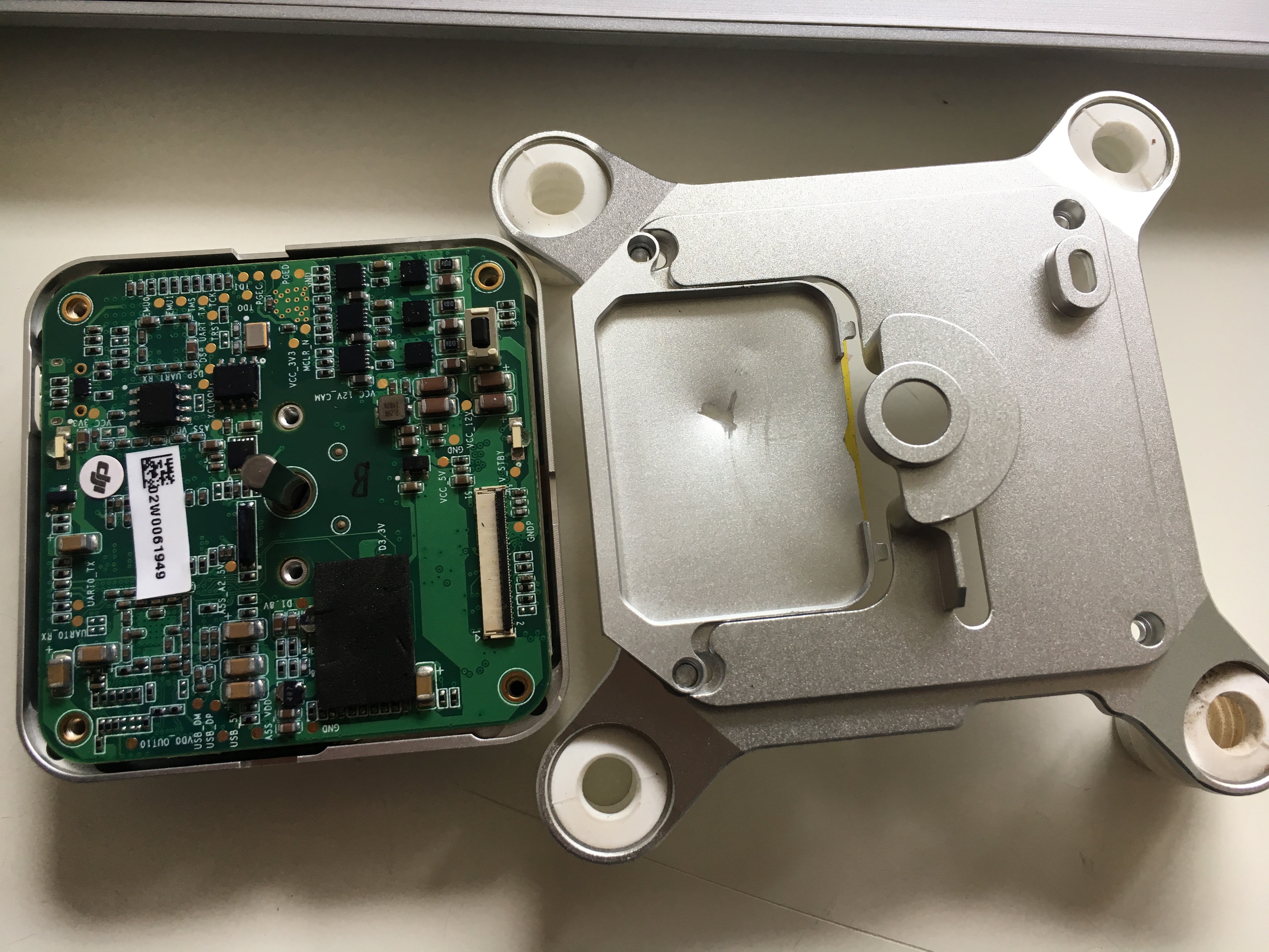

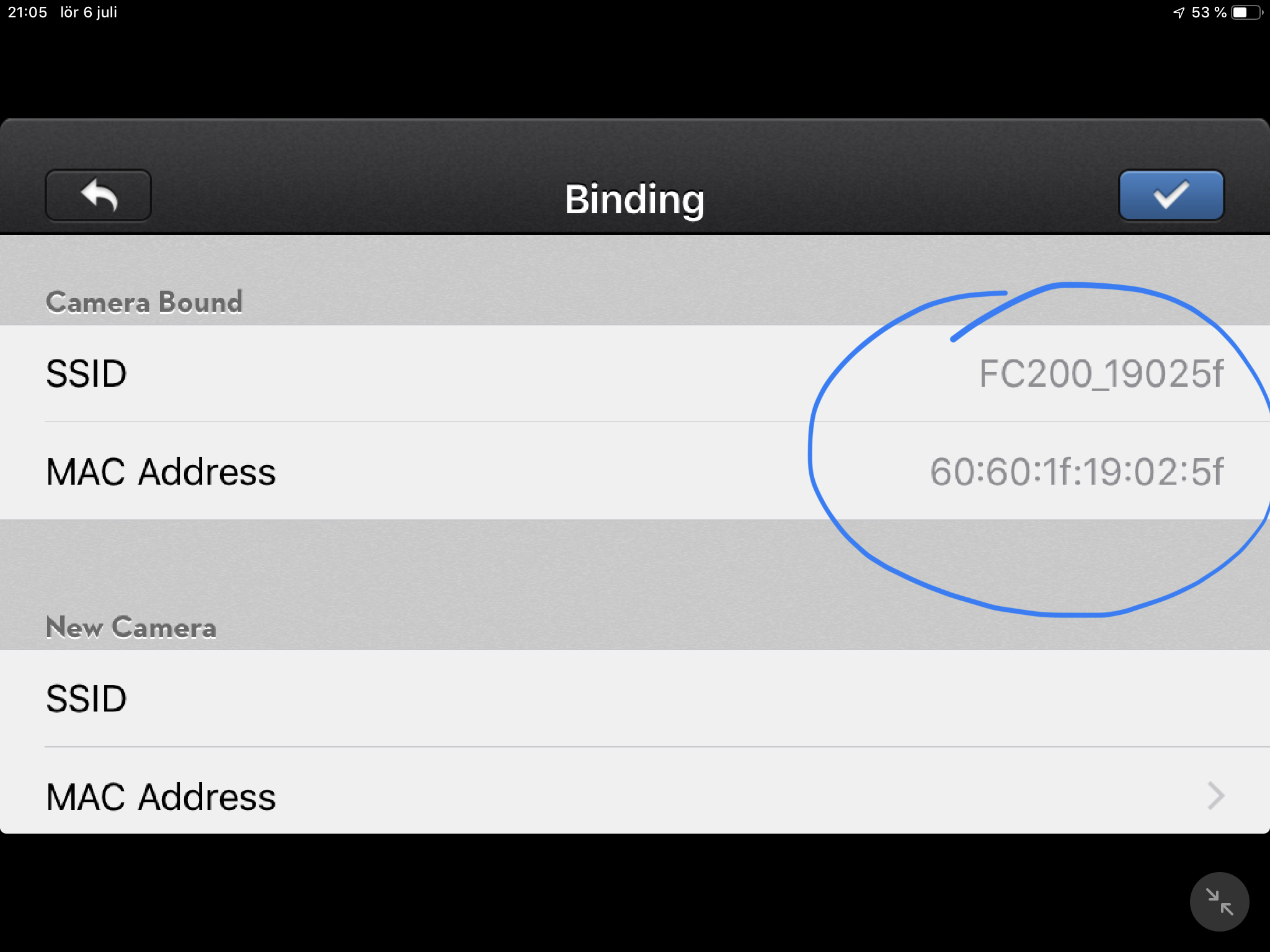

Well I took the whole assembly apart. As you can see from the attached picture, the crash might have damaged the board. When I had it assembled again I connected a USB cable from the board to my laptop, but it didn’t show up as a drive. But now when I powered up the machine I got a blinking red LED on the board, that after ~30 seconds turns a solid red...
I then took out the SD card and formatted it. Put it back and powered up, and got a green! LED for a few seconds, then turned red.
Tried binding again, this time on my iPad, and it seemed to work as it showed the right mac address in the binding dialog. But still it says connection broken.
The camera/gimbal powers up and goes level, then tilts down like 45 degrees.

No light means the camera is busted, you wont be able to get a successul binding as it needs the camera active, however it could be something simple such as a loose wire, does the camera hang limp or does it power on and go level (or slightly pointed down on the V1)
Well, I took it all apart. Lifted the top cover off the aircraft too. I can't find any loose cables or connectors.
Now it says "camera bound", but still broken connection and sometimes "no SD card".
Do you think it's worth trying a replacement board (gimbal/camera) from eBay?

it depends on the cost, sometimes you just have to let go and giveup, the boards are hard to find anywhere, might be better to find a new camera unit
