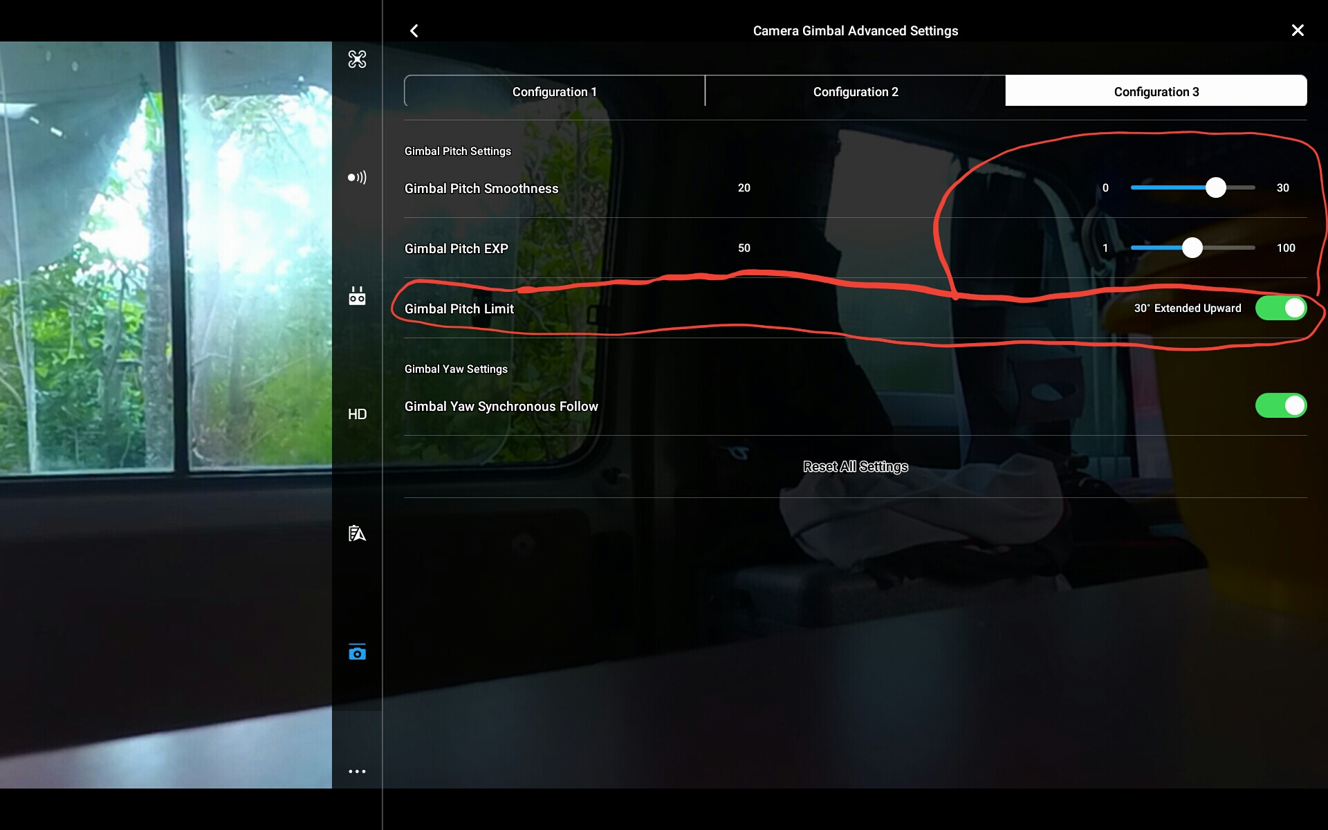

Yes p3 and p4 have gimble extention of extra 30% which means you can see props unlike normal,,you could also try buffer speed which control panning speed of up and down for smoothness see if any of these change it,,this pic p4 but p3 very similar....does it move nice when not powered on
