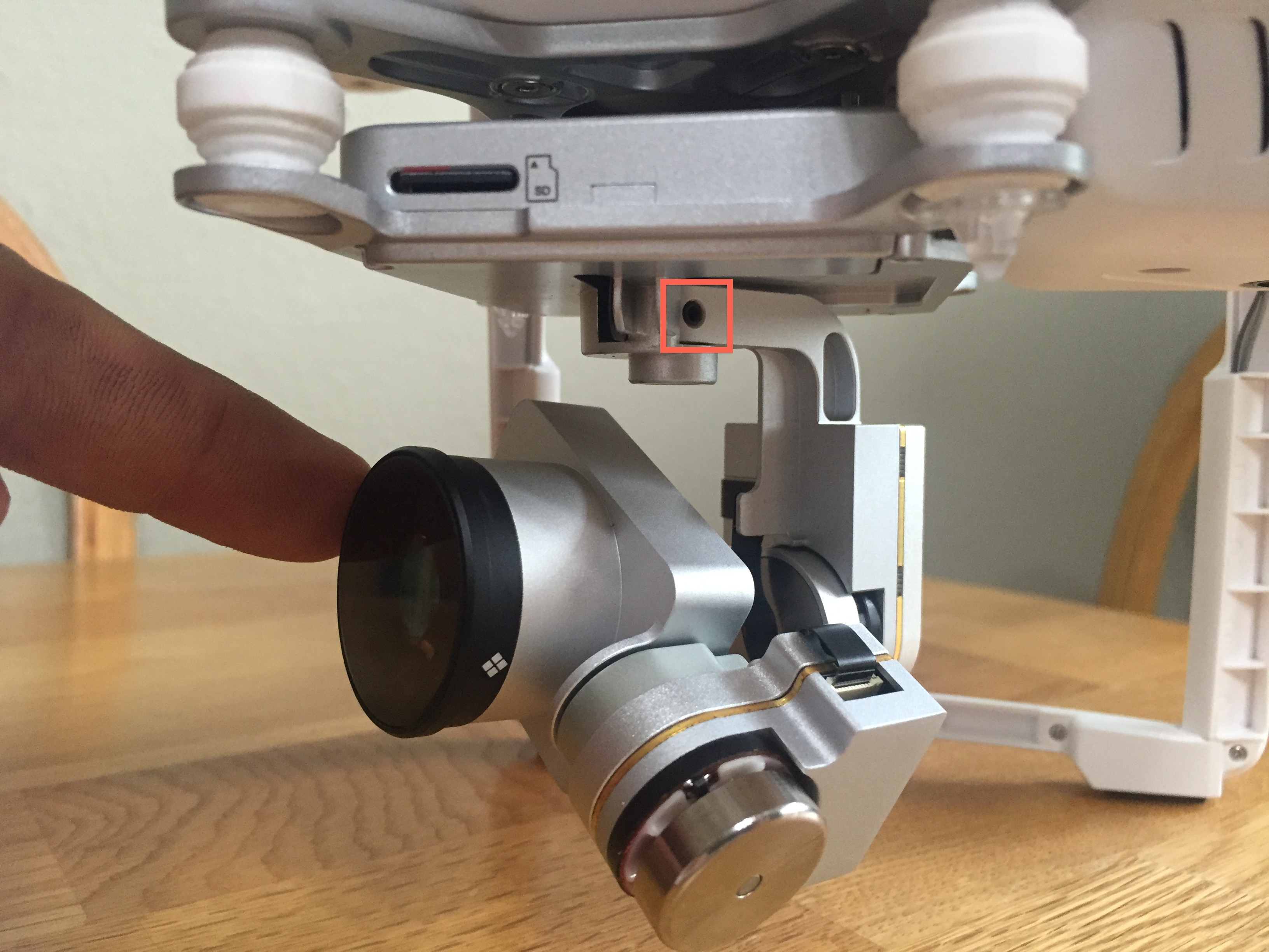

    Also, look for a hidden grub black hex grub scrub set screw located at the bottom of the yaw motor on the opposite side of the flex cable. This is known to come loose after a bump or 2.

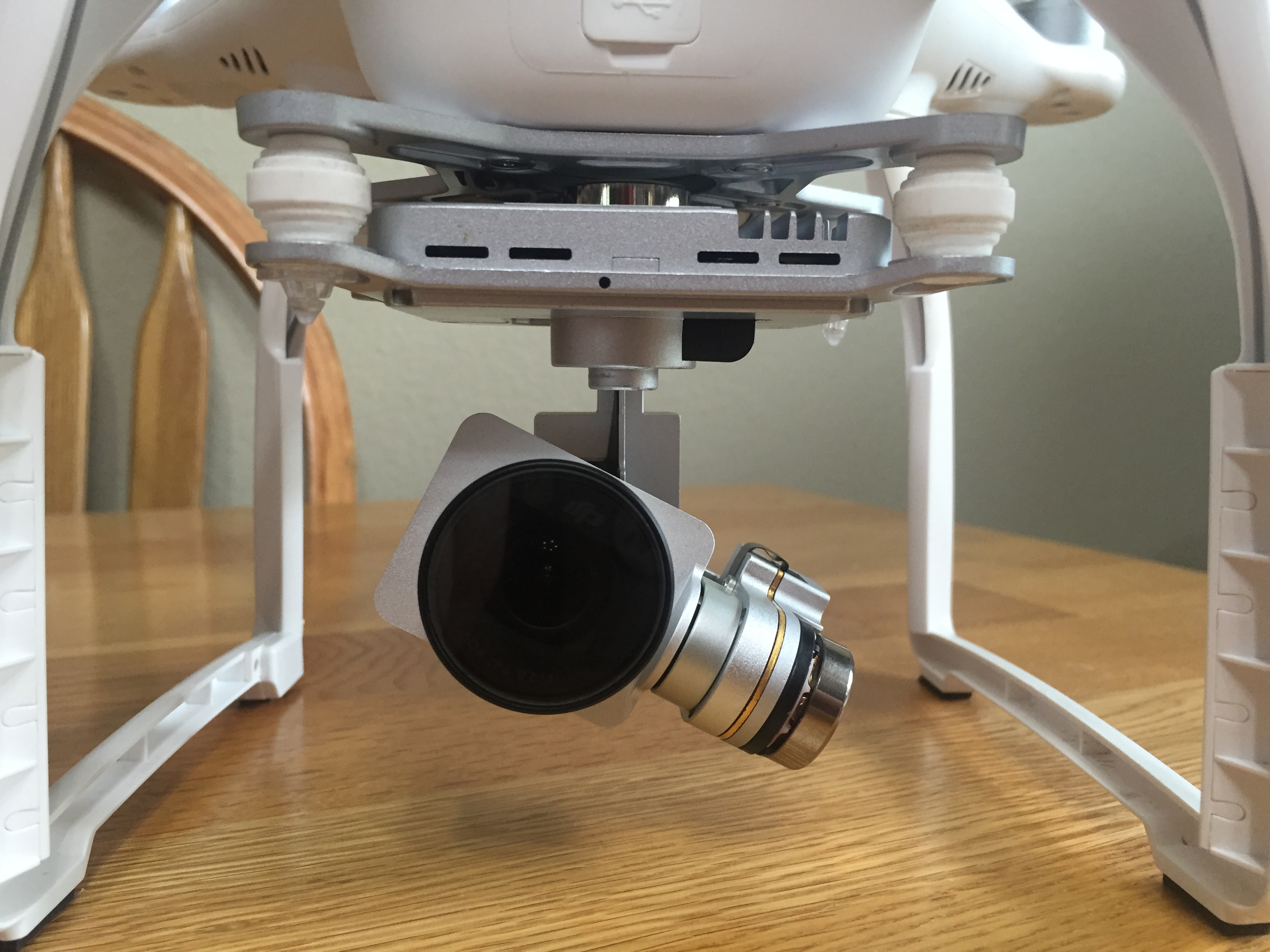

  3. Smothers12
    Jul 4, 2016
    10

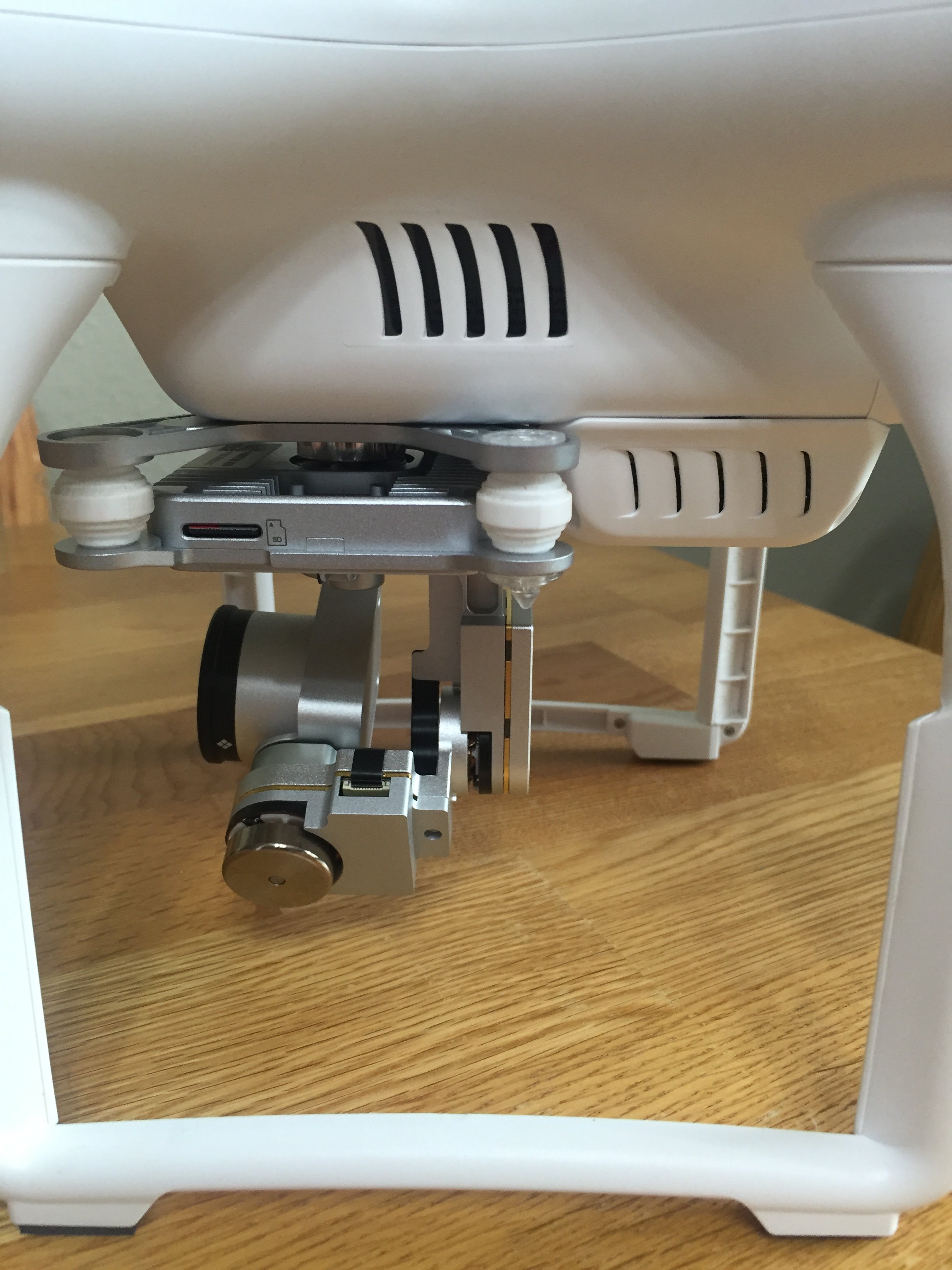

    Below are pictures of it in the off position. It does rest at an angle. If I straight it out, it goes back to the shown resting position. Is that what you were asking about?
    Also, is the set screw you were referring to the one pointed out in the picture below? If so, it is tight and not appears to be loose or broken that I can see or feel.
  4. Mako79
    May 16, 2014
    3,527
    619
    Sydney Australia
    Everything looks straight from the photos.
    Maybe someone else can see something I cant..

    Looks like you might also have some airframe damage on the left front just below the vent. Be sure to keep an eye on it between flights.
