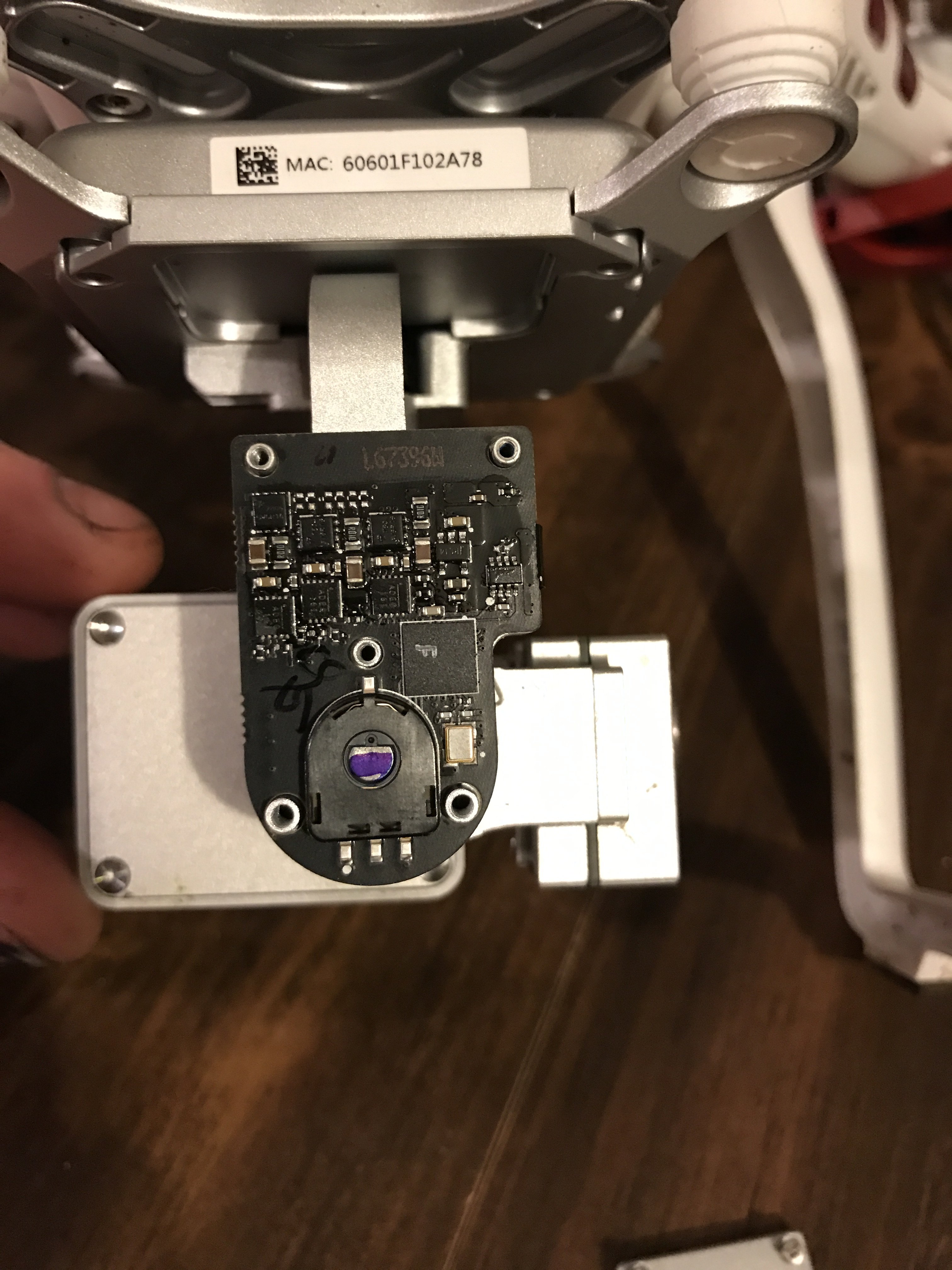

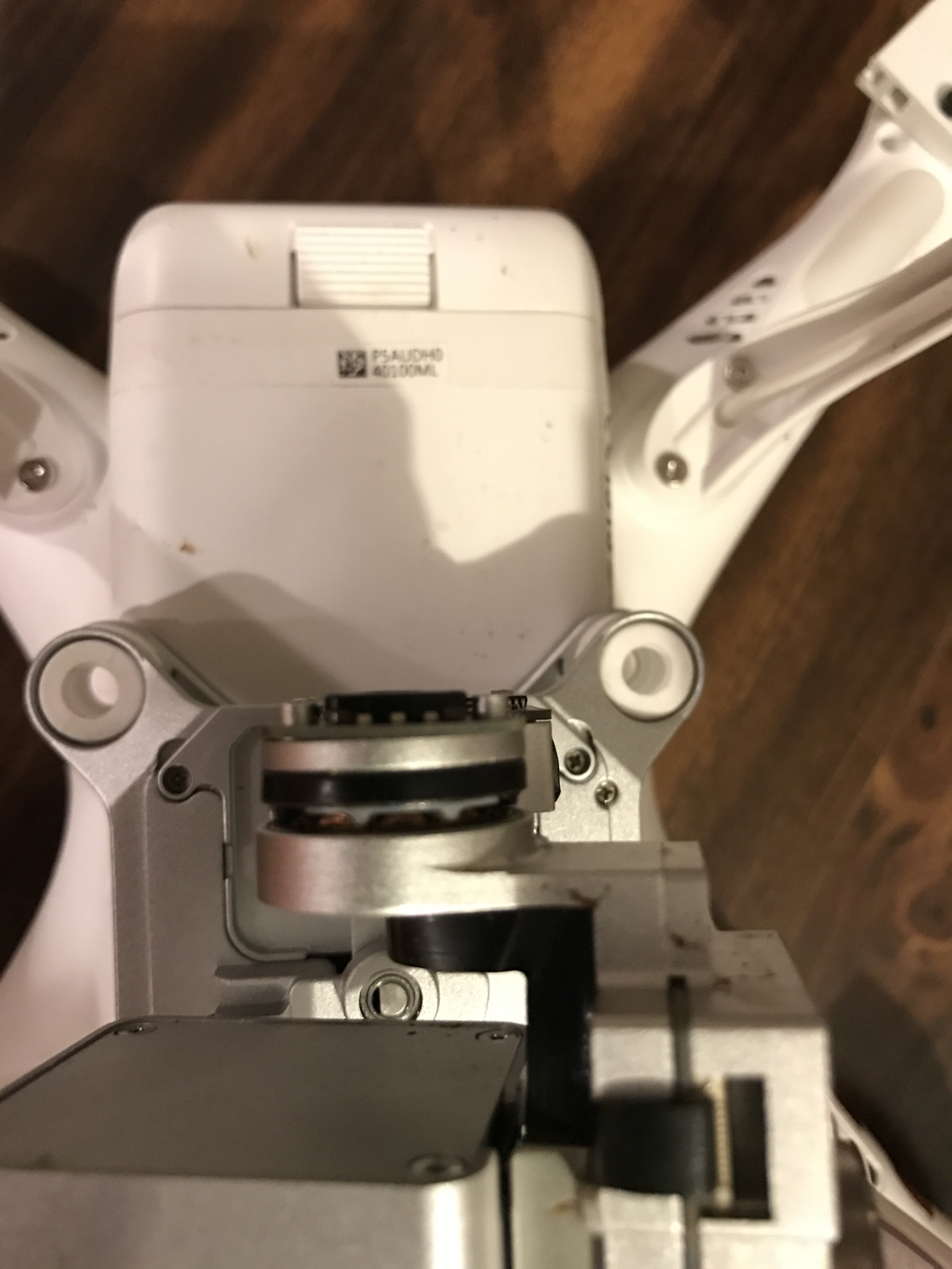

Wish I had a better introduction, but like most it seems I crashed my drone pretty early on. The camera and gimbal broke off the drone and pulled one of the camera antenna and the grey ribbon off. After repair I still have a problem of the camera panning left and right. It just won't stay in one place. No other associated errors or problems. Any idea what would cause this problem?

This is a typical yaw motor alignment problem.

Thanks for the idea. I've looked at some videos of yaw motor alignment. The D shaped post in the lower motor box is oriented properly. The captive bolt aligning the upper motor (panning motor) is also in the right place.. any guidance on how to troubleshoot this. Thanks

Thanks for the lead on calibrating the controller.
That works fine, imu, and main drone gyro calibration is fine. The P3std won't properly calibrate the gimbal though. Follow mode and fpv mode doesn't change the problem
Both motor shafts with the D shape are in alignment and locked into place. It seems like maybe a circuit board is sending a bad signal telling the camera to pan left and right to find the proper straight forward position.
