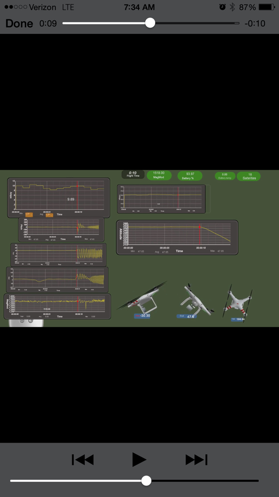

In the above picture I paused the playback right at the start of the decent. You can see in the middle picture the phantom banked hard right. In the left picture you can see the phantom nose went down. This matches loss of lift on the front right corner, which matches the corner that had the only intact prop found detached.
From the video in post 140 it is pretty hard to make the props come off and McVentures said he did finger tight. I think if the torque was that critical we would see this all the time. I think something caused that motor to stop. Maybe not motor failure, a logic or esc fault perhaps, who knows...
Bringing back an old post but tested the new DAT converter with motor RPM data :
New version of .DAT converter | DJI Phantom Forum
Below video made in Dashware including RPM charts for each motor.
If you look at the motor RPM Right Front Chart you will see RPM go up to 10000 just prior altitude loss.
Thats the prop flying off.

That's cool. I wonder if the RPM is actually measured or if that is calculated based on a command sent from the flight controller.
The data to me looks like commanded because at the start the RPM numbers are exactly the same for all 4 motors.
I'm almost sure that the motor speed data is commanded and not actual. Also, 10,000 isn't necessarily 10,000 RPM. It's just the max value. I.e. there is probably some constant such that RPM = constant X measured value.
