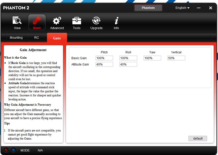

Here are the gain settings for my P2.
Thoughts?
Seems the only thig I really changed was the yaw. And then I added a slow yaw switch I got from a member that’s not here no more but can search for slow mod and read about it. Most you want to know is here if you will search but is old post. Not many are into P2’s anymore but it’s all here if you take the time to use our search feature.

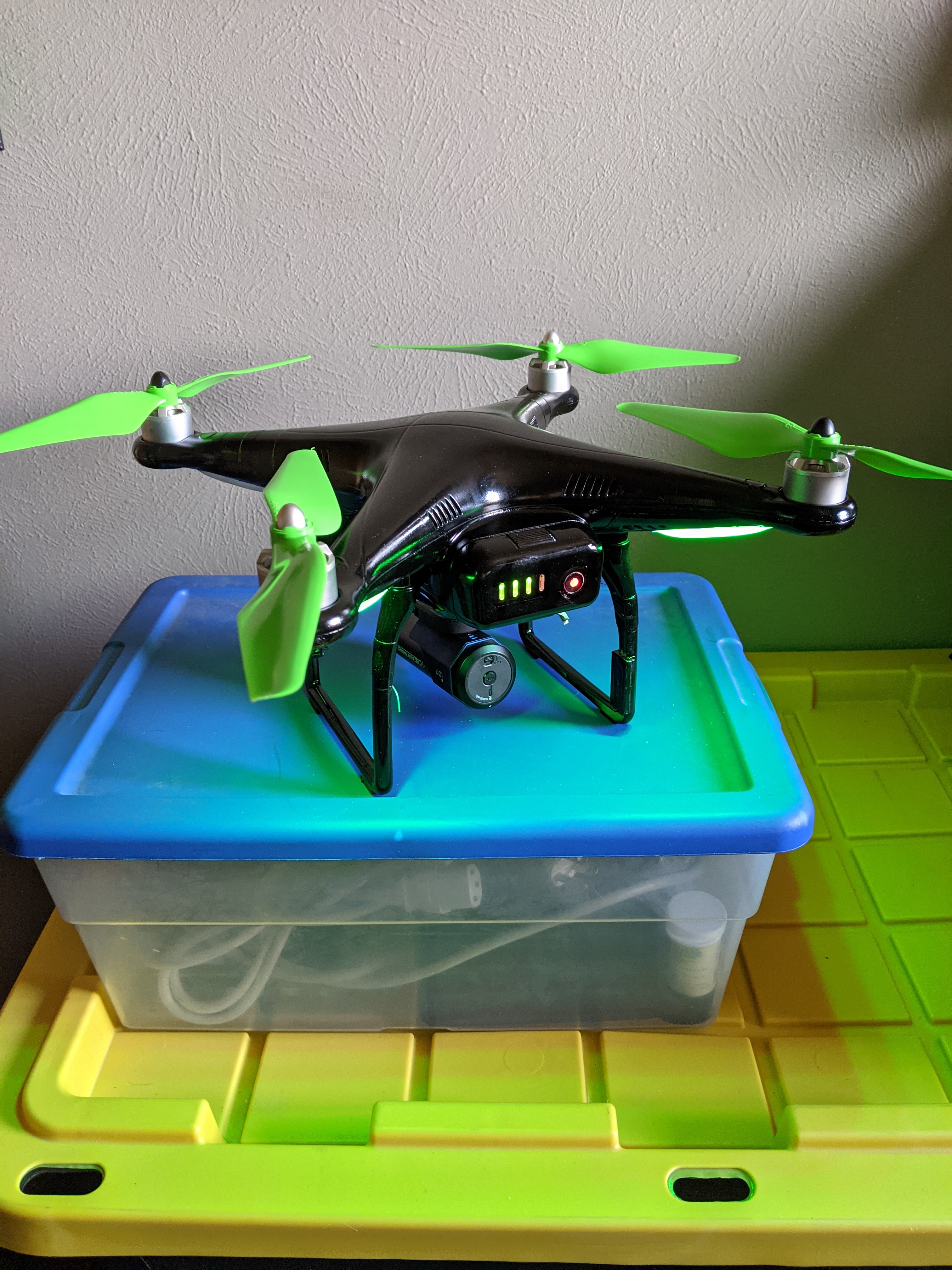

I found that the P2 had a bent arm. Bought a new shell at $53 and it works OK now, not great.
