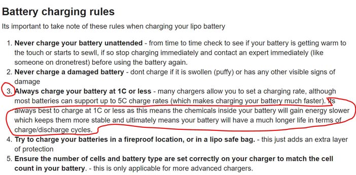

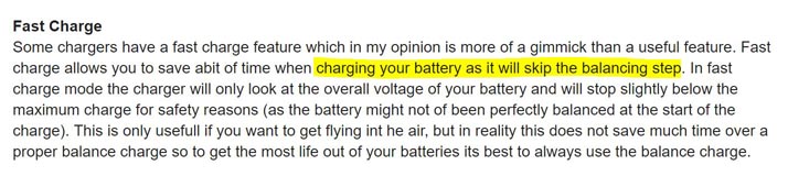

Is this 3rd party charger , charging the batteries at the same rate and temp as the genuine DJI charger ?
Fast charging at a higher temperature could reduce cell life
Reactions: Neon Euc
Fast charging at a higher temperature definitely impact cell life. It is unlikely to be an issue for Neon however. The charging circuitry is Pachaged with the so called “smart DJI battery”. You could attach a power supply capable of charging the pack at 100C but the battery cells will be charged no quicker.
Fast charging at a higher temperature definitely impact cell life. It is unlikely to be an issue for Neon however. The charging circuitry is Pachaged with the so called “smart DJI battery”. You could attach a power supply capable of charging the pack at 100C but the battery cells will still be charged at the same rate as with the standard power supply.
Reactions: Neon Euc
@lannes, The last part you highlighted in yellow doesn't applies to DJI batteries, only dumb batteries. The smarts in DJI batteries won't allow anything greater that a 1c charge rate, and charging slower than 1c is OK. DJI batteries always equalize with any charger that provides adequate voltage. That's part on the onboard smarts in each battery.
