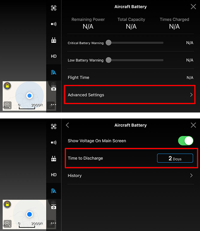

I still don't get the auto-discharge feature as it would demand some sort of discharger which means something to transform or dissipate the stored energy, but anyway if DJI says it does discharge itself then all the best. I've set mine to 10 days so I can manage discharge myself in whatever manner, but that's up to the each one. Either way, LiPOs do lose charge slowly over time. Even hours, if your LiPO is left at 100% it won't be 100% at take off, so I don't get paranoid. First "loss" is (usually) higher and quicker, then it slows down and after a few days it will lose around 3, 4 or 5% at most. Still fine to fly in my book, I always did with every battery and still do with DJI's.

Do you know anything about the battery history part of the DJI Go application? I can open it up but darned if I can figure out how to get a battery added to the inventory.
