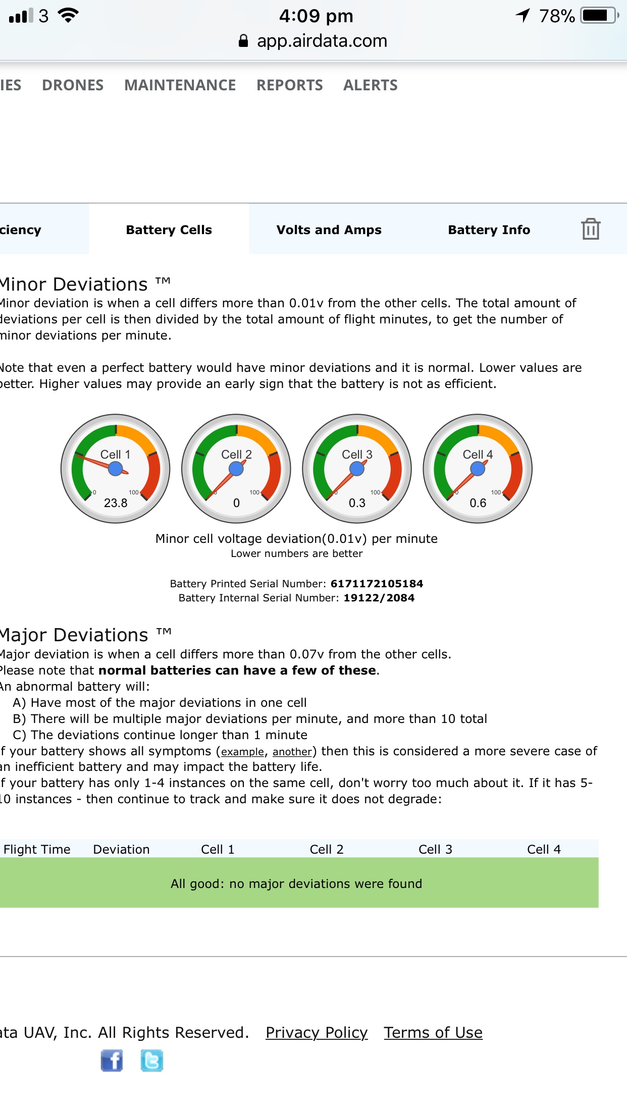

So I’ve come this far [emoji51] I took her up she was flying fine 50 % battery lasted saying that for at least 4 minutes without going down so started bring her back in landed her at 27% and then at 20 % recharge her again after letting the battery cool obviously full charge again the battery was fine all the voltage was fine in my dji go app but after landing uploading my stats on UAV site
I got this look at picture

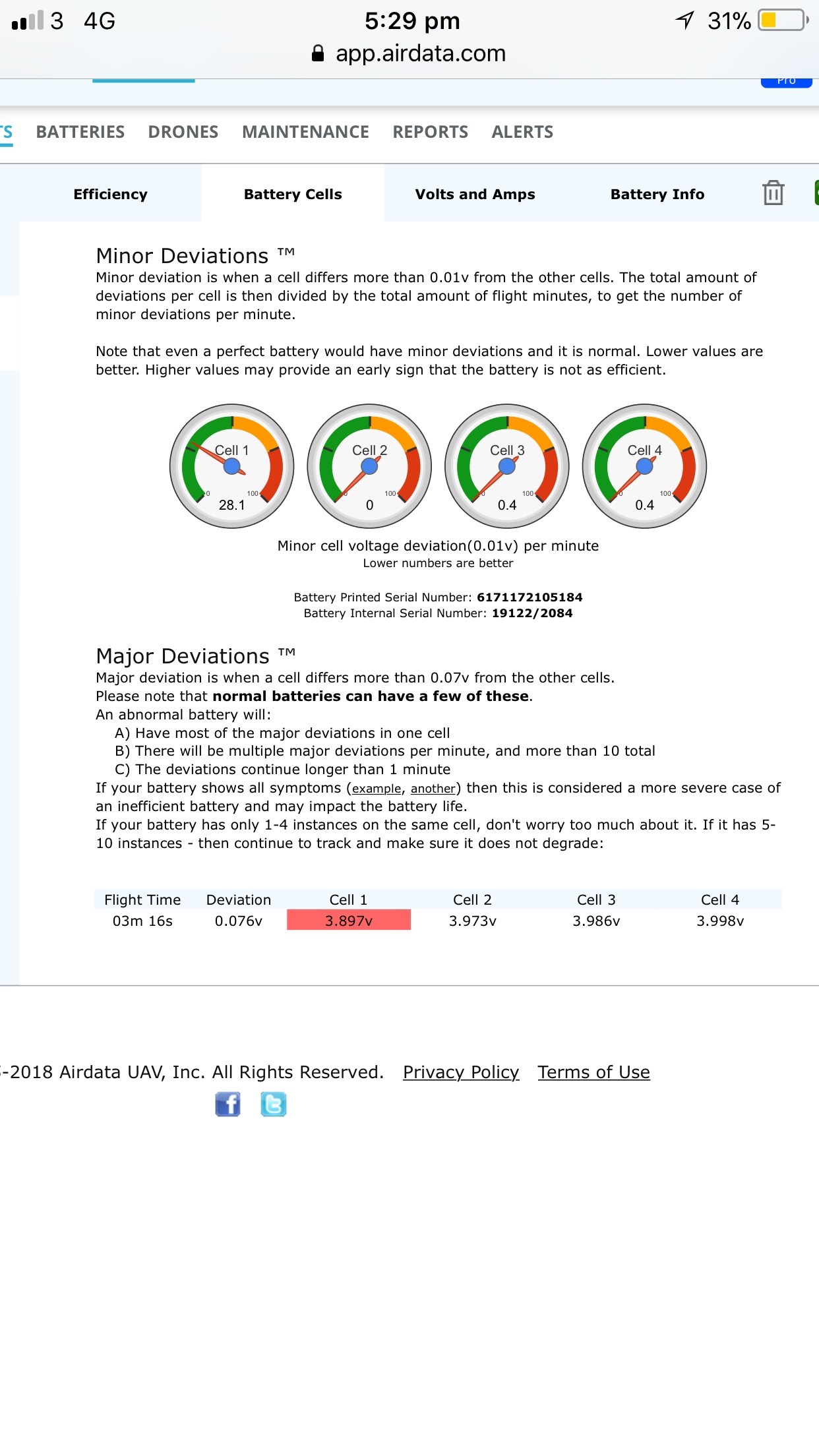

And today’s flight
Not sure what I’m meant to take from this is my battery fed ???
The bit where you said it was 96% then 50% just by warming up is not good. Surprised you even took it for a quick flight lol. But I would keep that battery just for doing firmware updates and wouldn't fly with it. You bought it 2nd hand and no signs of damage from a crash? All good, but..... What if it was water damaged ? Hard to tell for sure. I personally wouldn't risk it in all fairness
The scary thing is, it may stay at 50% for ages in mid air but the actual battery may actually be at 5% then it would drop from the sky.
