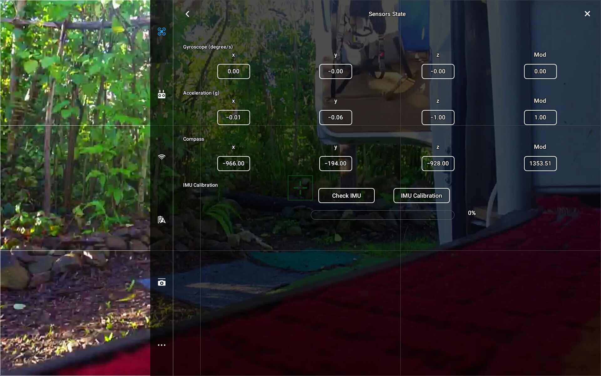

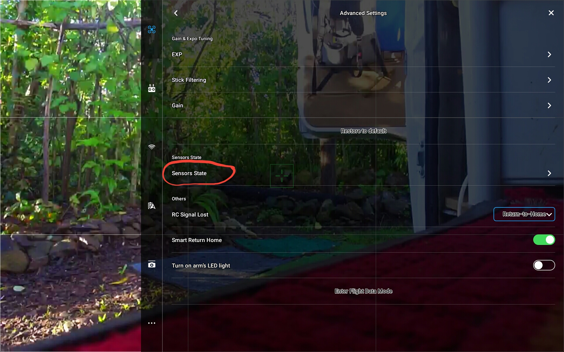

Ok. Guess my first question is, is this possible on P3S? Where do you look for that? Is it in A/C settings from setup screen? I'll throw mine in the freezer!
Brad
Brad
Under advanced settings,,,has compass and imu here,,,I put mine in fridge ,crazy but does work
