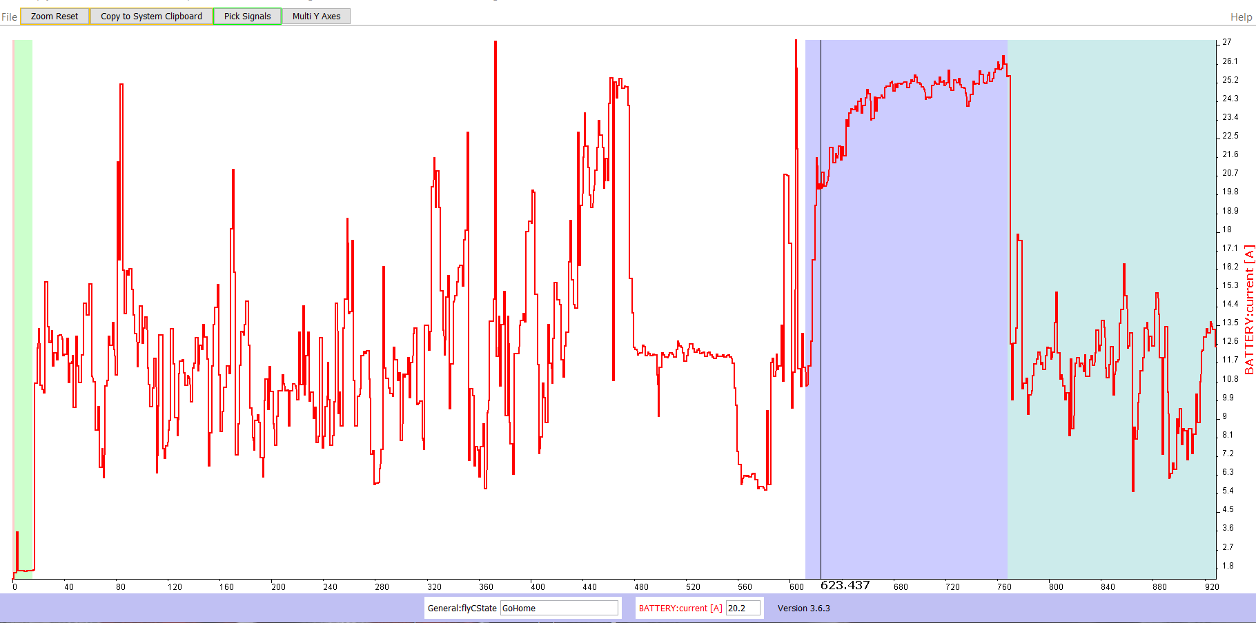

This is what where my concern is. Again looking at the full flight data. Over 2 min of 20amps plus. This is not normal. The contacts should handle the 20+ amps for a short duration which is normal, but not for the extended period as in this flight.
If 5.8Ah does a 27min flight down to 10% remaining capacity that’s 11.6A average current draw. That puts our 20A at less than 100% above average rating. Should not be a problem at all abscent poor system design.

20A isn't excessive (even for a prolonged period) having regard to the average current draw of the P4. To the extent it might be DJI failed at the design stage when the connector was specified.
If it could be determined that the P4 can't maintain a 20A load for any operating parameter by design then you would have a good case for suggesting the 20A load was in part attributable to the poor performance of the connector. What we do know is it melted, melting requires heat the source of which in this case must be a poor electrical connection. Gets us back to poor mating (not fully inserted), insufficient current rating for purpose, corrosion or weak pins but more likely the compliance of the female terminals (spring tension).
If the connector was failing during the 20A depicted loading we can be confident at least part of that load would relate to the power being dissipated in the poor connection. We can see the connection failed from the physical damage, the logs don't contribute much here.
As I mentioned in Post#5. The aircraft data may give a bit more. Personally, I have been attempting ( To little avail ), to determine the numerous P4 shut down issues and common instances. None of which have been any where near conclusive. There have been only a few that I know of that had "physical" evidence of said shutdowns. This particular flight as well as the previous image from another were very similar ( The first was a mid air shutdown, this one was not ). Coincidence? Maybe.

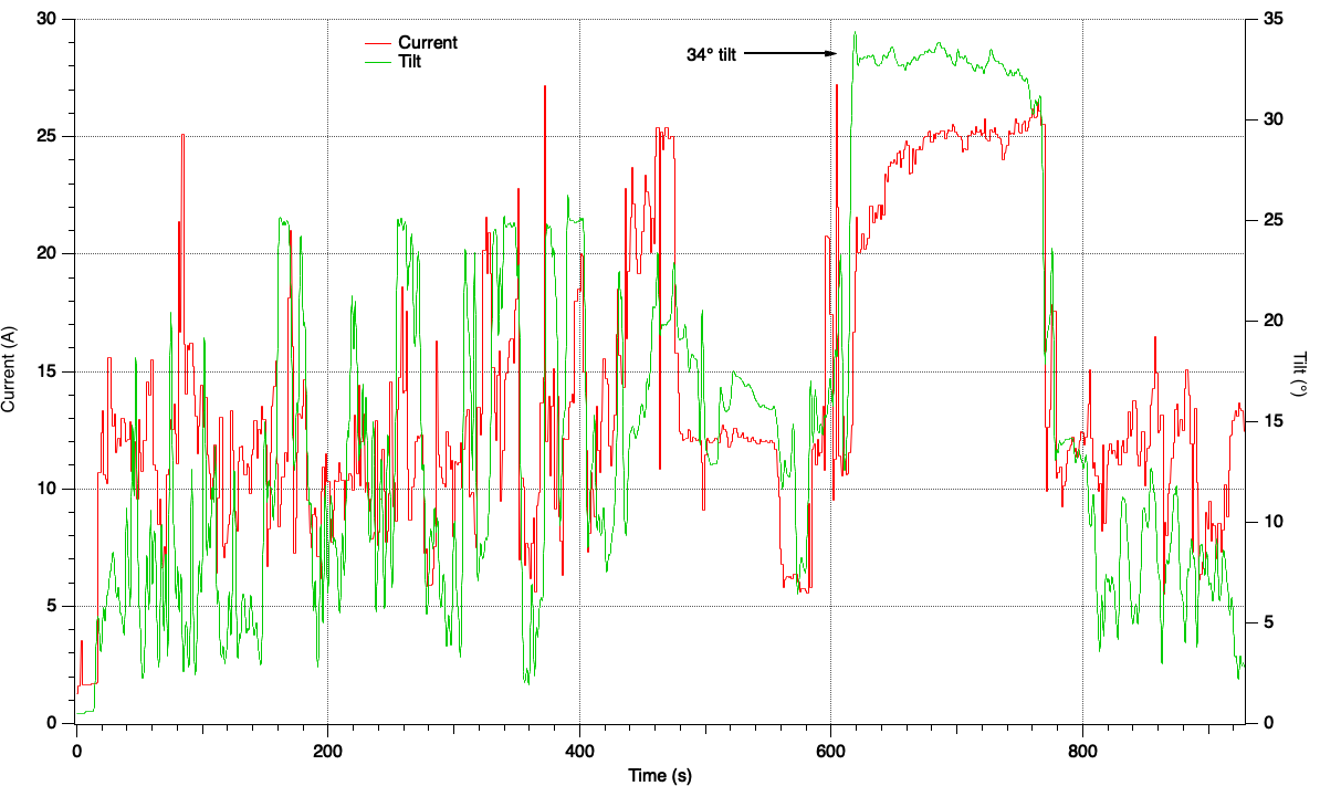

The current draw correlates with tilt, as expected, particularly clearly during the high current draw period on the return:
What is unusual is the tilt angle of 34° in RTH. The specs for the P4A indicate a maximum tilt of 25° in P mode. However, it is rated for 42° in sport mode, and so that current draw should not be a problem. I don't see anything obviously amiss with the battery data, and I'd have to suspect a poor connection (high contact resistance), perhaps due to the battery not being fully inserted.
