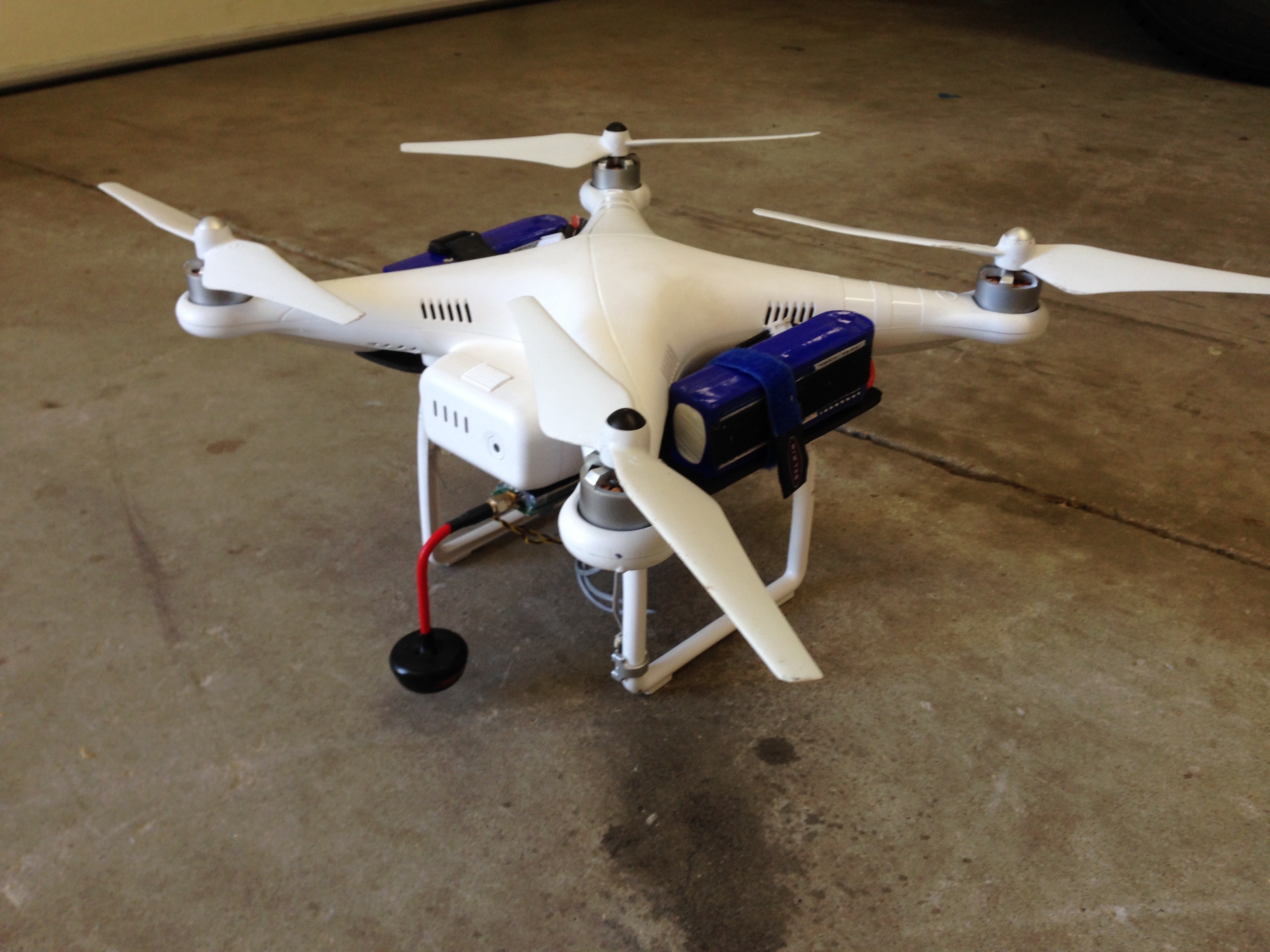

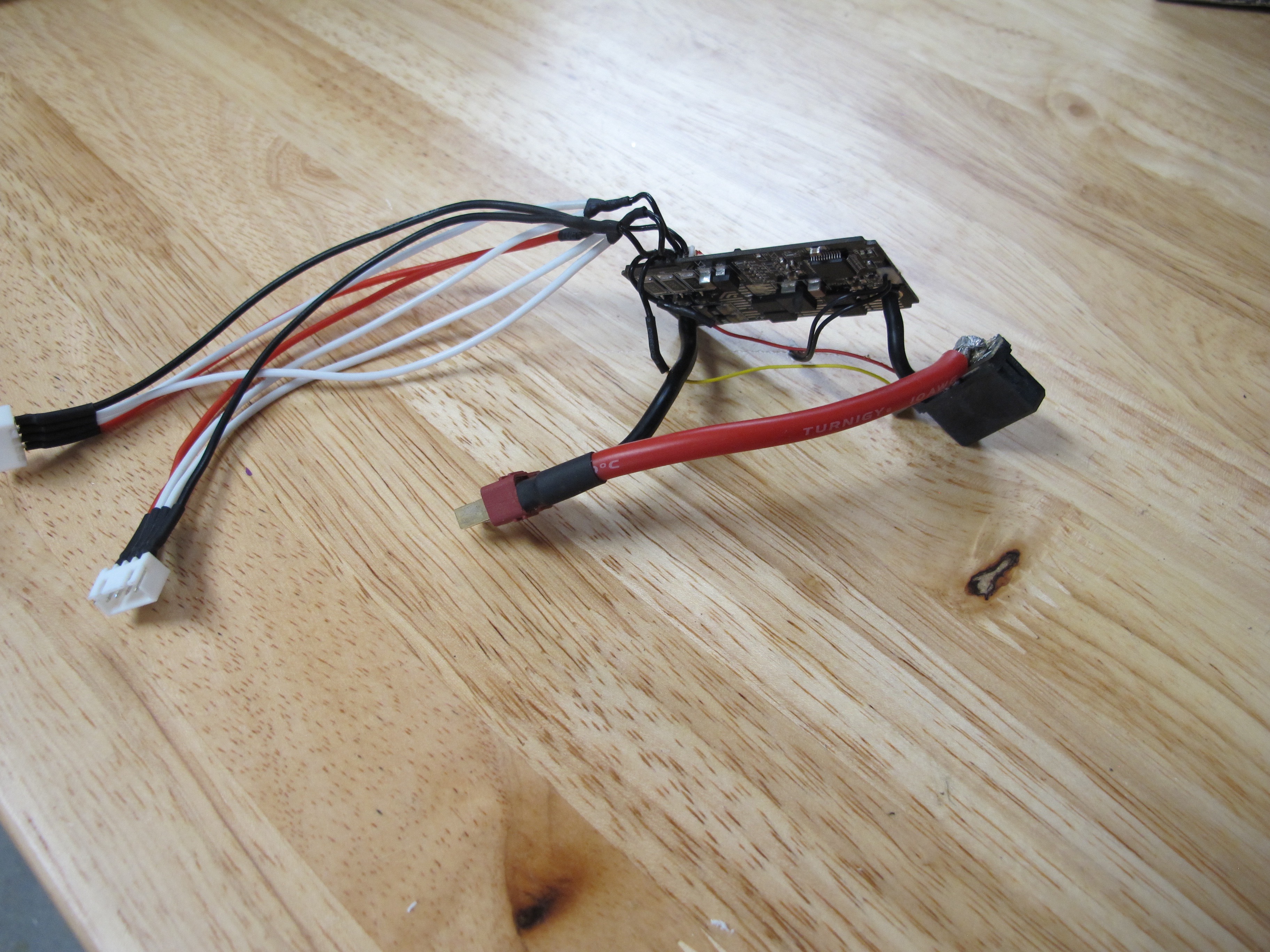

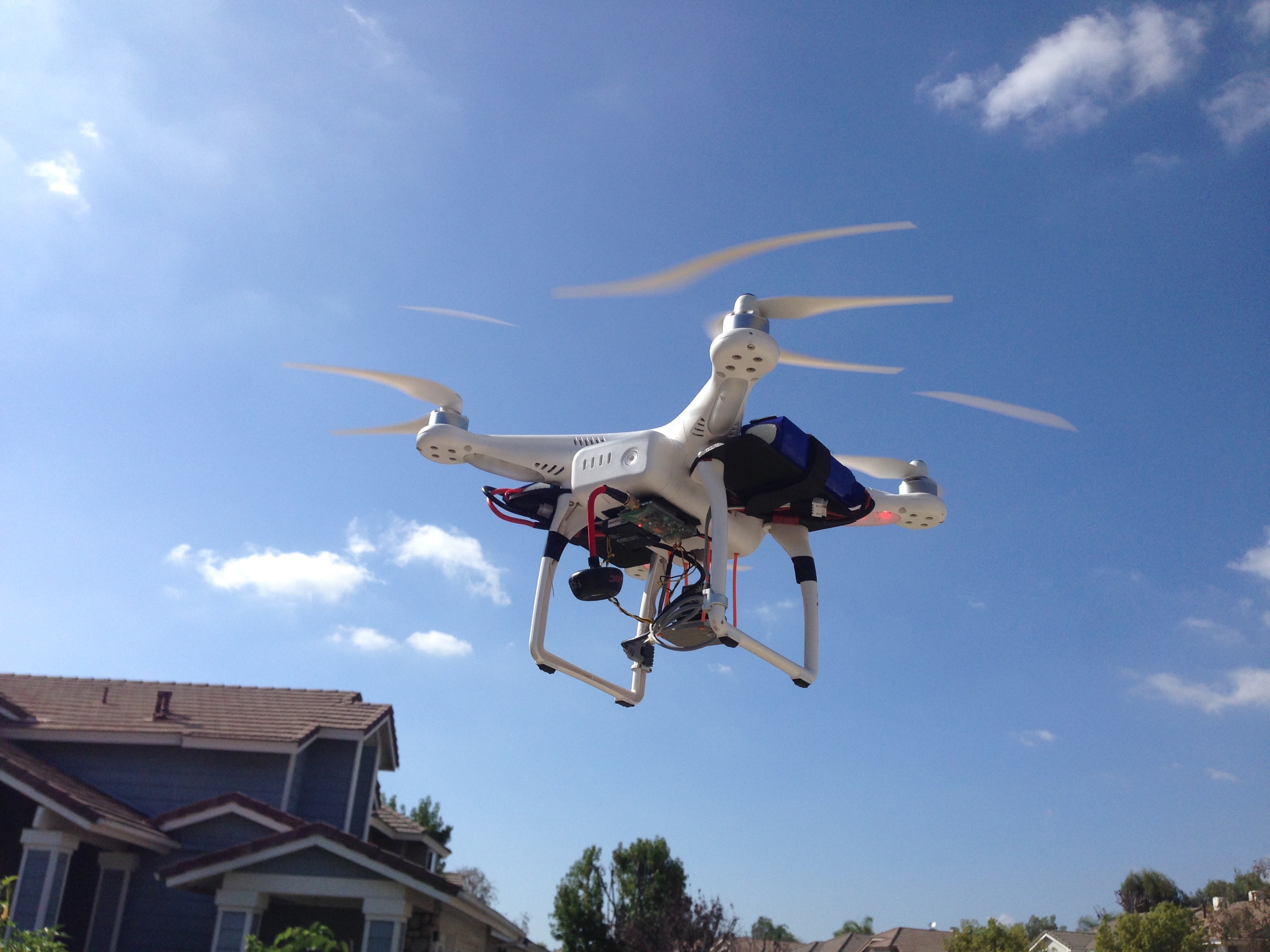

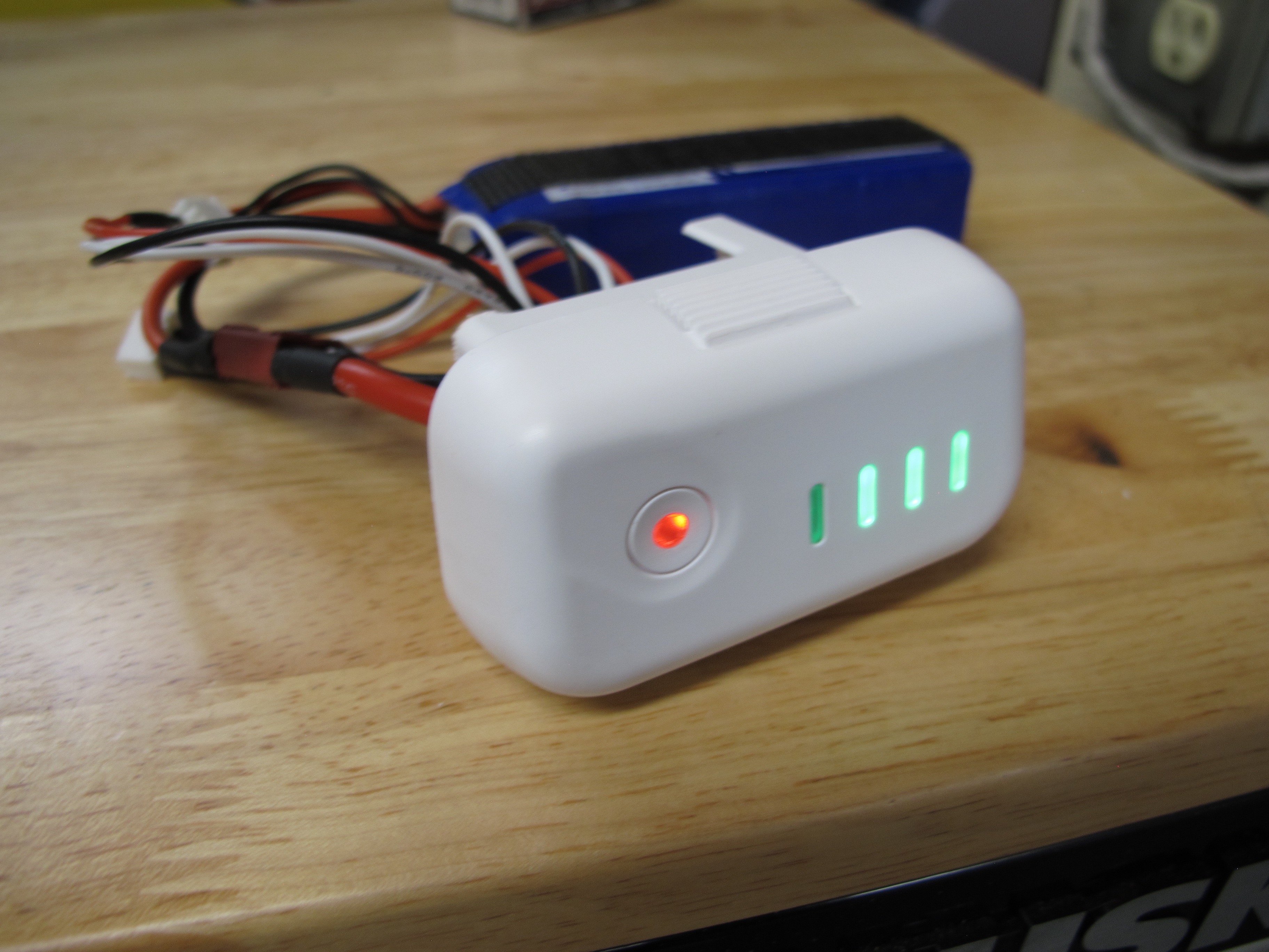

some people have been asking how I did this. These are the only other photos I have; I no longer have the phantom, sold it to a friend and he is still flying it with this mod.
Take the stock battery apart though, disconnect the circuit board attached to the stock batteries and throw it away. Attach dean connector and wires to main circuit board as shown and build a Y connector to hook two batteries into that one dean connector.
You also need two balance cords to solder into the circuit board and those plug into your new lipos during flight.
I hope this helps.

You are tenacious in your quest for an answer.but there are no schematics available for that battery circuit board.
i need schematics how to solder wires and put ordinary lipos to run my ph2 like the creator of this thread who kindly gave photos,but i need the photo of the last side where the wires solder on the board..
