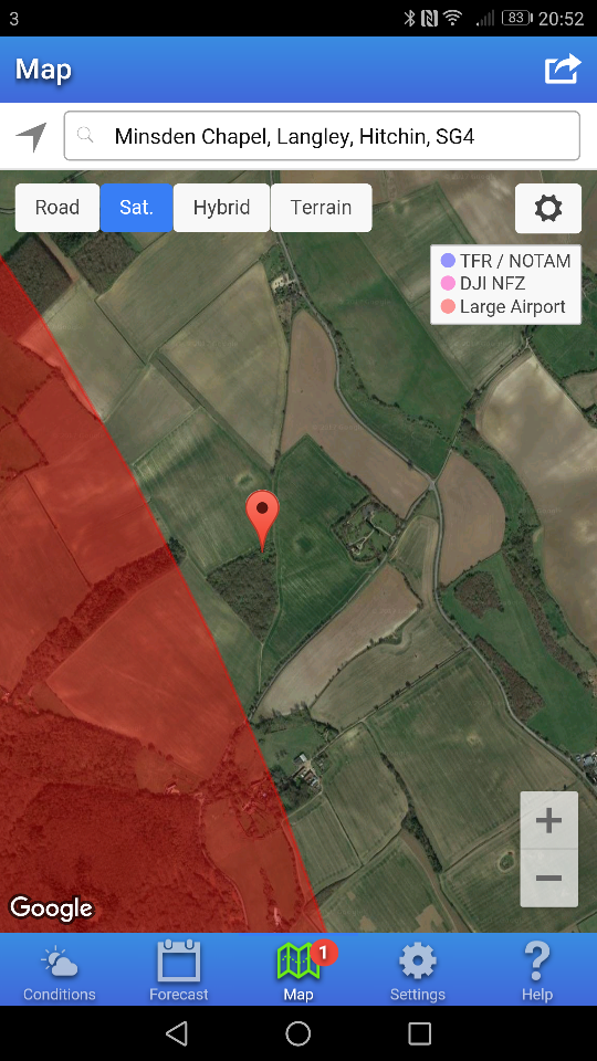

This shows me just outside, so not sure
Look at the chart I posted.......west of the A1 is actually in Luton Control Area....Class D....

Ok I thought you definitely know what you are talking about. I think it's all about safe flight and keeping your altitude low, looking at nats map I can see what you are saying. But obviously not a complete no fly zone to the point at which the P3 will not take off, but an area to be mindful of when flying.
