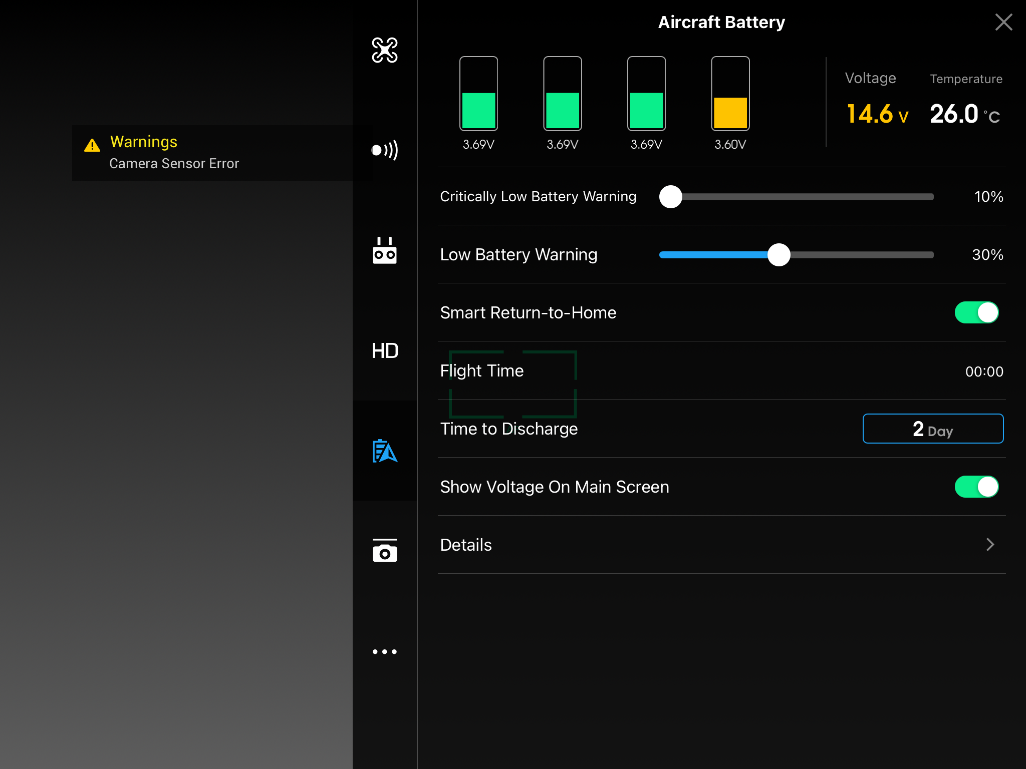

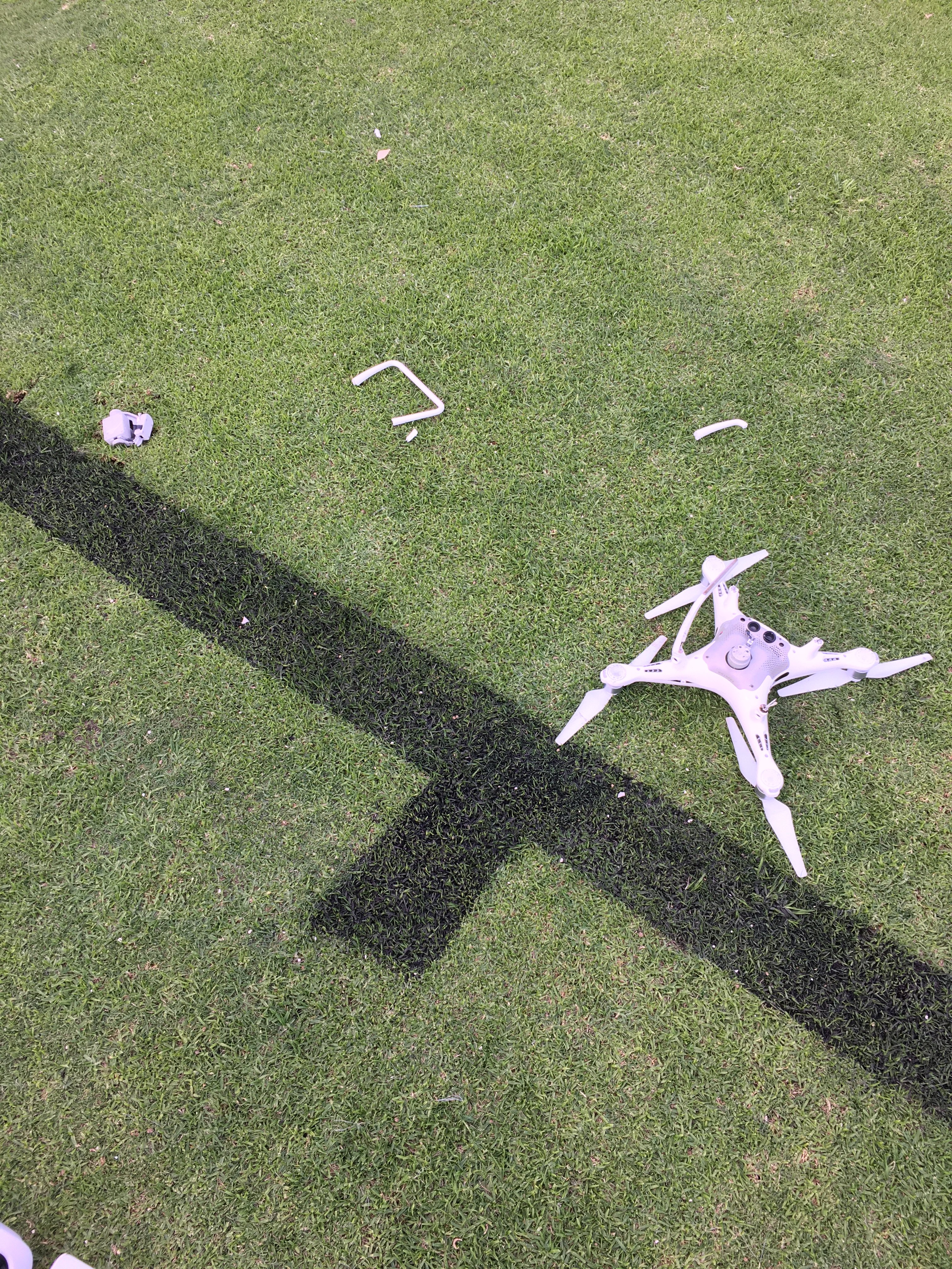

I wish this thread had been a week earlier!! :(( After watching my ac fall out of the sky during it's own induced RTH, the second pic shows a bad cell - could this have been the cause? are these Batteries now repairable or disposable? ie should I send it along with the ac to the repair centre, please?
Oh man feel your pain there,,still under warranty, battery or amount of charges probably expire before the year is up but certainly shows that cell went bad,,,mine were good but had same outcome,,I still have the culprit batt and it still good but wont use it,,ugly outcome,I unsure what say but you be in for new battery if a repair shop does it but dji might cover if drone within that 1 year warranty...mayby it sensed the loss of volt in that cell since it yellow

Nah - batteries are 4 years old and that dud was operating perfectly that flight until it got down to a certain level and instead of landing automatically, it shut down the motors at height.
If it's better to replace the batteries then maybe I should send the remote as well, as it is only charging to 75% ? Or are they a DIY job?
