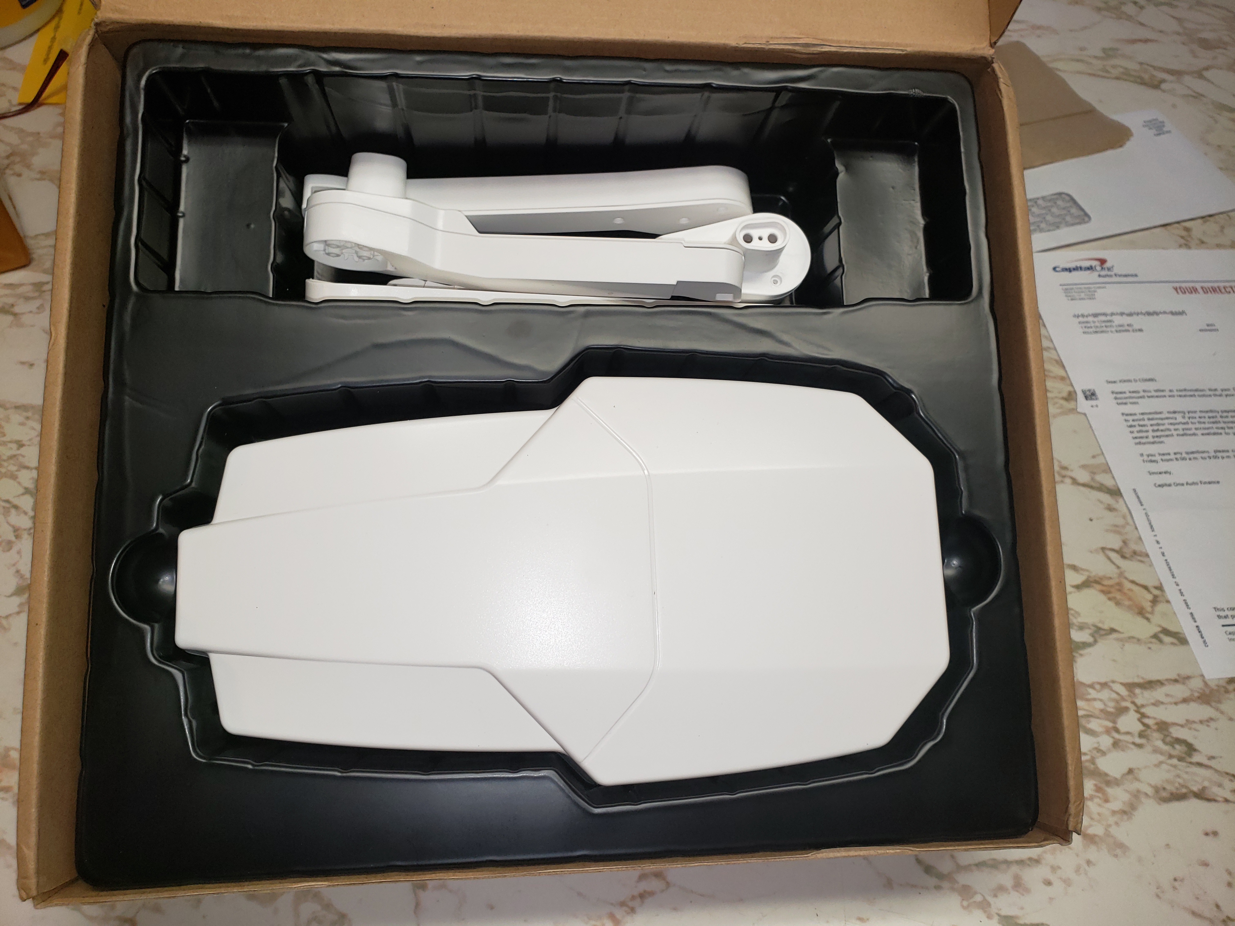

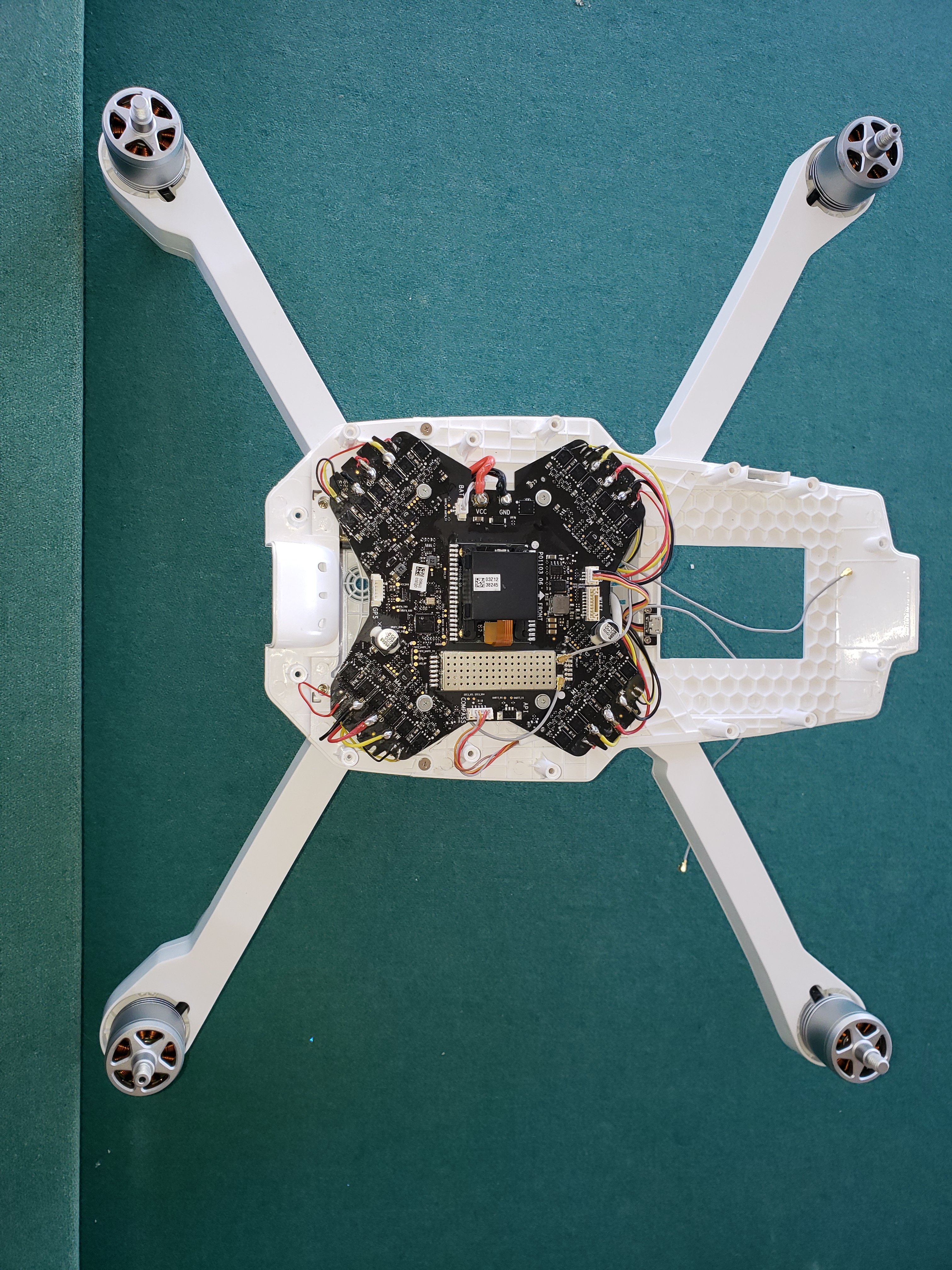

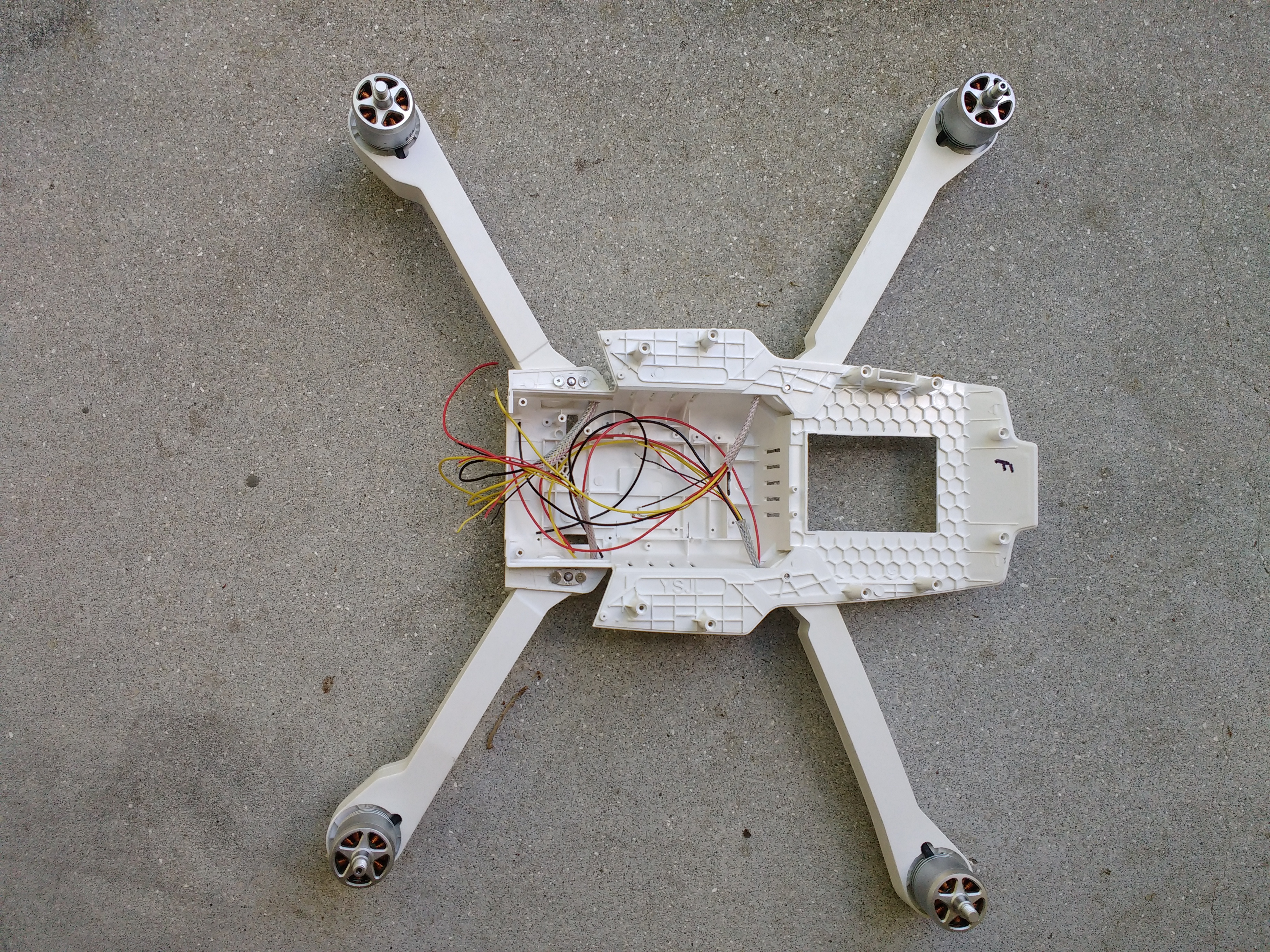

I got my kit Monday and it took me about 4 or 5 hours to assemble. I am having issues with cameras on both of my Phantom 3s (imagine that) so I have parts on order.
A few things I can tell you about using P3S guts in this build is if you use P3A/P antennas you will have to swap the #2 and#3 antennas otherwise the wire from the left rear arm won't reach its connecting point.

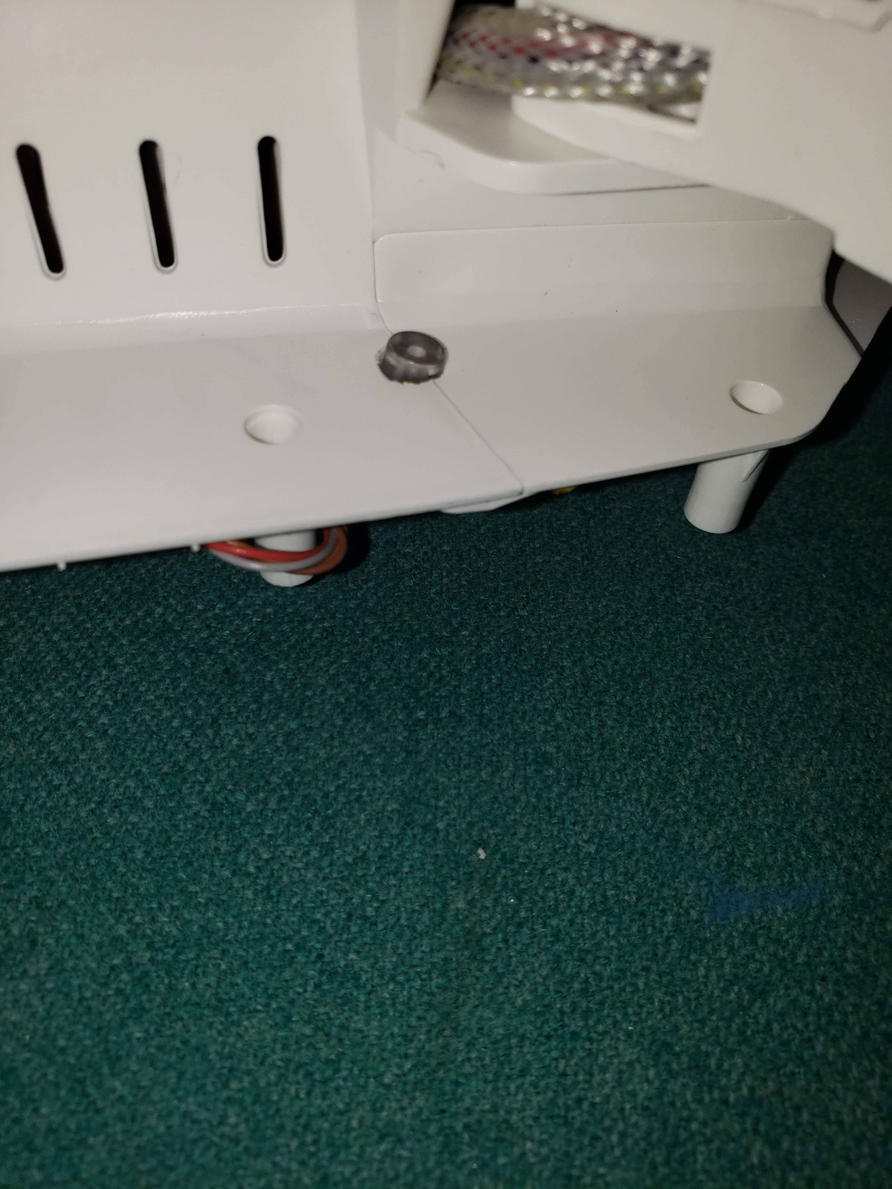

Second, I drilled a hole for the button for binding the RC to the AC and used the original clear button for a more stock look.
And last, it seems the GPS antenna is pressing against the IMU making it a bit of a squeeze to get the top cover screwed on. I hope this will not be an issue but I am considering heating the top cover with a heat gun so it will relieve some of the pressure.
If anyone has some feedback, positive or negative let me hear ya.

Have you drilled any extra holes for cooling? I saw in another thread (and as I suspected earlier in this thread) that this mod does overheat due to lack of cooling during flight. I don't know how much of an issue this would be with P3S guts but I definitely wouldn't trust the P3P gimbal to stay cool inside that shell. See this thread: Modified phanvic kit...
HOLY FREAKIN BALLS! I may drill some holes or cut some slots but that is going a bit overboard and really compromising the ridgidity of the AC. I really don't think a P3S would need THAT much cooling, do you? Right now my biggest problem is the gps antenna pressing against the IMU and a weak yaw motor and gimbal ribbon on my camera. Baby steps.
Ya I agree that was excessive and very likely compromised the structural integrity but that being said, if it was me, I'd definitely add some cooling holes/slots.
Time to tear apart a perfectly good P3S.
Good luck to you mate. I am shelving my project, maybe indefinitely because of camera problems. I have come to the conclusion that the p3s camera is unfixable once it has screwed up on you. I absolutely will not spend any more money on this p3s when I have a p4 that is in perfect shape and in my opinion superior to it. Maybe I'll change my mind after I cool off but until then all things p3s are verboten in my house.
