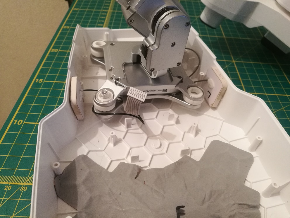

Phavic 90 percent done. All motors work. Test flight tomorrow. Jonnie I see what you said about the GPS hitting the imu. I'll try a heat gun and tighten the screws.

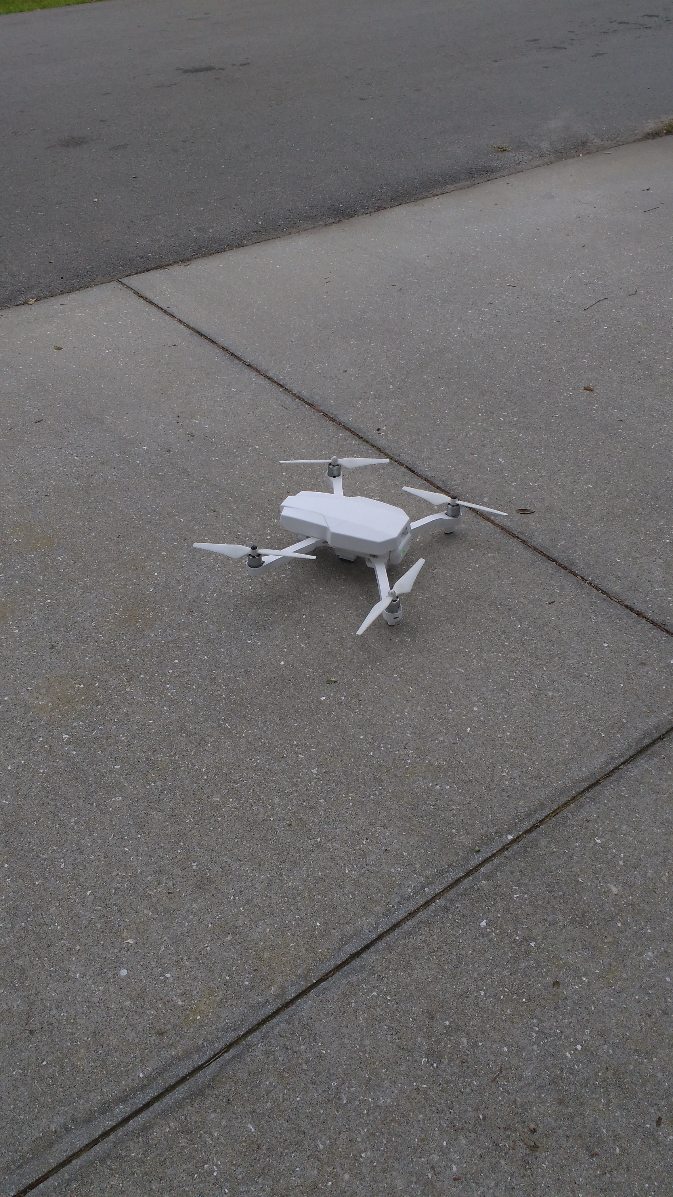

It's alive.....I've done several test hovers. In the yard. All seems to be working fine. Going this weekend for some distance runs.
Reactions: brigerdrones
A couple flights today with the phavic. Max distance 1100 ft, altitude 200, max speed 34mph, with no signal loss. Landed with 53 percent battery because of 130 degree temp. I'm in Florida. Air temp at start was 80 degrees. All is well flights were uneventful. Happy with the build. I might cut some extra holes for cooling but all is good.

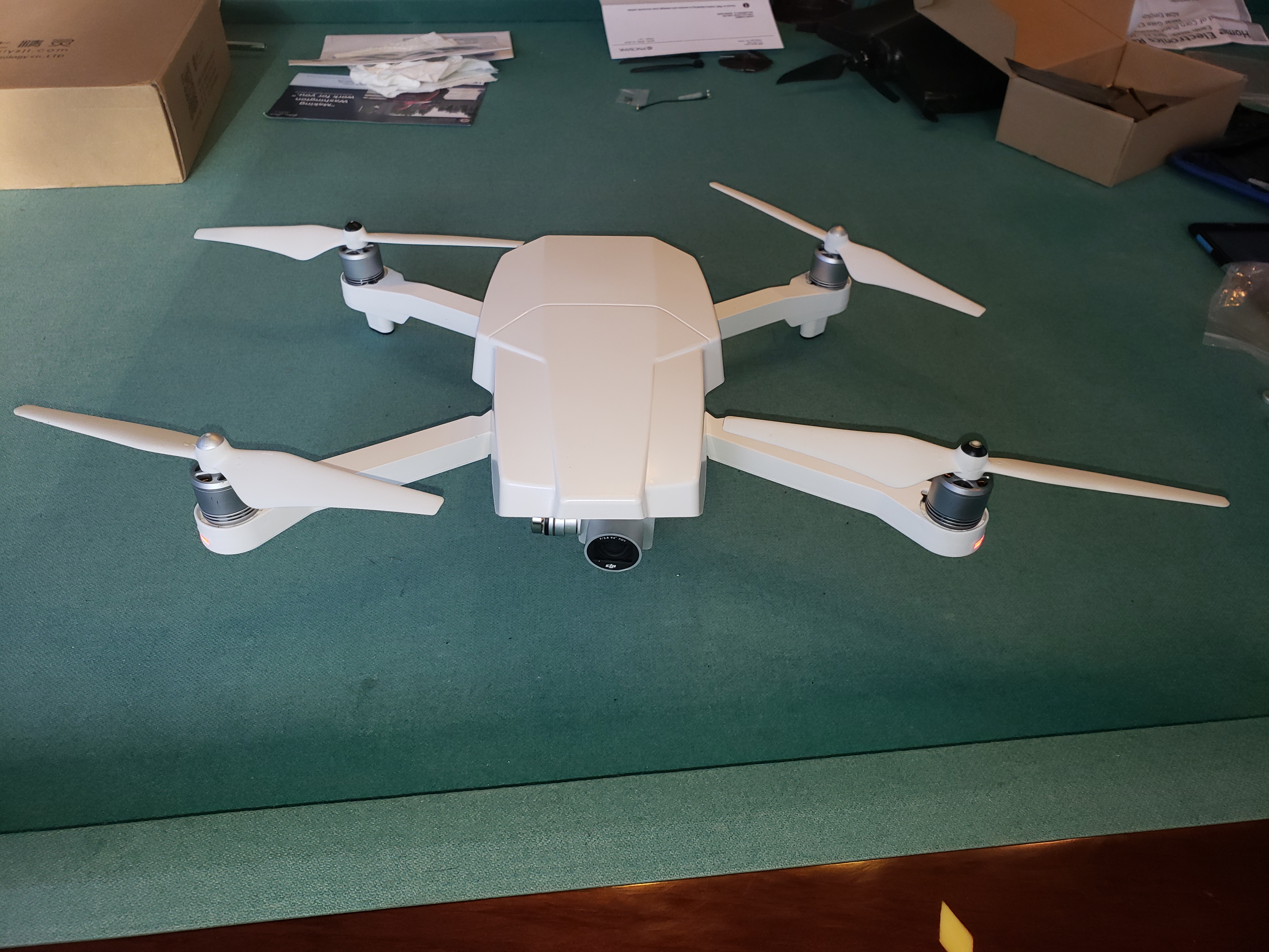

I finally got this d@# thing finished. The camera is fixed and only points to the right about 4 or 5 degrees, I'm done f!@#ing with it. Did a test hover in 45mph winds (don't do that by the way) and it did as well as could be expected (I didn't crash it) and I'll try to post first flight results when this wind lays down.

Have you drilled any extra holes for cooling? I saw in another thread (and as I suspected earlier in this thread) that this mod does overheat due to lack of cooling during flight. I don't know how much of an issue this would be with P3S guts but I definitely wouldn't trust the P3P gimbal to stay cool inside that shell. See this thread: Modified phanvic kit...
I did the drilling of lots of holes to make it lighter, more cooling and to make it faster as it carries less wait. Now weights
I did the drilling of lots of holes to make it lighter, more cooling and to make it faster as it carries less wait. Now weights 1245g including a shark tail that I put on top and modded navigation lights. My Phanvic modded build
