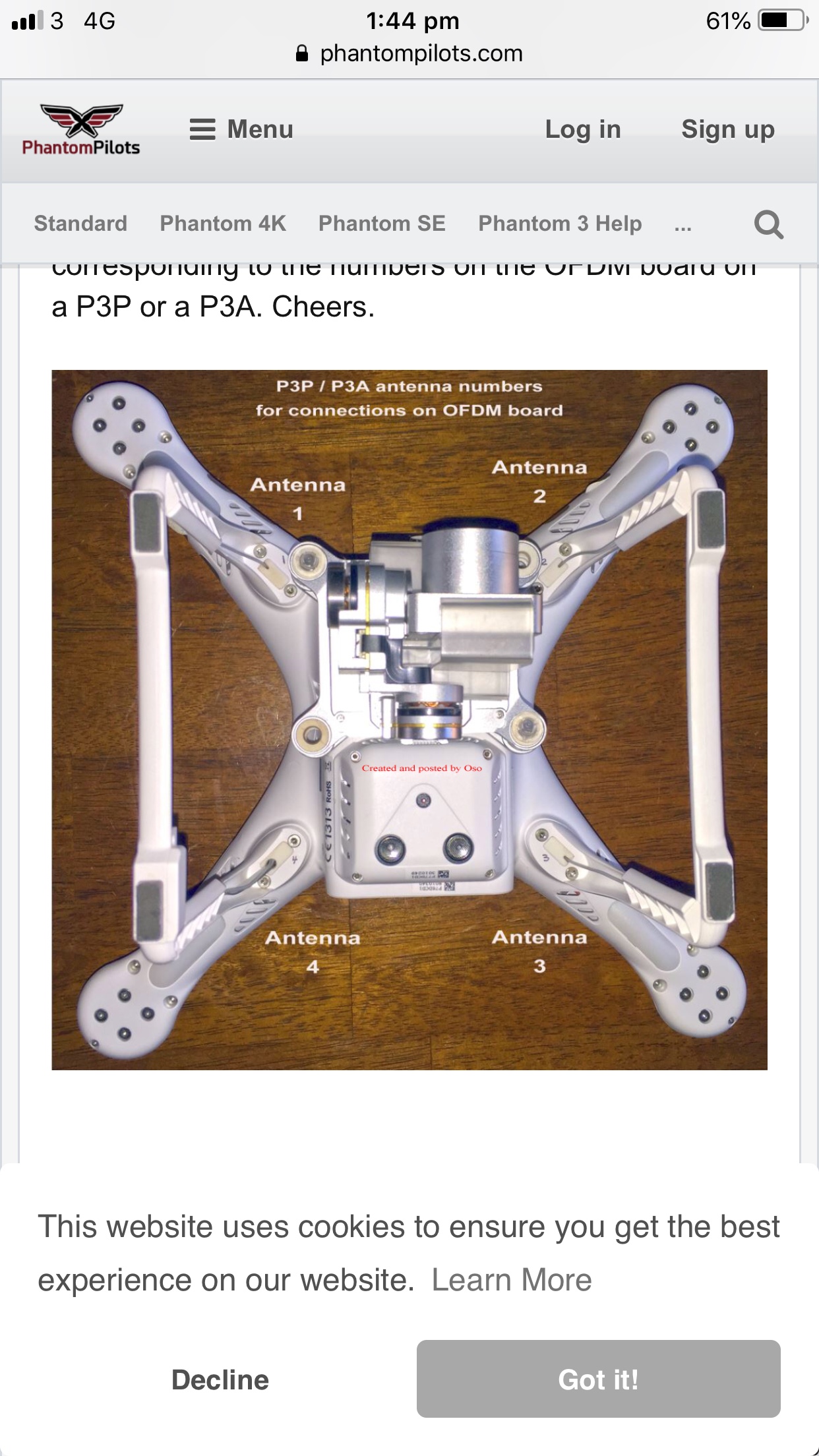

I could be reading this wrong but I have those antennas installed on my P3S and get great video up to 2 miles out using the DBS. Glitchy, but solid picture.
Hard to get a picture of but you can see one antenna in the background of the first picture.
They work.
So if this is witch way on the legs what way inside of the bird would thay go please
