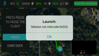

Hey Justin. What do you make of this error?
I searched a little but I didn't go through all 400+ posts.
What info do you need?
iPhone 5s
Beautiful day
No other apps running
FW 1.3.2
Interesting.
Thanks!
iPhone 5s
Beautiful day
FW 1.3.2
Interesting.
Thanks!
You are getting that error because your firmware is 1.3.2 you need at least 1.4 to use the waypoint features of the drone. Once you upgrade your firmware you should be good to go. Thanks!
