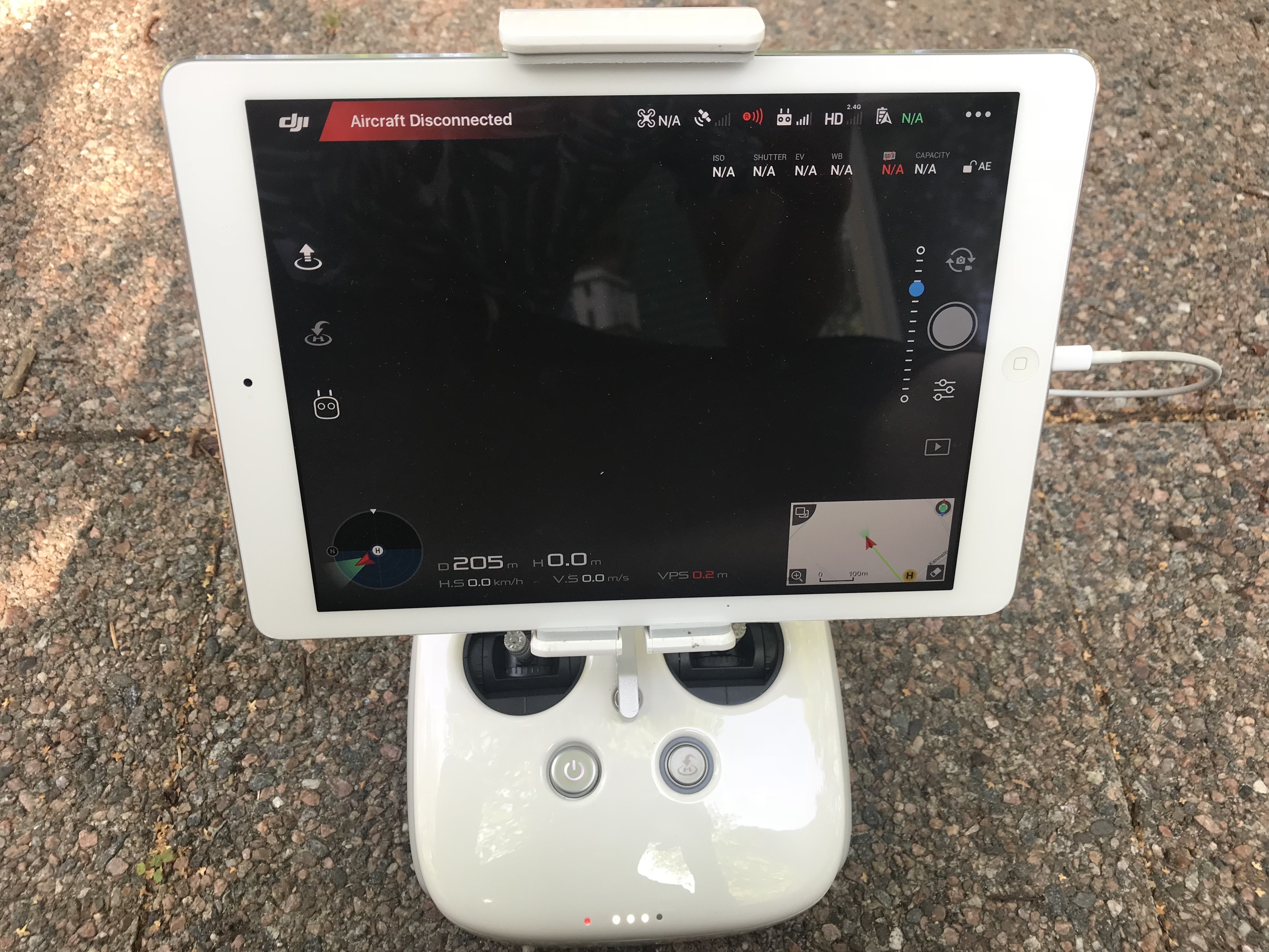

Today I did a range test without props again. There was only 205m (672ft) between me and the drone when the led turned red and "Aircraft Disconnected" appeared. I have flown RC planes for 10 years and 206m RC range feels a really short distance to lose RC although the drone wasn't LOS at the moment.
I think it's weird that the app shows that there is RC connection, but the led is red... What do you think? (in the below picture)

Is your transceiver wifi set to 1 channel instead of auto? Is your video link set to high quality instead of auto? Are your transceiver antennas pointing at the aircraft instead of being perpendicular?
Actually for some reason I can't change channel mode from Auto to Custom in the HD menu.
Antennas are pointing at the AC like the manual advises.

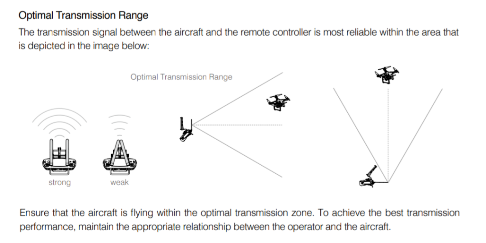

They shouldn't be pointing at the drone really, I've attached an image just incase we're not on the same page.
