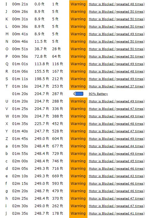

I recently used Air Data for the first time on my P3P. I uploaded the last flight log and to my surprise it is showing repeated "motor is blocked" warnings through out the entire flight. All other shown log data (battery, GPS, compass, etc.) are normal.

The "motor is blocked" notifications appear through the entire flight:

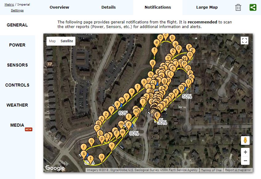

And here is some of the log:

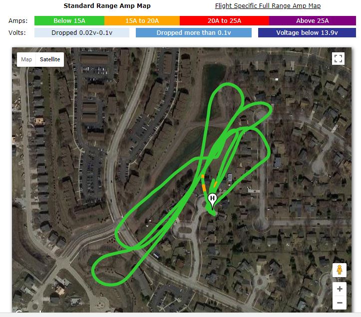

I checked the Volts and Amps screen and amperage is mostly low and normal:
