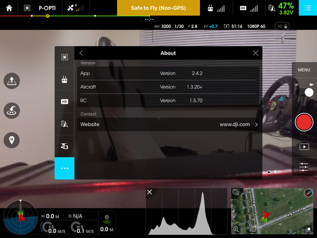

1. Place the .bin file on a freshly formatted SD card (formatted from Windows, not the pilot app)
2. Put the SD card in the Phantom and power up. You will hear D -- D -- D -- D beeps for a couple of minutes. When you hear 1 long beep followed by 2 short beeps DD -- D -- D, it's ok to turn off the Phantom.
3. Format the SD card again and put the 1.1.9 .bin file on the card and put that into the Phantom.
4. Power on and listen to the beeps again in the same way.
Once done you can check to ensure you are on 1.1.9 in the pilot app under the About section. Be sure to calibrate the IMU and go through the checks as you normally would for any firmware update.
Now what is the procedure to use this file for the remote? Im thinking the remote fw seems to be where the issue lies with 1.5 and 1.4.
I dont think I have heard of any confirmed cases where someone was able to downgrade the FW on their RC. Have you heard of any?
I'm pretty sure the restrictions are being held in place due to the rc firmware and DJI Go. I have a feeling this this is why DJI elected to have their app take over the updating process. I could be wrong, but who ever can get the rc downgraded will have this beat.
Even if we are able to get the bird downgraded to the earliest versions, without downgrading the RC, I think we will be stuck.

You are really lucky. To SW developer point of view, they always think of an UPGRADE and no DOWNGRADE FW available. Based on my experience there is always trouble if you downgrade your FW form Upgraded version (not on our DJI though..)
Why i am asking - because since 1.4 the added additinoal NFZ's. 1.3.20 seems to be most reasonable f/w.
