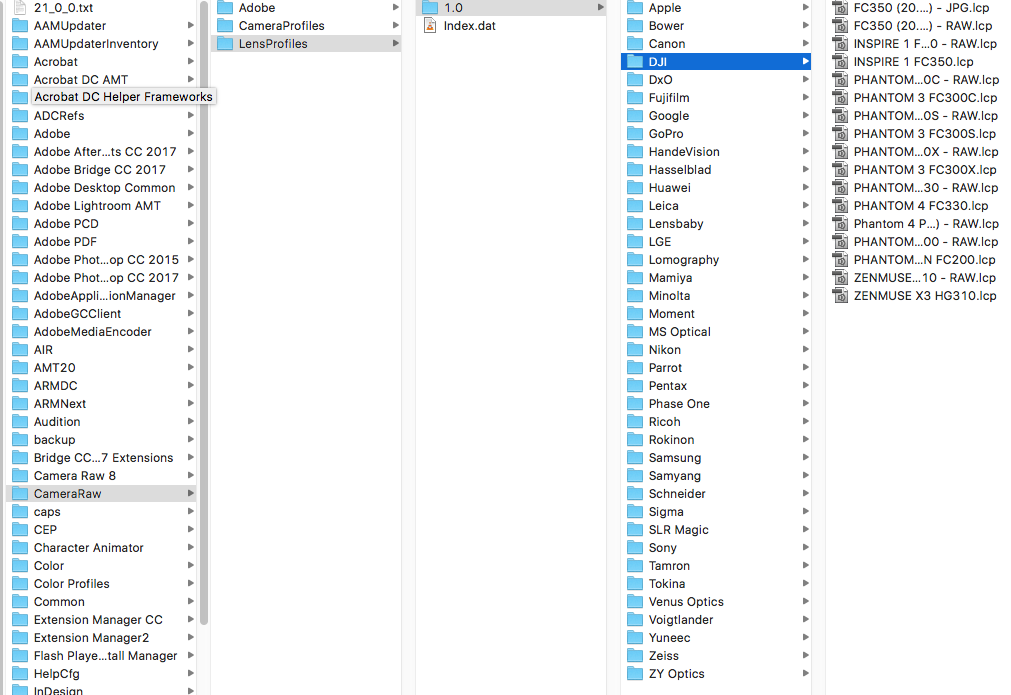

Luigi, for the MAC put the lcp file in the following folders
/Users/(User Name)/Library/Application Support/Adobe/CameraRaw/LensProfiles/1.0
Let me know if this works for you
Thanks
Now it works

Managed to get it downloaded and as a .lcp
Have placed it in /Users/(User Name)/Library/Application Support/Adobe/CameraRaw/LensProfiles/1.0
Still not popping up though in Camera Raw

Try putting the file in the other folder as well.

Placing the LCP File In the CameraRaw\LensProfiles\1.0 Folder
1. If you’ve saved or have LCP files located in a non-default path, they must be placed in the correct location for use in Adobe Photoshop. Copy or move the LCP to one of the user specific or shared lens profiles folders, or any of their sub-folders, depending on the operating system:
a. For Windows XP:
C:\Documents and Settings\(User Name)\Application Data\Adobe\CameraRaw\LensProfiles\1.0
C:\Documents and Settings\All Users\Application Data\Adobe\CameraRaw\LensProfiles\1.0
b. For Windows Vista or Windows 7,8 or 10
C:\Users\(User Name)\AppData\Roaming\Adobe\CameraRaw\LensProfiles\1.0
C:\ProgramData\Adobe\CameraRaw\LensProfiles\1.0
c. For Mac:
Just in case the file you downloaded is corrupted I have put the file in dropbox, link below
Dropbox - Phantom 4 Pro FC6310 (24.0 mm) - RAW.lcp
a. For Windows XP:
c. For Mac:
