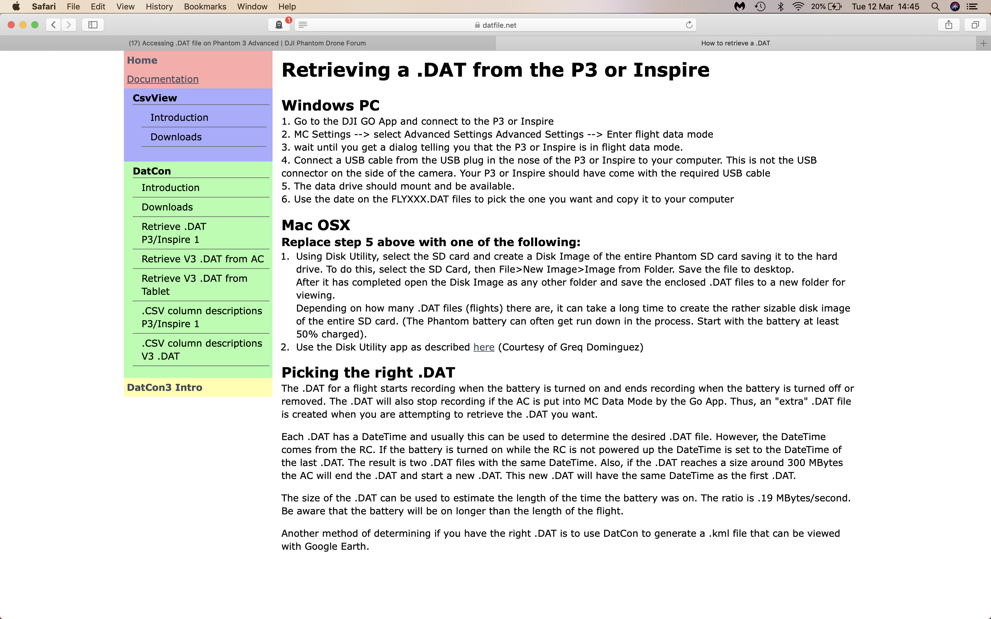

Reading several "how to's" on the net I have downloaded GJI Assistant v2.0.6 onto my MacBook Pro but cannot get it to connect to the P3.
I have plugged the cable into the drone front socket and the USB into my MBP, turned on the drone (100% battery) all the lights flashing, and then opened Assist 2 but nothing happens, no sign it has recognised the drone.
You don't have to have the RC on do you??
I have also tried the app other method via the RC, access data etc, but that also didn't do anything other than to advise that I had successfully entered data mode, no sign of the connection, even in the Disk Utility. When the notice appears "you have successfully entered Flight Data Mode" the green flashing LED;'s at the back of the drone go off, but that's it!
Any help would be appreciated......
