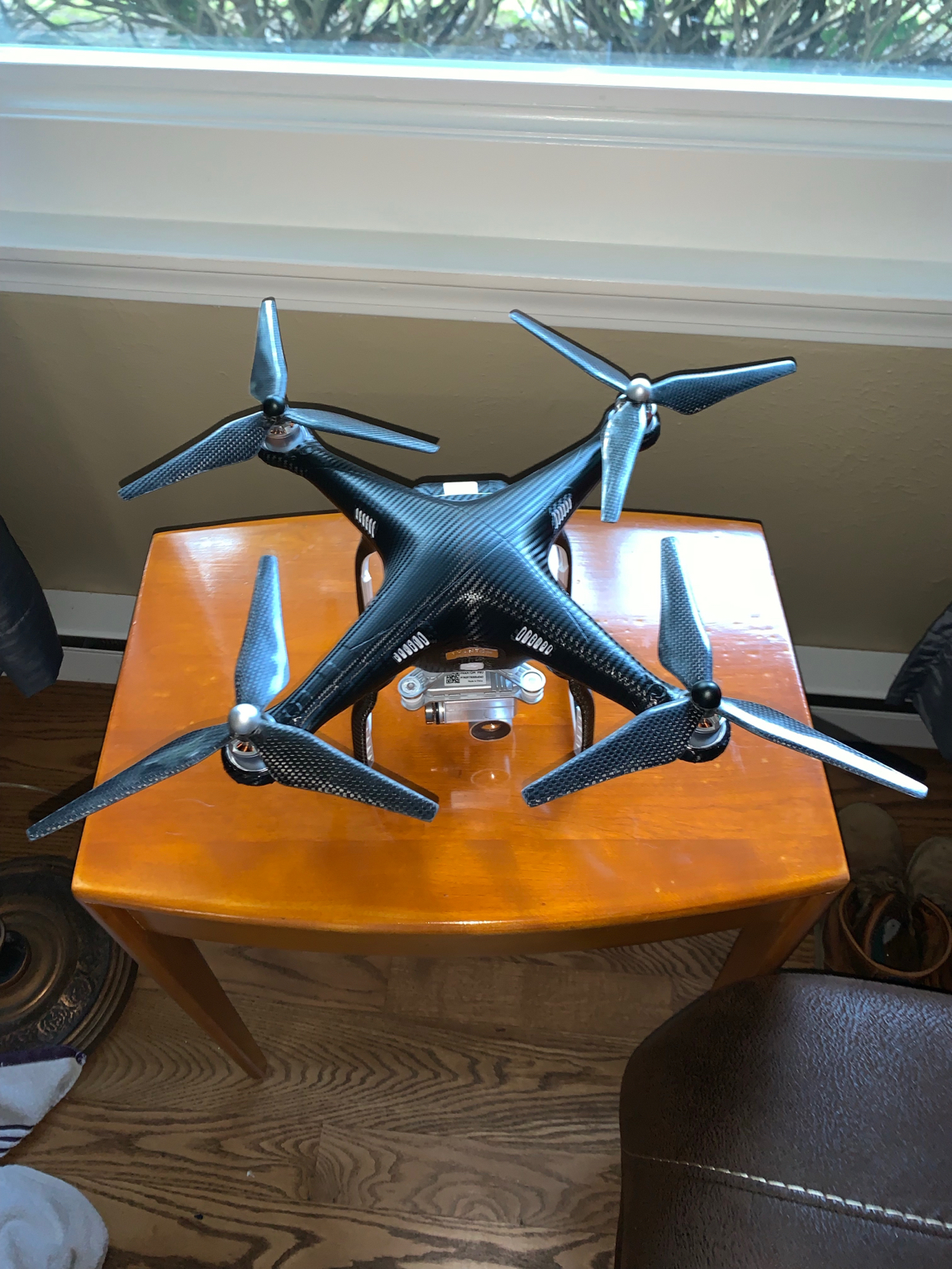

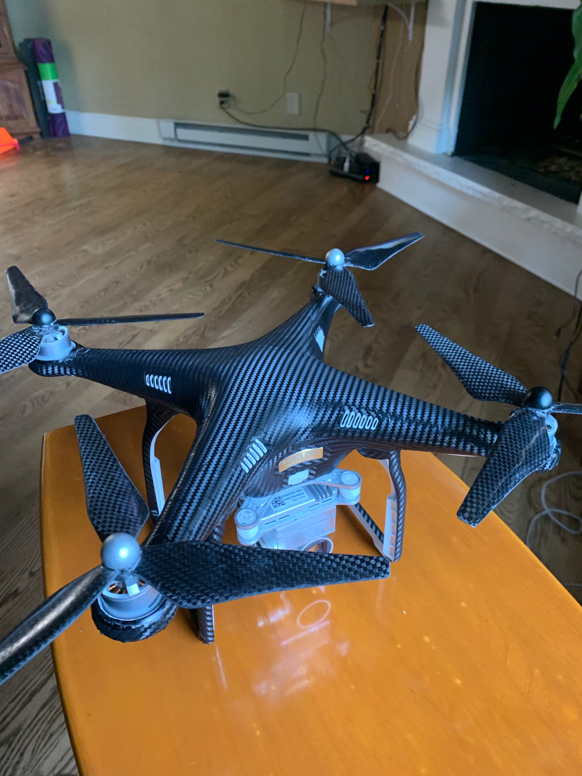

Ok this my obsidian p3s lol
Posted this while back but still looks the same..have had this drone 2016 but had no crashs to date,,just lightly sand body with some dry paper,I used 320 grit,,not wet and dry or surface to smooth and paint wont stick well,,,I do regret using gloss black cause fingerprints but it easy to clean and not scratched,gave it dust coat and let dry then 2 nice wet coats and let it dry,,I took gimble of cause saved masking it up and better finish.. no issues with GPS or compass..certainly helps with visibility
Reactions: Kirby Johnson
Posted this while back but still looks the same..have had this drone 2016 but had no crashs to date,,just lightly sand body with some dry paper,I used 320 grit,,not wet and dry or surface to smooth and paint wont stick well,,,I do regret using gloss black cause fingerprints but it easy to clean and not scratched,gave it dust coat and let dry then 2 nice wet coats and let it dry,,I took gimble of cause saved masking it up and better finish.. no issues with GPS or compass..certainly helps with visibility View attachment 114772
WOW. A rattle can Picasso. Nice work. Rustoleum is the way to go. I use it on my motorcycle fairing and no problems.

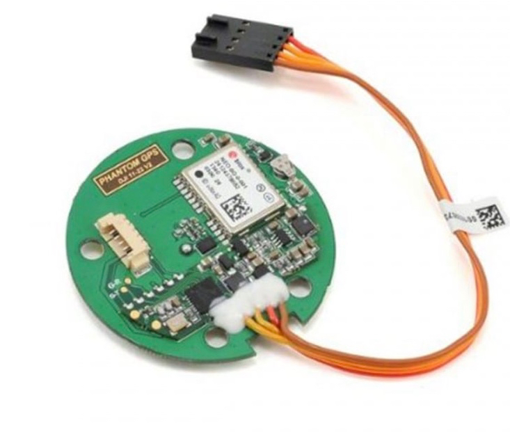

Yes I would recommend taking the whole thing apart and only spraying the shell and the landing gear with no components on it whatsoever.anyway this is a little off topic but pertains to your comment about the GPS module if a drone had a crash and landed on the top of its shell where the GPS module is located but there was no visible damage to the module but the shell was cracked...could it still be messed up enough causing the drone to not want to fly My wire did get a little bent and I'm not sure if it lined backup properly but the 10 pin cable could be replaced and that could be the issue. But its an old aee ap9 and it just beeps when I start it up after the crash the only other option is a bad battery maybe.. i guss ill have to order a gps module
The GPS "module" is just a circuit board attached to the top shell by four screws. If the shell was cracked across its location it is very possible that the circuit board also got damaged. Open it up (not difficult) and have a look with a magnifying glass, see if you cane see any cracks. You're going to have to open it up to change the module any way so have a close look!!
The GPS "module" is just a circuit board attached to the top shell by four screws. If the shell was cracked across its location it is very possible that the circuit board also got damaged. Open it up (not difficult) and have a look with a magnifying glass, see if you cane see any cracks. You're going to have to open it up to change the module any way so have a close look!!View attachment 114777
she is already torn apart.. lol I don't see anything visibly wrong but I did not inspect it with a magnifying glass.so I will try that but like I said I think the ribbon the connector, the pins got a little bent and if I replaced that it might work it definitely got banged up a little bit
