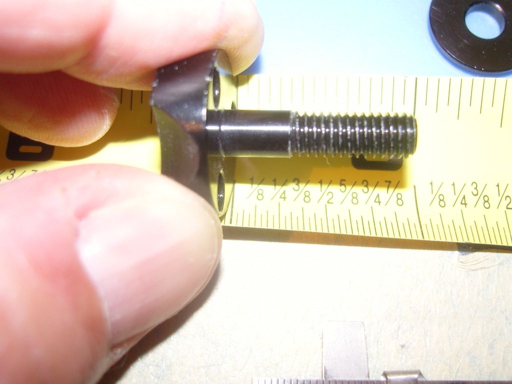

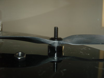

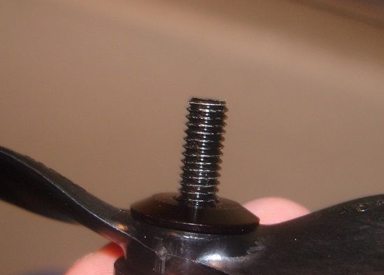

I have T-motors. The prop shafts are threaded except for the last 3/8". Props are 3/8" thick-so as measured with the washer in place, that leaves me exactly 1 thread with which to tighten the props. I have all 6 engines as self-tightening.
Sooooo....put the Gemfans on and ran them at idle-makes lots of wind, cool. However, after a few starts and stops, I hand checked the props-and each one could be easily moved on the shaft. I had tightened each props with a wrench-about 1 turn, I'm guessing. You can see on the prop shaft the point at where the nut galled the non-threaded shaft-so it's not like I could have gotten them any tighter.
So, I have a problem. I'm using the washer, on top of the prop.
I checked T-motors website, and they have a "short shaft" prop adapter that is threaded all the way to the base. But-get this....the total length is 12mm, and, the total length of the prop, washer and nut, is 15mm....!!!!!
So-anyone run T-motors? Anyone have these M6 shafts that have 3/8" of no thread How can I solve this problem?
If the hub of the prop compresses just 2mm, I'm outta threads. Basically-I don't feel I have enough threads to get the props tight. I don't have the adapters for the E-Graup props yet-but the hub is identical to the Gemfan at 1/4"-and also leave exactly 1 thread\ to tighten.
There is no other shafts from T-motors....the short one is too short.
Also-I can't use Nylock nuts, because 3 of the shafts are reversed threads-and I can't find reversed thread nylocks on this Planet.

Something about that still isn't adding up to me. In the picture below, the threads look like they go all the way down to the top of the washer, and the nut sitting there should thread all the way down to that. Can you take a pic of where the nut is running out of thread?

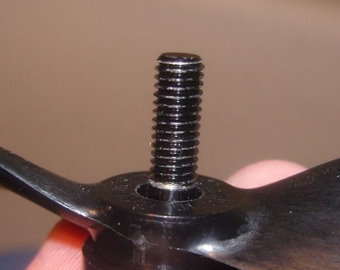

Just measured again-and I was wrong-the thread start at 3/8th of an inch!! That precisely where the top of the washer sits on top of the prop.
I measure the old smaller 4mm prop adapter, and it's 10mm, so a bit less than 1/4 of an inch.
That give me only 1 turn of the nut(fine thread) until I'm out of threads.
In that picture above-the thread start exactly at the top of the washer......
I've got to be missing something here. I've checked other motors online-and they all appear to have roughly 3/8" space with no threads....that's on the 28 and 32 series engines. On the smaller engines the thread start sooner.
I've measures with a depth gauge 3 times now........I know that 1 thread isn't enough.
Can you measure the non-threaded portion of your prop shaft? It should be almost exactly 3/8 of an inch.......

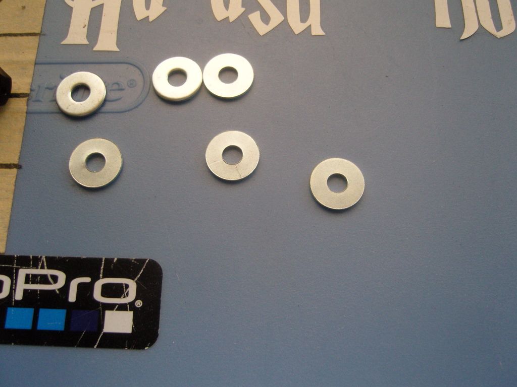

Anyone see an issue with me running with another M6 washer on top of the black washer, and using a drop of blue loctite?
I just don't trust these prop adapters-and I need more threads; that's the only solution I've come up with.
Also-T-motors makes a "short prop" adapter that's threaded all the way down. However, in searching the entire internet, I only found 1 place that gave what looks like the length of the shaft-12mm. Prop+washer+nut=15mm!!!
So-off to the hardware store for washers.
This kinda pisses me off. I spent the extra money to get 3 self-tightening prop adapters, just so I would have the piece of mind knowing a nut wouldn't back off and would actually tighten. But, if you're already out of threads, and it's still not "tight"....it's gonna cause a crash. I'm not taking that chance.
I went to the hardware store and got 6 big flat M6 washers. I'll put 1 between the prop and the black washer, drop of blue loctite, and see how she's flies.

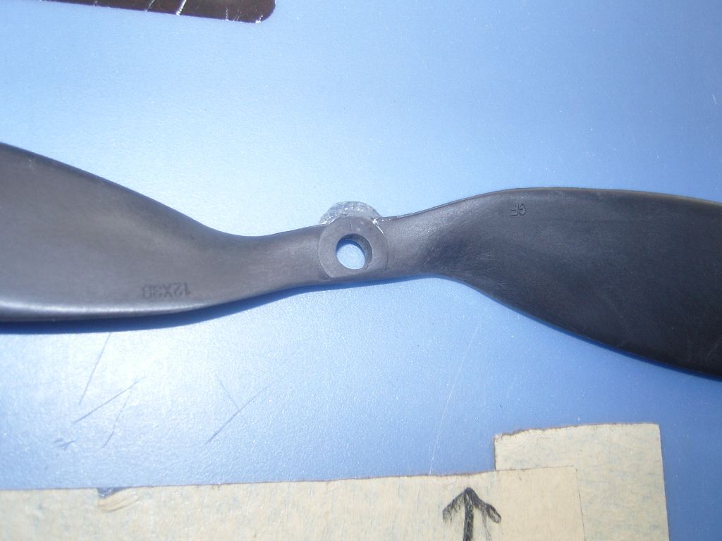

But, on the prop end-there's a problem. How do you know when you just won't get a prop hub to balance?
When you get to this point-notice the large amount of CA on one side, and the lack of material remaining on the heavy side;
That is a prop that is going to be returned for replacement. It'd done!! Spent 2 hours on that 1 prop. Have 2 more that are pretty much just like it. Going to work a bit more on the other 2...but, I think all 3 CCW blades have hubs that are just too far out of balance.

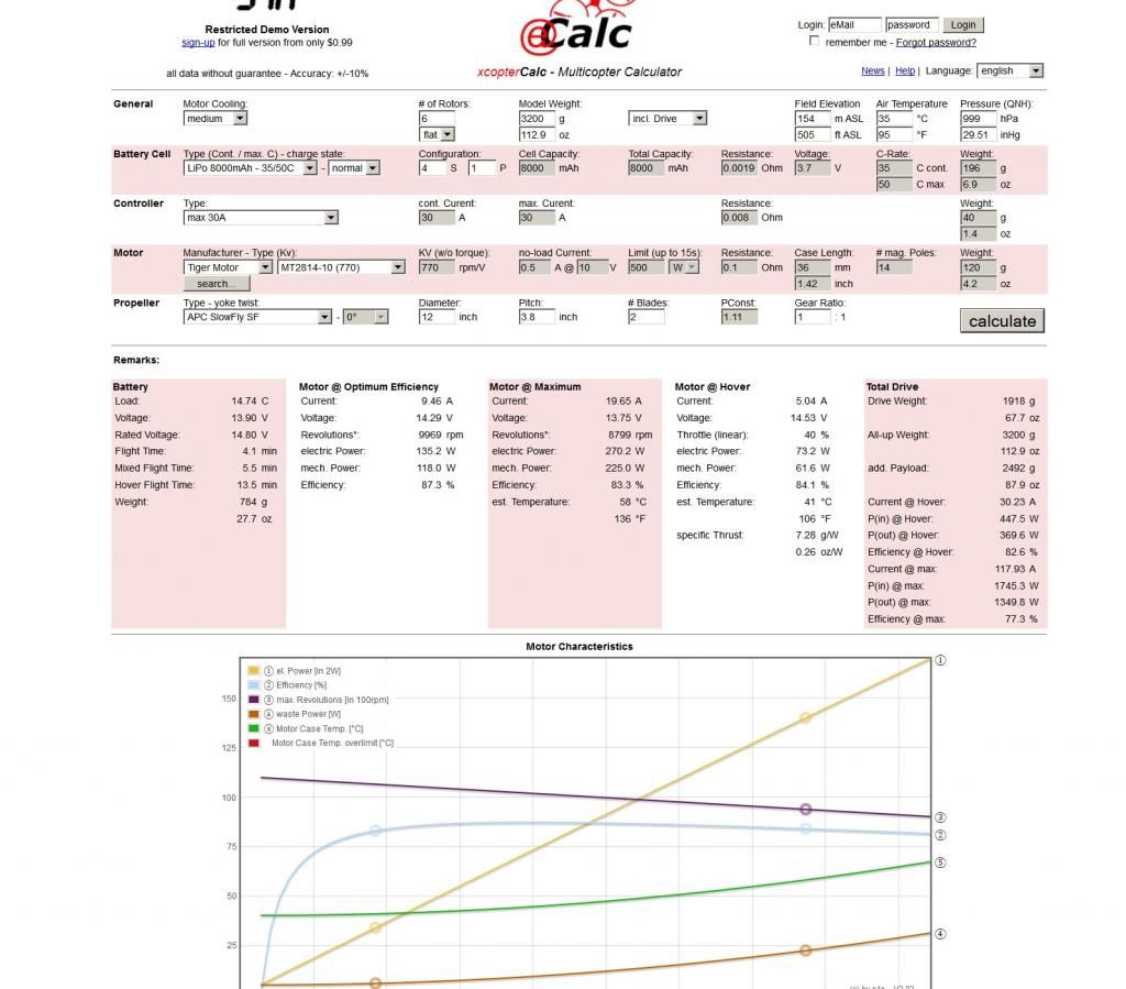

Here are the E-calc screen shots with my engines and battery-at AUW of 3200 grams;
11X5 E-graups;
12X3.8's
So you can see there is about 1gr/watt improvement when using the 12" props. Not sure how that will translate into flight time.

I messaged Readymade, and they're going to look into the batch they have now. If you look at my picture above-you can see how much material is at the top and bottom of the hole, and it's still heavy where there is almost no material-that tells me the hole is cast in the wrong spot.
Excellent! I got mine from them a few weeks ago so they might be from the same batch, I'll zip them a message today. Which one of them was it that replied to you?
Mine look pretty much like yours in the pic there, a lot of weight added to one side and a lot taken off the other, and still the hub is unbalanced. I took more material off the thick section on either side of the hub center (as I think that's where the issue is) rather than the round part itself, but still no joy.
I really wanted to try these because of the 3.8 pitch and because I love the carbon-nylon blend material they use.
OI Photography said:
I opened a "ticket" in the support section...just filled out the form, and got a response about an hour later. I have no doubt now they have a bad batch.
Are the ones you can't balance CCW by any chance?
The 3 CW one's were pretty easy....one with just a piece of tape, but 2 required a bit of CA, tape, and sanding.
I to love the combination of materials....and how strong they feel, compared to say the APC's. But, OMG...trying to find 6 that will balance may prove a daunting challenge.
